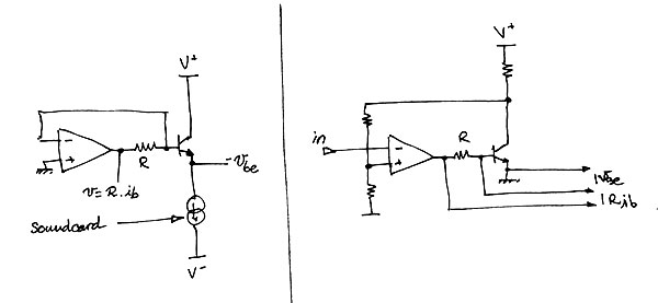

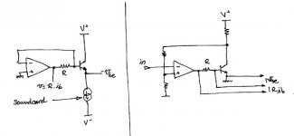

OK, time to get a reality check. Here are two proposals for measuring the thermal behaviour of a simple transistor.
This will need a soundcard capable of DC, ie for instance an old Soundblaster with all coupling capacitors removed.

#1 : A current source, controlled by the soundcard output, sends current through the transistor. An opamp holds the base of the transistor at a virtual ground potential. Therefore we can measure base current as a voltage in resistor R, and simply measure Vbe as Ve (since Vb = 0).
Pros :
- no need for instrumentation amp
- simple
- Vce is constant (one less variable to consider)
Cons :
- needs a good VCCS with high PSRR (maybe not that hard to do)
#2 : The transistor is used as an inverting amp, comtrolled by an opamp.
Pros :
- simpler
Cons :
- depends on the power supply precision (BAD !)
So, I prefer the first solution. Also, the other output channel of the soundcard could be used to control Vce, making it also a full transistor curve tracer.
A good voltage controlled current source is needed, with high PSRR, and of course, no thermal tails in itself.

peufeu said:Yes we have. Vbe at a known Ic / Vce makes a nice thermometer.
True. If we don't explicitly set Vbe then yes, quite right. I overlooked that. That makes your first circuit quite clever indeed. I vote for that one too.
Imagine this (like in the other doc I posted about transistor measurement)
- transistor is at ambient temperature
- set Vce, Ie to a know state
- wait for thermal equilibrium (heating transistor case... maybe 10 minutes)
- sample Vbe, Ib => Vbe0, Ib0
- set Ie to a much higher value
- sample Vbe, Ib continuously
- reset Ie to initial value
- sample Vbe, Ib => Vbe1, Ib1
Then, (Vbe1 - Vbe0) divided by 2 mV/°C gives you deltaT. You know the pulse width and the delta power, you can estimate thermal capacity.
Doing this enough times with various pulse widths, and then fitting, could give you a thermal model.
Yes, sounds good to me. 2 mV figure is just a rule of thumb, of course, but is probably good enough for the purpose, as is the linear approximation for temperature dependence if we don't vary the temperature too much.
