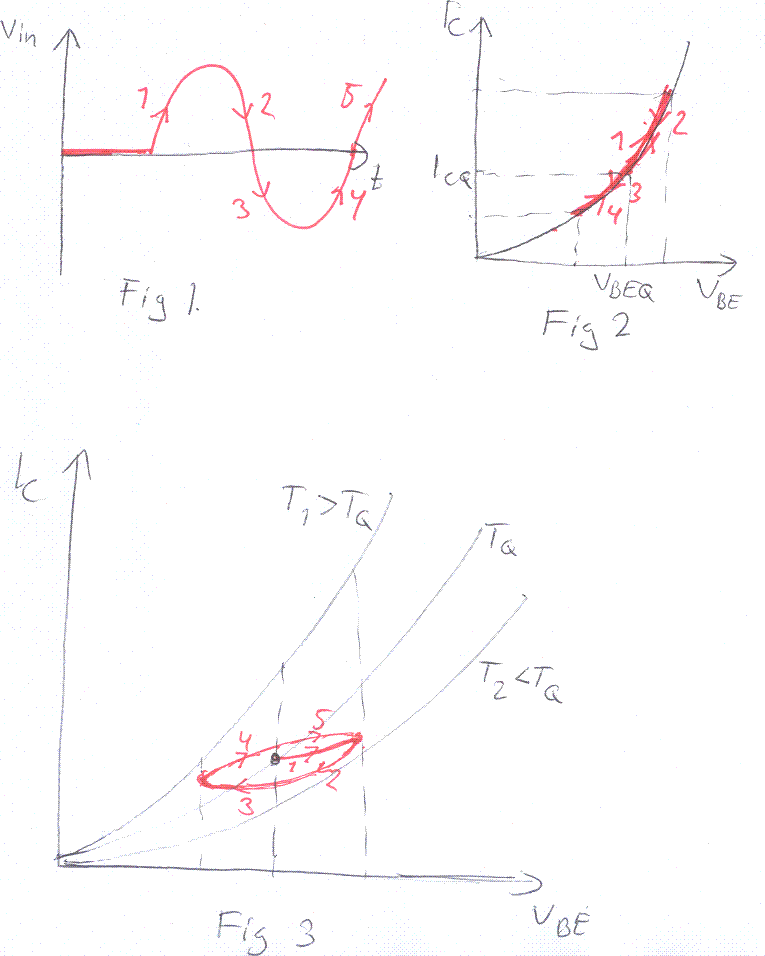

It seems that thermal effects can cause two not entirely different effects. One is that a sufficiently low-frequency signal modulates the Q point due to temperature variations. The other is that a sudden transient will cause the Q point to shift for thermal reasons.
I have been thinking a bit about these and I think it might be helpful to view the effects from a slightly different point of view, more precisely by looking at what happens in the Vbe-Ic diagram when a transient signal is applied. I first tried to figure out what ought to happen, and came up with the following, which have followed up by simulations soon to be posted.
Fig. 1 shows the input signal, which is 0 V until a we suddenly apply a sine wave, ie. we have a transient.
Fig. 2 shows what happens in a class A CE stage when thermal effects are not considered. We will simply move along the transfer curve around the Q point, as expected.
Fig. 3 is an attempt to envision what happens if we also take thermal effects into consideration. For clarity, I have added to extra transfer curves to show what happens to the transfer curve when the temperature varies. Now, consider applying the transient sine from Fig. 1. As long as the input is 0 V, we stay at the Q point (assuming we have had time to reach thermal equilibrium). As soon as the voltage starts to increas because of the onset of the sine, both Vbe and Ic will increase, just as in Fig. 2. However, since the power will decrease simultaneusly, so will the temperature and we will move a long a transfer curve that is sliding from the Tq one towards the T2 one. We will thus not follow the transfer curve for Tq but move towards the transfer curve for T2 while Vbe and Ic increase. When Vbe and Ic stats to decrease again, the power will slowly increase and we will move towards the transfer curve for Tq and eventually towards the one for T1. However, when passing Vbeq, the temperature will still be lower than Tq, so we pass below the Q point!When Vbe and Ic finally starts to increase again to conclude the first cycle, the transistor will be warmer than Tq, so we will pass above the Q point, which means the cycle does not end where it started! Further cycles will continue to "draw" a somewhat curved elliptical shape that encircles the Q point. Since the average power with a cyclic signal is lower than the Q power, the ellipsis will pass closer to the Q point on its upper path than on its lower path.
Hugh talked about hysteresis before, and this seems to have some similarities to hysteresis. In fact, the behaviour in Fig. 3 resembles the virgin curve for a magnetic material.
