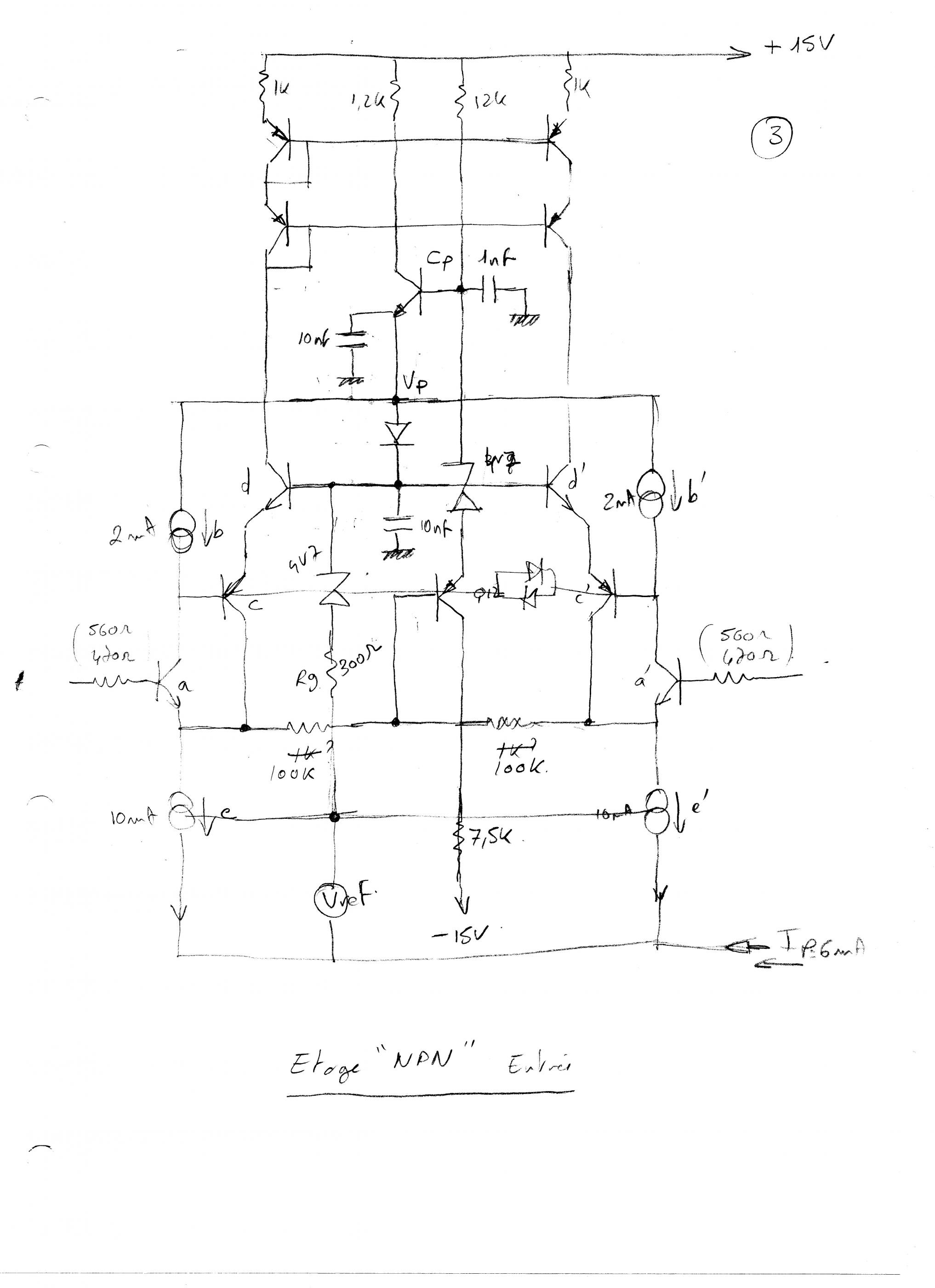

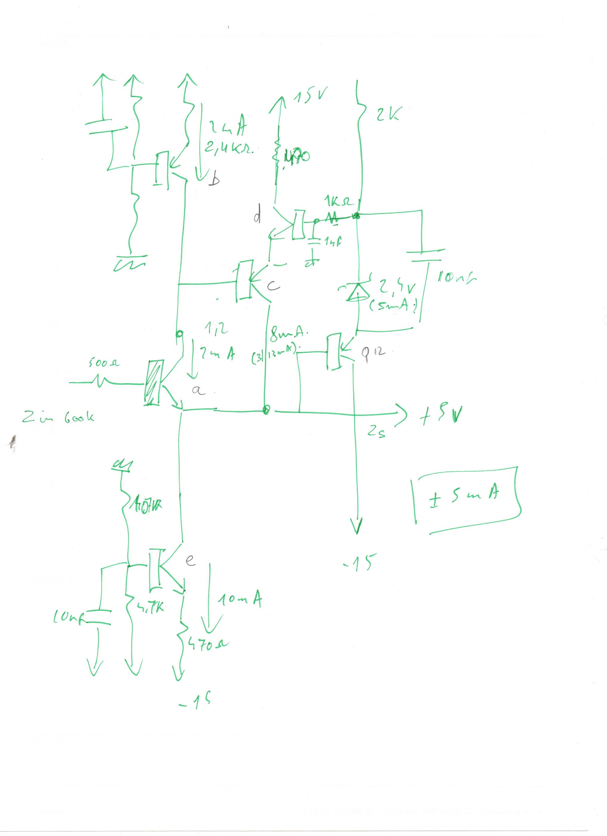

Has anybody tried with mosfets instead of bjt's?
These can be biased at zero-tempco currents. If the amplifier was in positive tempco we should get unsymmetrical distortion, while at zero tempco thermal distortion should be lower and more symmetrical.
Since i don't expect other parameters from the mosfet to drift much at this point, a sudden decrease in distortion or improovement in quality would give a good clue.
Anybody thinks from memory on a small/medium power mosfet to do the job?

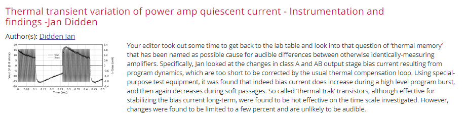

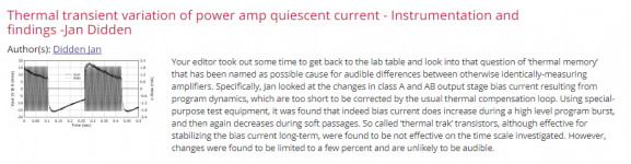

A very interesting article about crossover distortion and thermal stability. A handwaved topic, if not just ignored while it is of a paramount importance in my opinion.the info in Fr on memory distortion: La distorsion thermique (Héphaïtos)
many people in here do not believe in memdist, however many claim better sound when use cascoded or cfp pairs at the input...
a little more: La distorsion thermique- tube contre transistor (Héphaïtos)
and L'étage d'entrée de l'amplificateur -1- : étude théorique (Héphaïtos)
well, I do not know FR but understood (hope so 🙄)
I am glad to see that Thermal track is not so good.
The diode is NOT on the same die, so it is harly better than a diode well thermally bound onto a BJT.
They missed the point, Thermal Track is just a commercial guimick in my opinion.

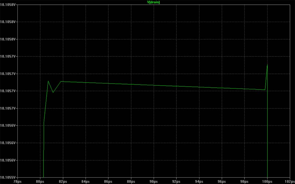

The problem is it's not memory it's thermal distortion. SPICE can be modified to use T, I , and V as independent variables. A first order analysis with fixed Rt/Ct does a lot, but yes heat is a diffusion process. The problem is that the device to device coupling is hard to compute for a discrete circuit. The problem has been solved for IC's in closed form by Alberto Bilotti long ago and there is a very interesting paper in the RCA Technical Journal (?) where they used this to fix an early NTSC color decoder.
I know of no free SPICE that does this but there is an IEEE paper somewhere on how to implement it. I was the EE half of a team implementing it in house but it was not published for the public. This was 25yr. ago already, time flies.
They missed the point, Thermal Track is just a commercial gimmick in my opinion.
My test was with the Sanyo thermal track devices which DO have the diodes on the die.
Jan
Please give my the exact reference of the device, I am very interested.My test was with the Sanyo thermal track devices which DO have the diodes on the die.
Jan

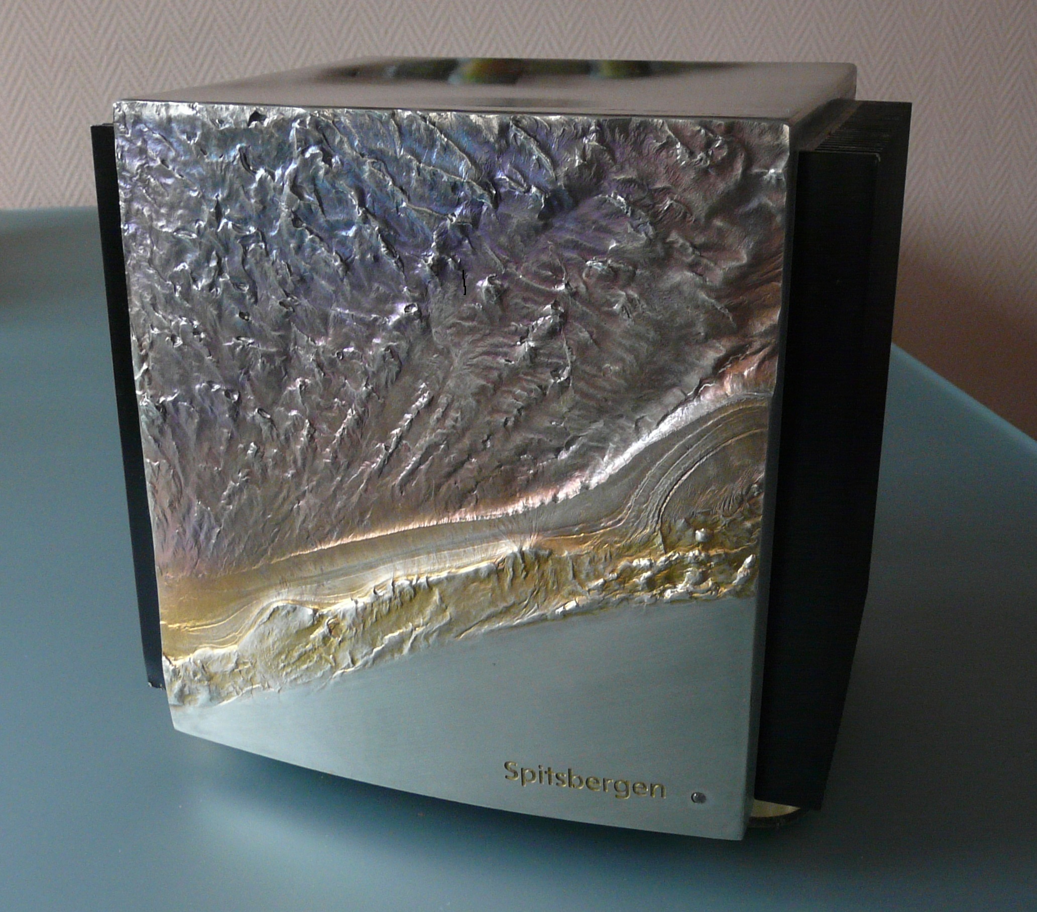

I just remember, my Spitsbergen amp design was reviewed by Jean Hiraga in, iirc, 1998, and graced the cover of L'Audiophile. It got 39 out of a max possible of 40 points ;-)
So the circle is closed again.
