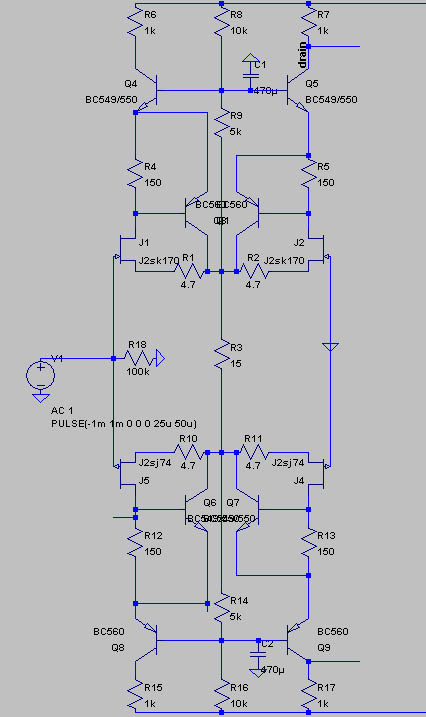

I'm referring to post #9.
Imagine version B but with FET input pair. What would be reasonable working conditions for the Q's?
Whatever I do, LTSpice shows me sometimes more, sometimes less ringing, but never a square wave so clean as with a conventional input pair, *when applying a following stage like a VAS or a Folded Cascode*.
Is it a bandwidth issue? A cfp push-pull diff pair I'm simulating has -3dB at 4MHz (taken from one drain) according to the sim, a folded cascode gain block 3Mhz (open loop)
Some light shed on that issue would be much appreciated...
Rüdiger
