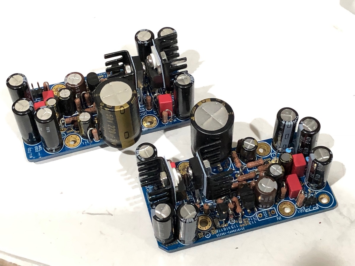

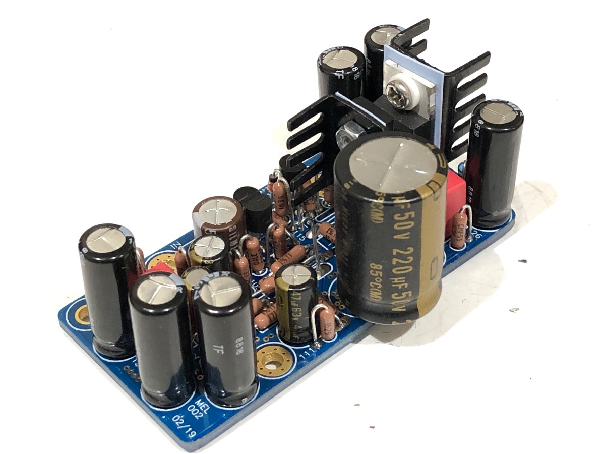

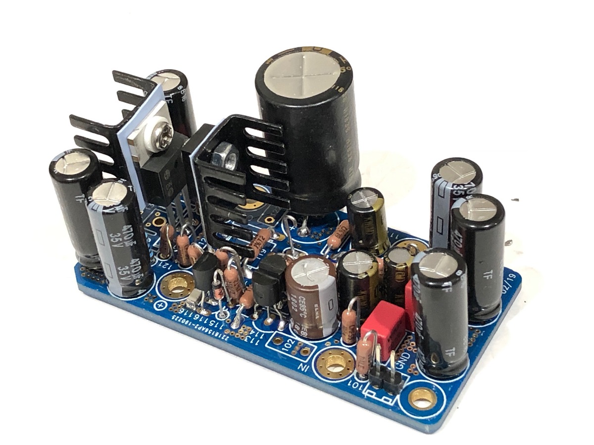

Built but not tested. Sure glad I have a stash of KSA1381's! The Arrow solution is very practical, so I don't think you guys need to worry. I am using the big 220uF 50v Nichicon Muse on the output and not using any of the input of output bypass filmcaps. My personal opinion is that when things are this dense, SMT would have been easier/cleaner. Lots of vertically mounted resistors make for a very dense forest of components. This is one dense amp!
X, reminds me of some of the early classic amps from the good old days from Sansui, Marantz and the like who used to mount a lot of their resistors vertically especially in their larger amps where space was at a premium.

It reminds me of an old Radio Shack radio control receiver that I assembled for a little r/c airplane back in the late 70s. Since there is one SMD cap that snuck its way onto the board, might as well go all the way and replace the other resistors with 1206 SMDs. Does the hole spacing lend itself to some careful soldering of such devices?Built but not tested. Sure glad I have a stash of KSA1381's! The Arrow solution is very practical, so I don't think you guys need to worry. I am using the big 220uF 50v Nichicon Muse on the output and not using any of the input of output bypass filmcaps. My personal opinion is that when things are this dense, SMT would have been easier/cleaner. Lots of vertically mounted resistors make for a very dense forest of components. This is one dense amp!
We originally had an all SMD board but people seem to prefer the TH one. So I stopped bothering g to ask JP to make a SMD update on V2. You might be able to for 1206 where the parts are standing up but it’s not ideal. What was nice for SMD version was that all the SMD were on the underside so there is total clearance.

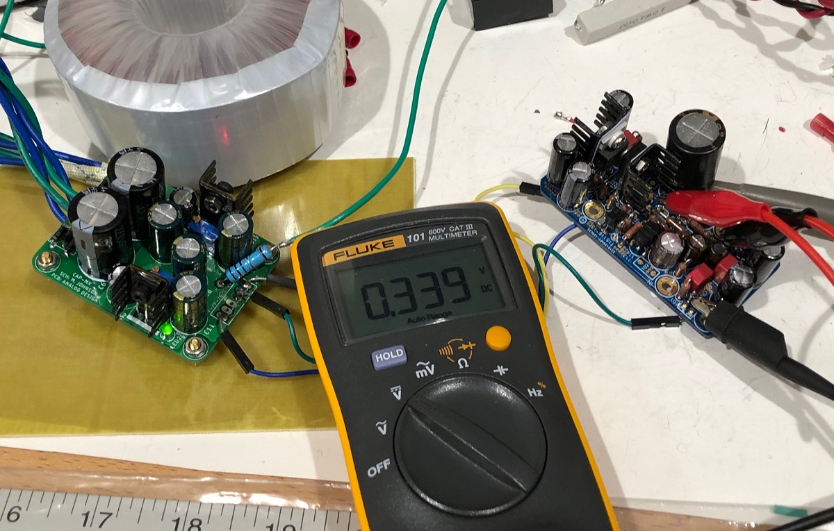

I just had a chance to test out the Melbourne for functionality and they work well. So the layout is good. I used a +/-24v Darlington BJT cap multiplier by Prasi. and measured 41mA bias current. With no matching of input pairs and using 15k 1% vs specified 14k9 for R104 and 15k 1% for R106, I got 21mV DC offset on one channel and 30mV DC offset on the other channel (not too bad). I am using a 220uF 50v Muse output coupler so that's not an issue. The 41mA current produces about 1w of dissipation in each of the two output transistors (DN2540 and KSA1381) - warm but not hot. Output noise as measured by Fluke 101 is 100uV rms. The output responds to input as verified on an O-scope. I did not have a chance to install it on the M2X amp yet as the PSU is sort of in disarray on the amp at present.

When building these, always a good idea to test it outside of the M2X with a simple dual rail supply to make sure the bias current flow is correct before installing in the amp. Even a +/-15v supply test is better than nothing.
Photo of bias current test showing 0.339v across 8.2ohms = 41mA (use the provided test points for alligator clips):
