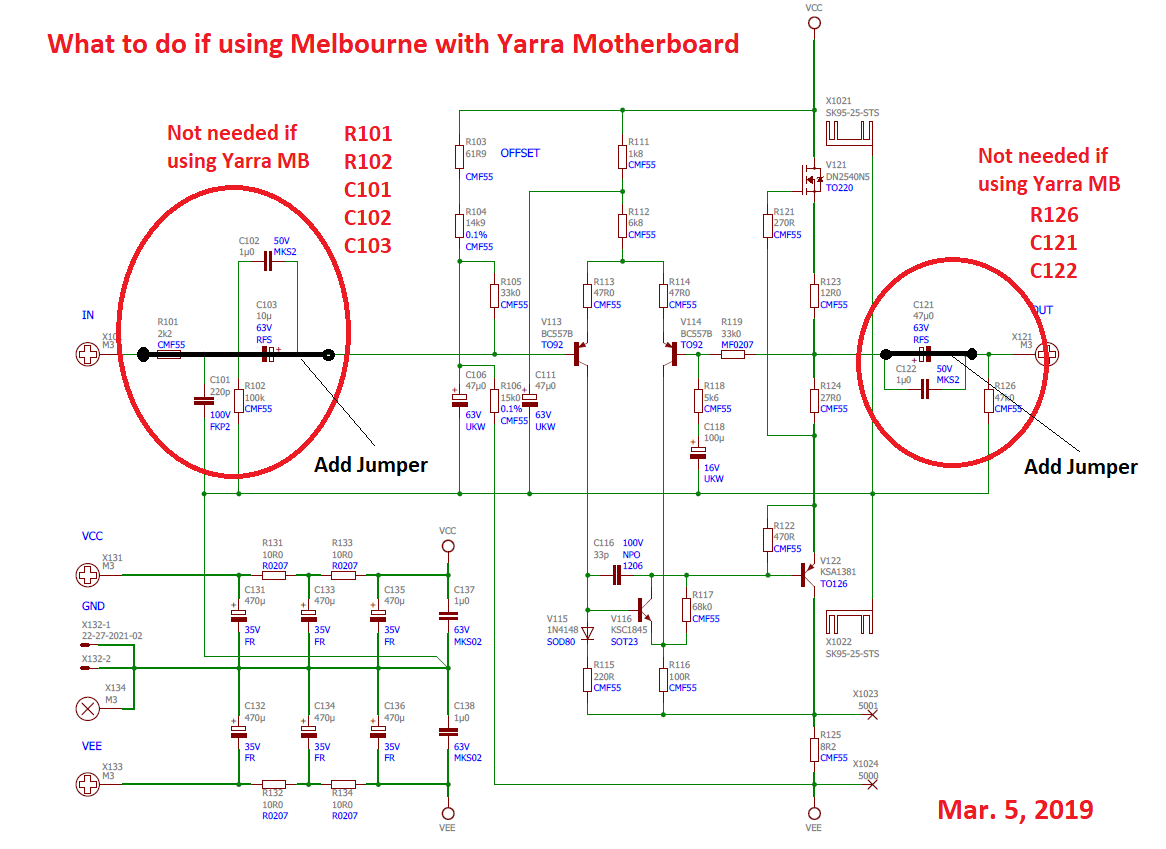

If you are planning on using Melbourne with the Yarra motherboard, you do not need to populate the input and output cap coupling sections on the Melbourne. Instead, replace with a jumper as shown and populate the Yarra MB to give yourself more room so you can use bigger and better boutique caps if desired. The output can be DC coupled if you wish (0mV to 20mV of DC offset depending on how lucky you are with all your components selected). If your amp has an AC coupling cap, definitely don't need it on the Melbourne/Yarra.

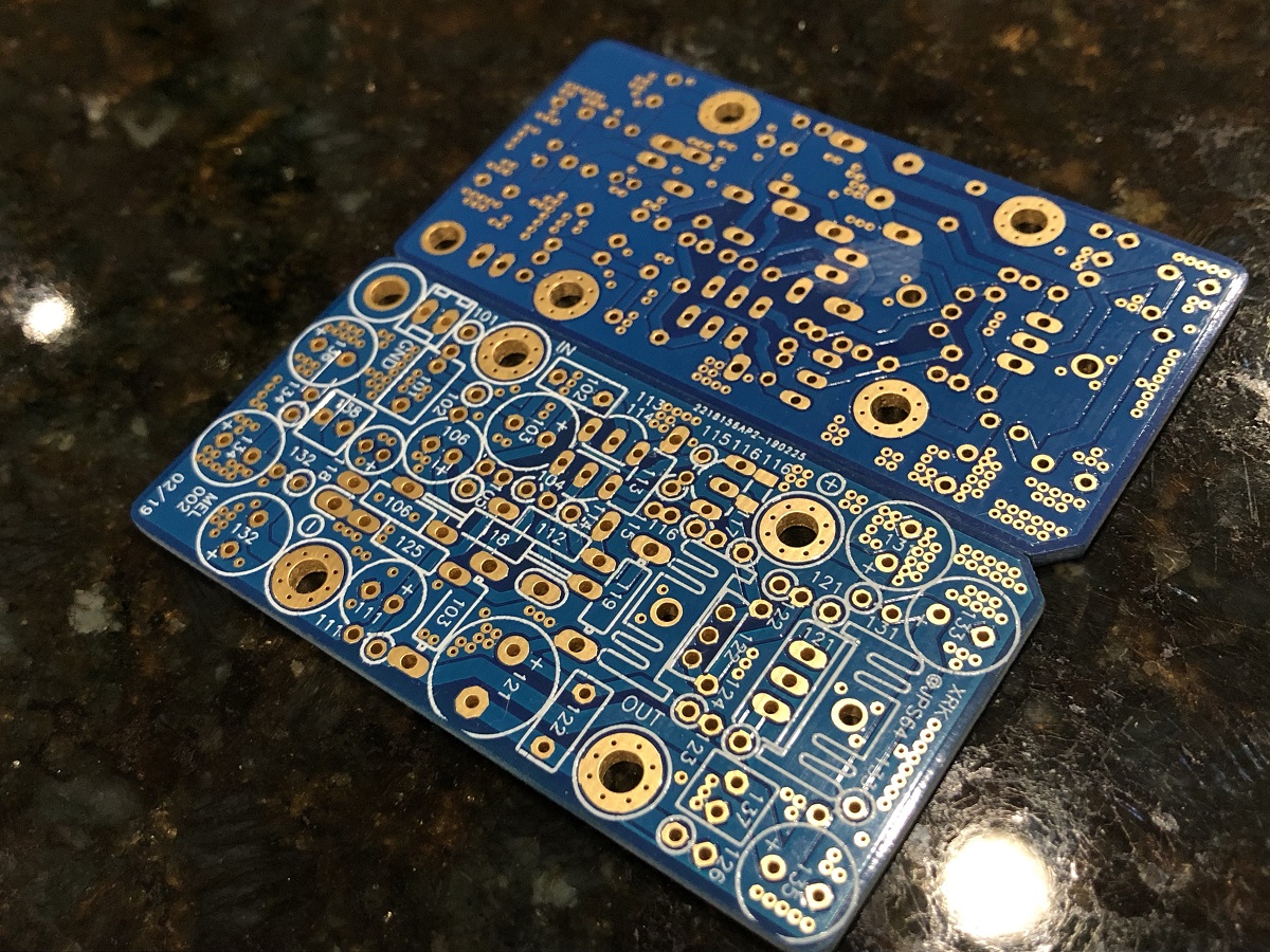

Fantastic X!! The boards look great.
It’s always nice to get an unexpected early delivery 🙂
Thank-you to you, JP and Hugh.

I just received then order from this shopping cart and went through it compared to the schematic. There are a couple of changes that are needed:
R104 received was a 14.7k 1% when it should be 14.9k 0.1%
R106 received was 15k 1% when it should be 0.1%
C116 received was 33pF 16v C0G 1206 and should be 100v NP0/C0G this one needs to be replaced, as the low voltage rating may cause distortion when driving at higher voltages.
The two values R104/106 are needed to be precise 0.1% tolerance to tweak the output DC offset as close to 0mV as possible if running DC coupled mode. If you will be running AC coupled mode it won’t matter. Also, until one takes all the variations on the DC offset path, it may not matter as the voltage drop across the transistors also come into play. It’s not a big problem - and it will still work fine. You may get 15mV offset but that may not matter anyway.
For the output coupling cap, I spec’d a 47uF electrolytic. For those of you intending to drive the Edcor on the M2X, that’s a 600ohm load, so something like 220uF would give deeper bass flat to 5Hz vs 20Hz as you would have for 47uF. I picked the Nichicon Muse series 220uF 50v (UKZ1H221MHM) for this. It’s a bit big and will have to stand up kind of high to clear the other parts or you might even try 100uF which is smaller diameter. Although the 47uF will sound just fine too unless you are trying to listen to home theater rumble.
Otherwise the Shopping Cart above is fine.
