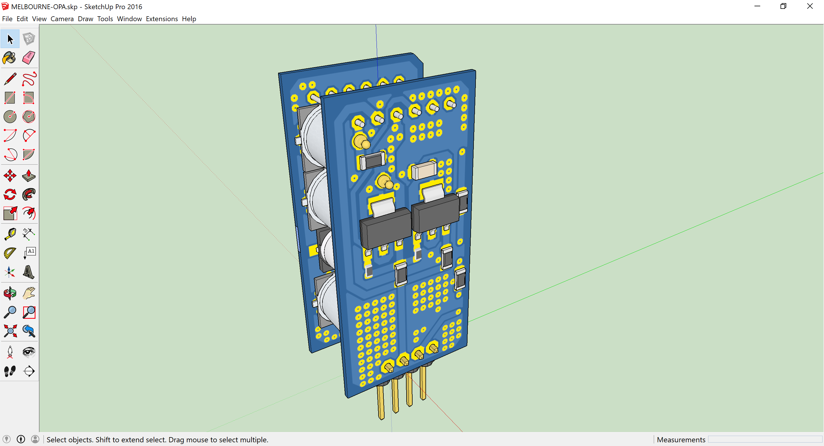

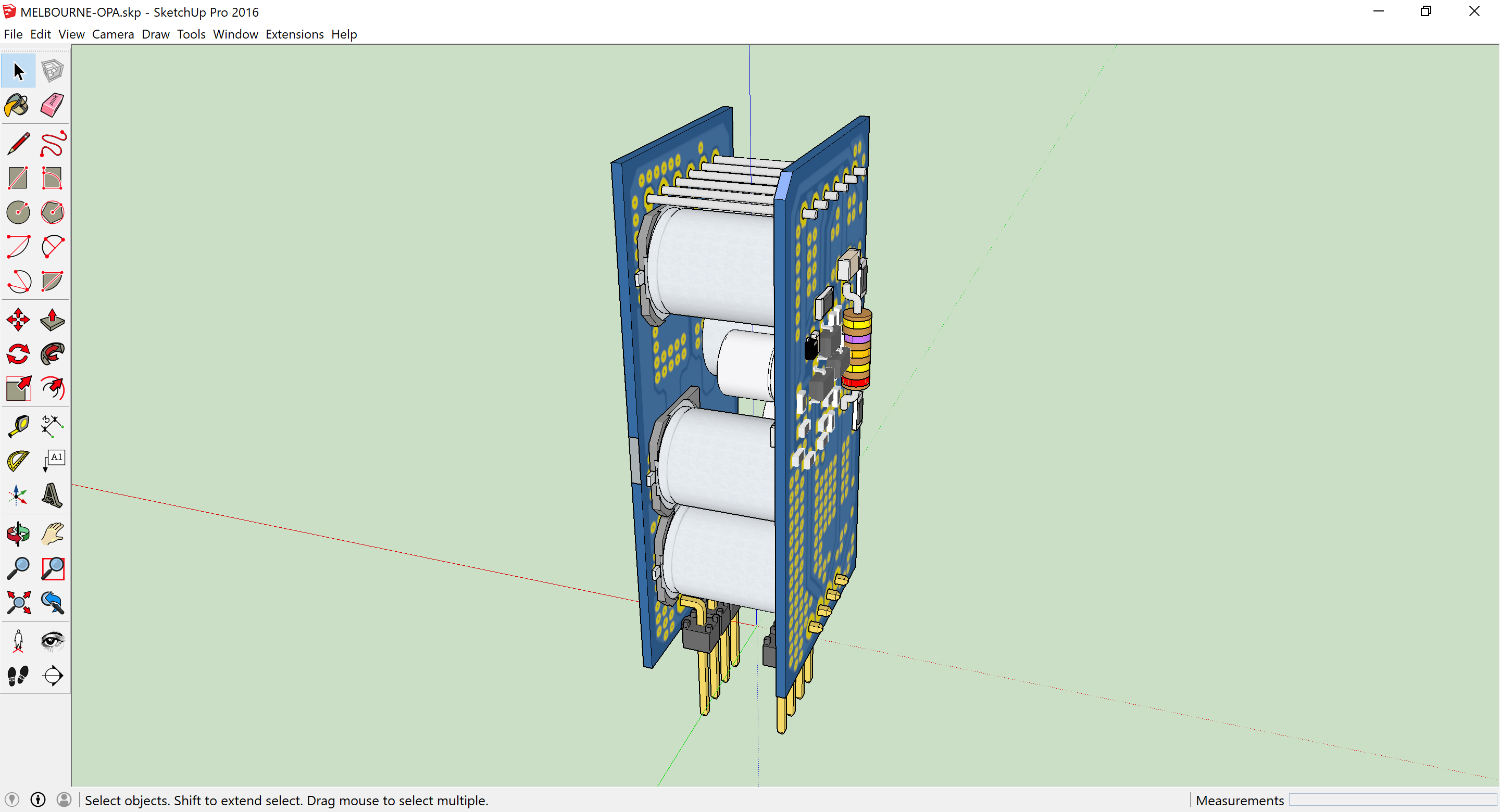

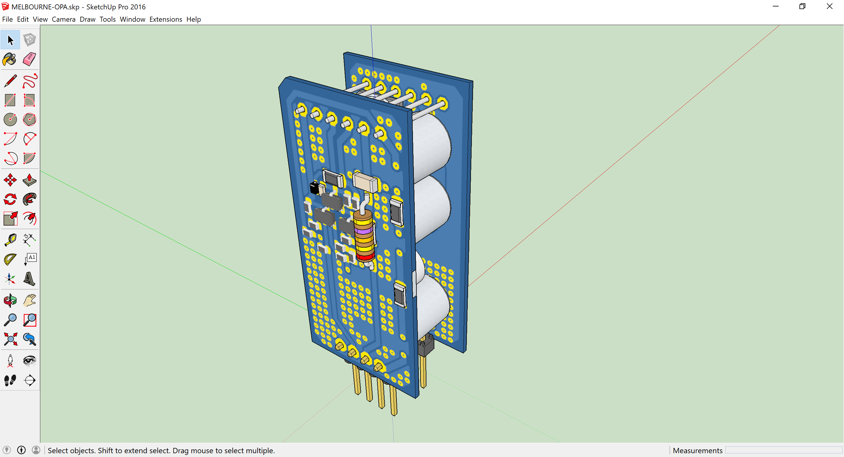

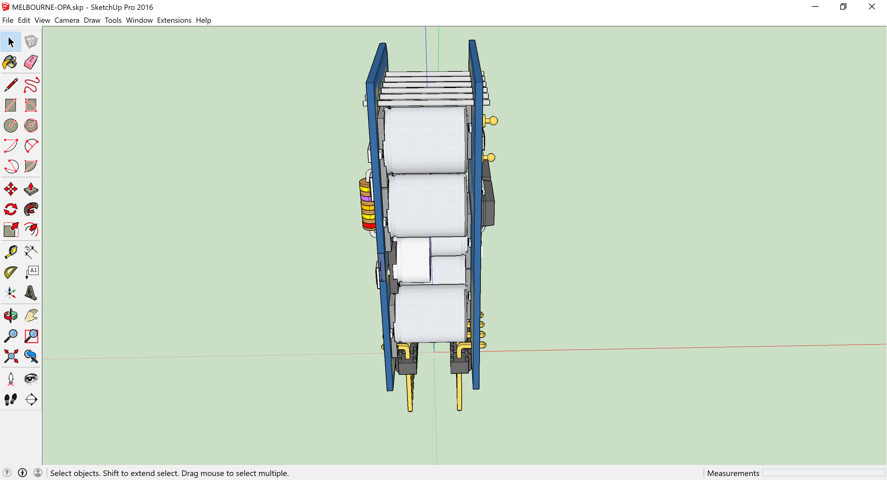

Well, MELBOURNE as OPA...
Only as SMD version, CRCRC included (3x 470µ/35V!)
GND on pin 1, I know not 100% OPA "Erstaz".
JP
oooh, very nicely done. Now that would fit 😀
I would be up to building this when / if it becomes available.

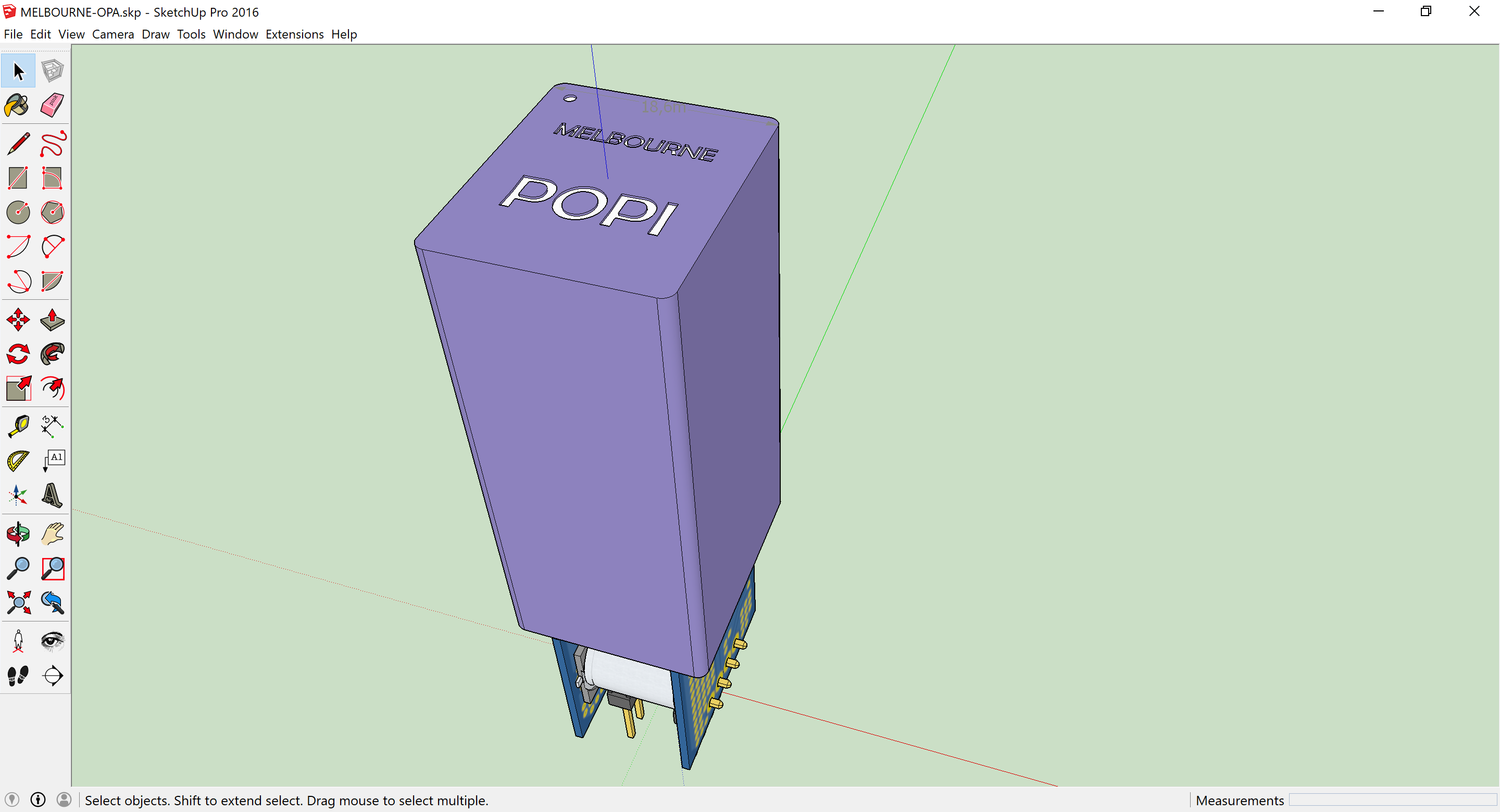

That’s fantastically quick work, JP! With some tweaks, we could probably bring this back to an “opamp” format - that is, all gain and compensation input coupling provided by user off-board. But it’s amazing that you got it to fit on two stacked wood pile boards. That’s not too big at all.
Please tell us what POPI stands for? 🙂

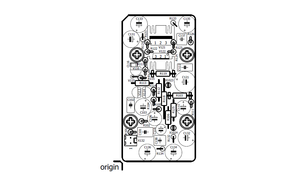

Received my boards as well! That is one dense layout! Nicely done as always JPS and X! Thank you!
If you use the stuffing guide (pdf attachment) in post 1, it makes installing the parts correctly, much easier. Mine worked the first time with no issues. Here is re-post in PNG format for easier viewing/printing. Note the orientation of the leads on the vertically mounted resistors.

I wonder if anyone has started building their Melbourne yet? It is a pretty simple project actually - just very tight layout, but that was necessitated by need to make it compatible with available board real estate on M2X main amp board.
A thought just occurred to me, one could use the Melbourne as a front end (input + VAS + driver stages) for *any* power amp output stage up to 50w. Just design the 4+1 bolt attachment points (extra bolt for GND) into your own PCB and concentrate on the output stage (whether it be push pull, quasi symmetric, SE Class A, etc.).
