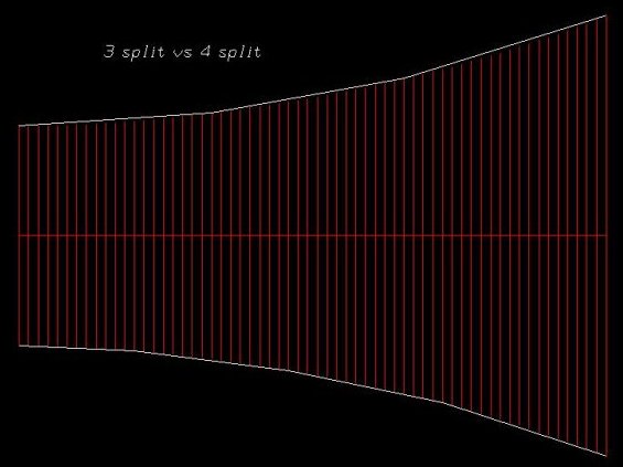

When I built my 80Hz midbass horns I modelled a fully curved sides / straight conical hypex versus 'stepped' curved sides / straight conical hypex and it made no difference at all.
It makes it a lot easier to build.

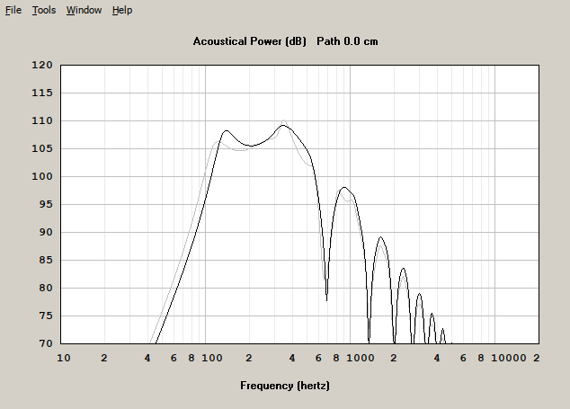

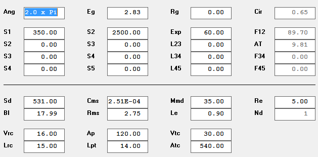

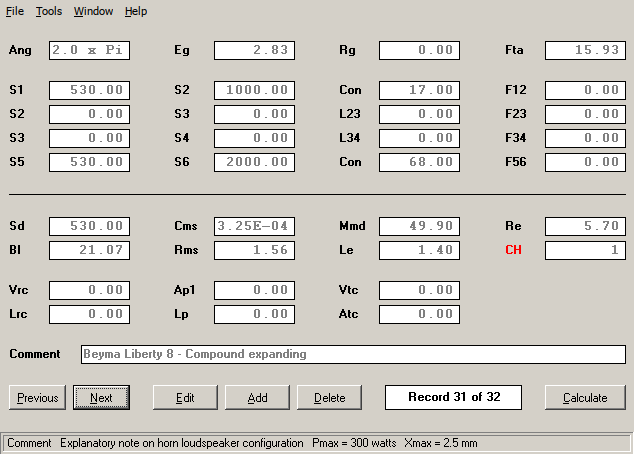

Just to illustrate the compound horns I played with before I found the super planar. Both are simulated as compound horns (which might not be ideal for the SP, but it seems to get similar results as the official hornresp models). Conical or exponential does not make much difference in these sizes. These were just concepts, the models would require some tuning. Grey is the non-expanding version. The expanding / dual horn seems to be smoother, but ends up as a larger box. It seems to fit my goal so far - 90 % of performance in a smaller box.
If you have space for them, the good old front loaded horns are the best, no doubt about that. I tend to think that a curved side is not really necessary - John Inlow's wonderful 8PE21 midbass horn is stepped and so is the Summer Rain by Joseph Crowe - and their intended range is higher.

here's one a bit better - still might be choked at high levels as only 162 sq.cm. entry into the horn vent

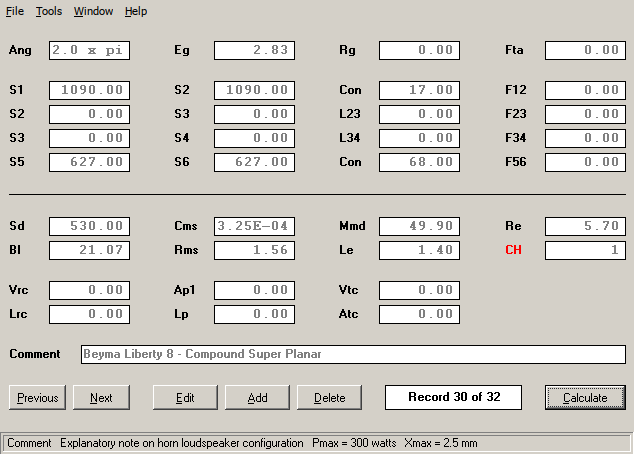

hey pelanj - that Liberty 8 looks good in a 0.8 scale "Harkness" blh - do you know if the 2.5mm "overhang" figure is really the coil height being 2.5mm higher than the gap height ? I can't find full spec.

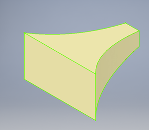

I have worked out how to generate the horn shape in Autodesk Inventor. To be able to do this you need a CAD package that supports 3D parametric curves. See the attached document. I have also included .ipt file for my horn which will import into fusion.
*squareToRectHorn.zip includes a load of calculations for the hornprofile that might be useful

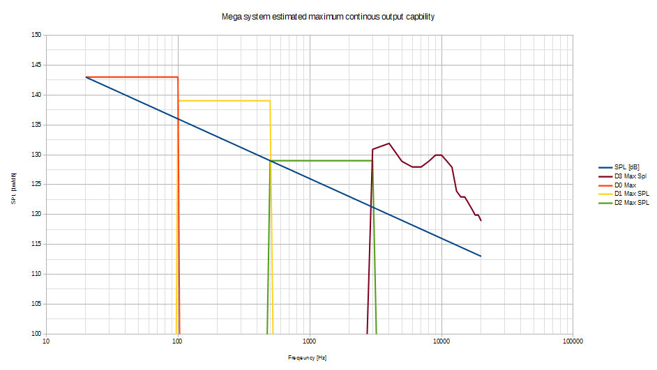

System calculations
I have done some basic sums to calculate the limiting factors of the system assuming that the spectrum of what we want to play is that of pink noise. Everything based on continuous ratings.
Speakers:
20 - 100: TBD sub system
100 - 500: this horn
500 - 3000: M200 on TBD horn
3000 - 20,000 Eminence N151M-8 on TBD horn
Adjusting so that the M200 is the limiting factor (ha not much of a limit) we will need a sub system capable of 142dB/1m @20Hz equivalent per side or in a mono stack 149dB/1m @20Hz. Considering the cost of that and the need to get it into a van that will probably have to be scaled back a bit...
