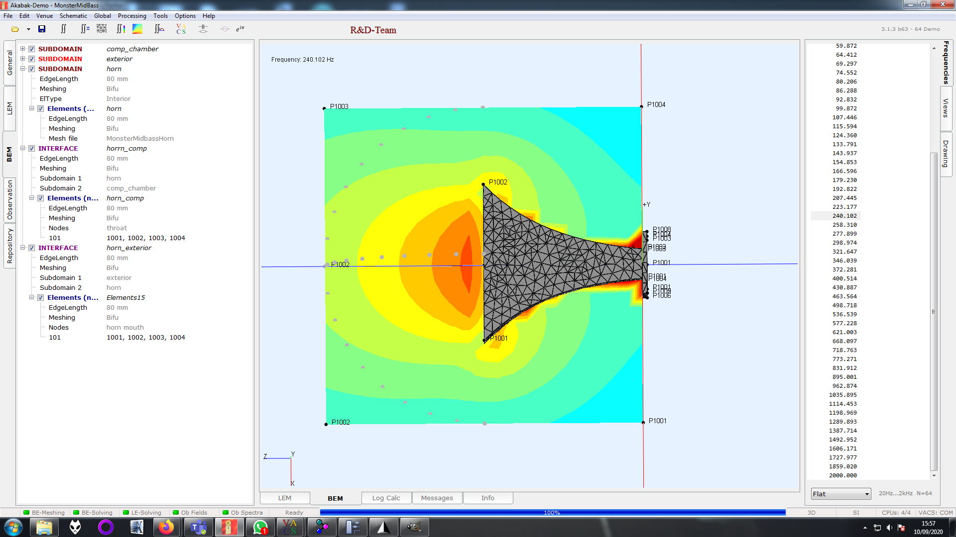

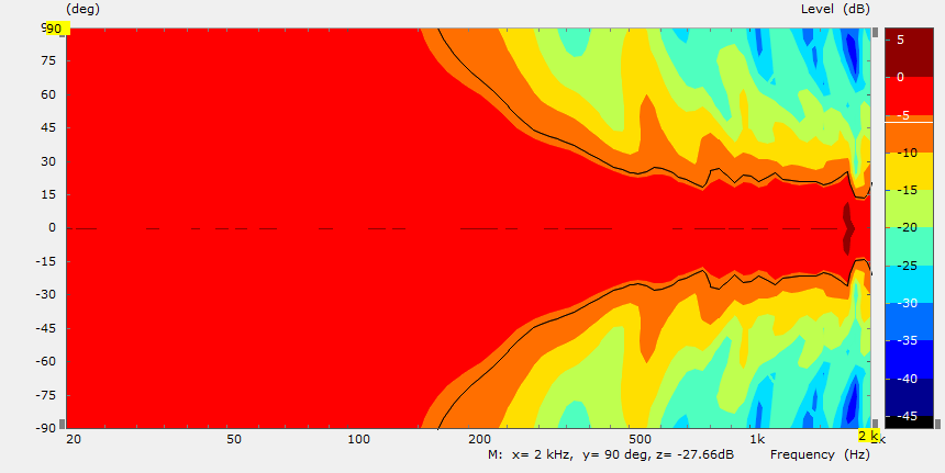

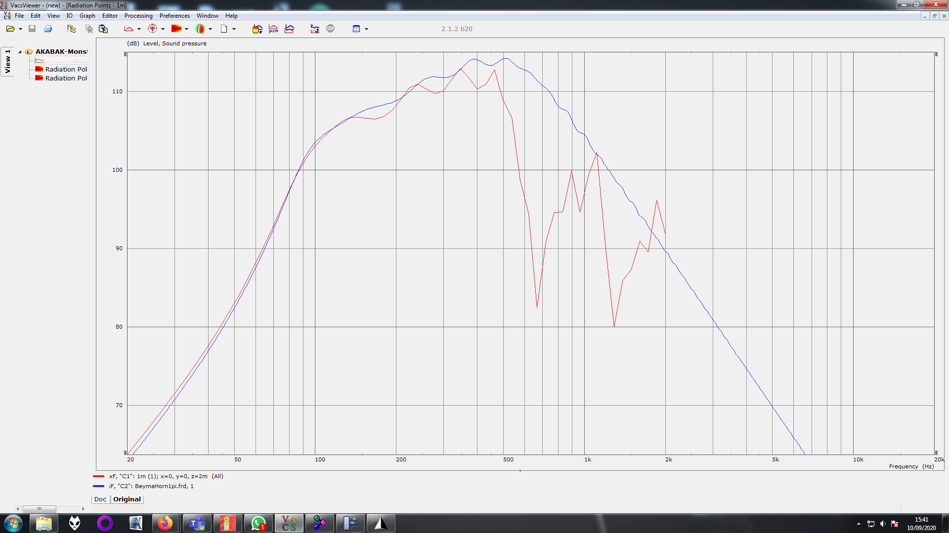

I learnt to use Akabak 3 so simulated the horn in that. Response drops off a bit earlier than Hornresp as effects like cancellation across the diaphragm are simulated. I don't want a phase plug so will probably cross to the M200@450Hz or 400Hz to avoid the issues that are happening >500Hz
I have attached the simulation, there is considerable scope for optimization like only simulating a quarter of the horn. Simulation is freespace.
-6dB beam widths:
Beam width H@400Hz =76 degree
Beam width V@400Hz= 108 degree
Beam width H@450Hz= 66 degree
Beam width V@450H= 98 degree
-6dB beam widths:

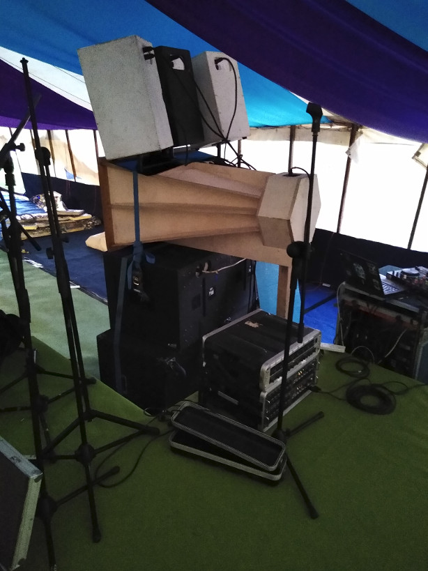

First gig

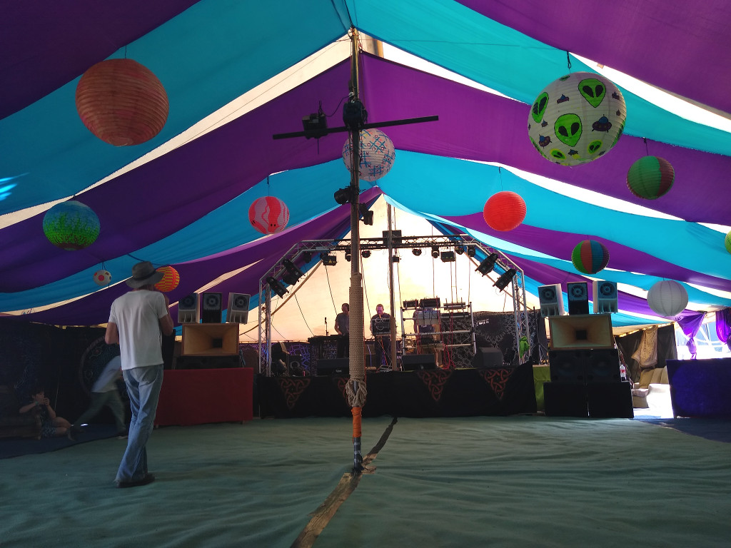

The horns have been completed in the past few weeks and had their first gig at the Palais de Phonix stage at Sol Fest. Very pleased with how they turned out, plenty of headroom. This was especially noticeable as I was operating them in the same range as the lower horn on the orbits but ended up trimming the orbits down 6dB and the midbass horn up 6dB as the orbits amps where starting to clip on some acts. I do have some measurements and they look close to simulation in response but I have an absolute SPL calibration error so will retake the measurements when I have a calibrator to work out what the issue is. Lots of positive comments on the sound and the horns are an easy two man lift.

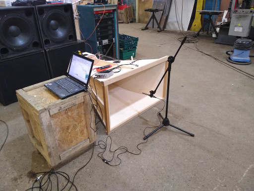

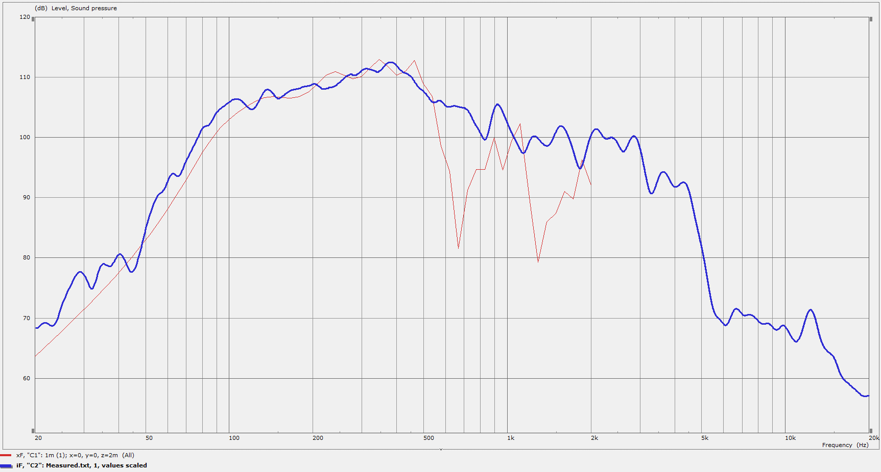

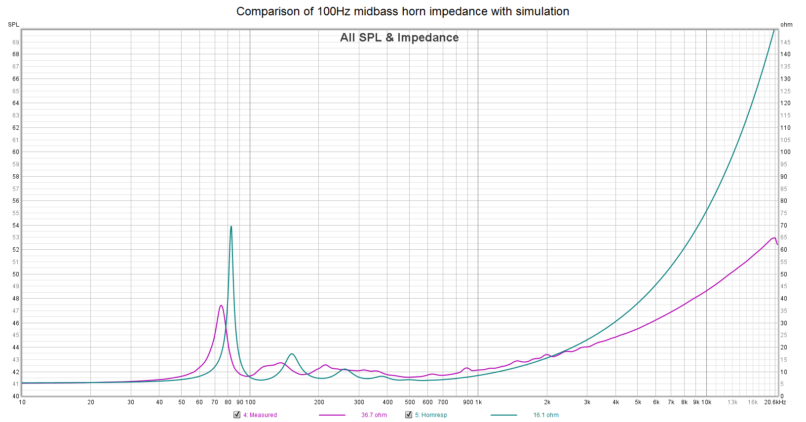

Here is the measurement data I have. I used a UMIK-1 (which I subsequently checked for frequency response against another microphone) correcting for distance and level adjustments the sensitivity is too high to be plausible. I have therefor just adjusted the mid-band sensitivity of the measurement to match simulation. Measurements where also not exactly ground plane taking place in a large industrial building at 3m and have been smoothed 1/6th octave. Hope to drag it outside and get a SPL calibrator so I can find the actual sensitivity. I know its more sensitive than the 3 orbit array in the above picture.
Impedance sweep shows that the rear chamber might be oversized (shifting of lowest resonance peak) this doesn't seem too critical an issue.

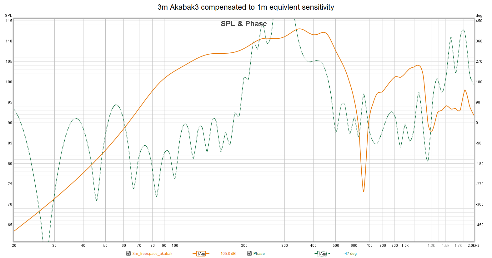

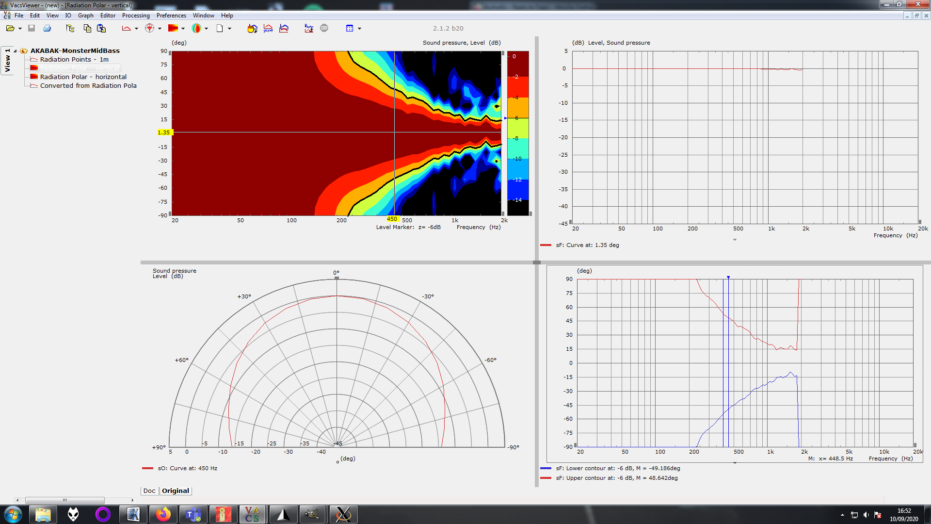

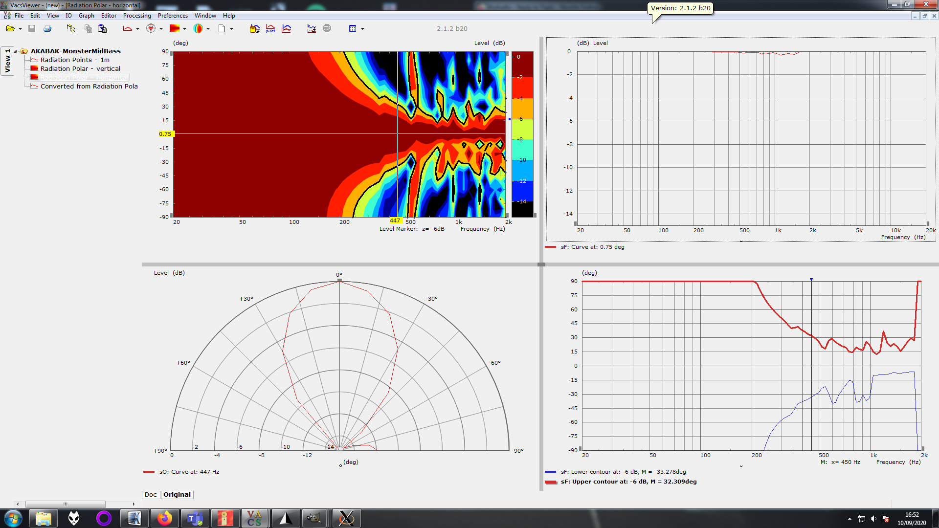

I improved the simulations of this horn after learning more about AKABAK3. The new simulation of the horn (attached) in free space uses a quartered model, simulates in only a few seconds and had no weird behaviour beyond 500Hz. Key was to make the interface between the internal and external calculation domain to be a one side open box rather than a plane.

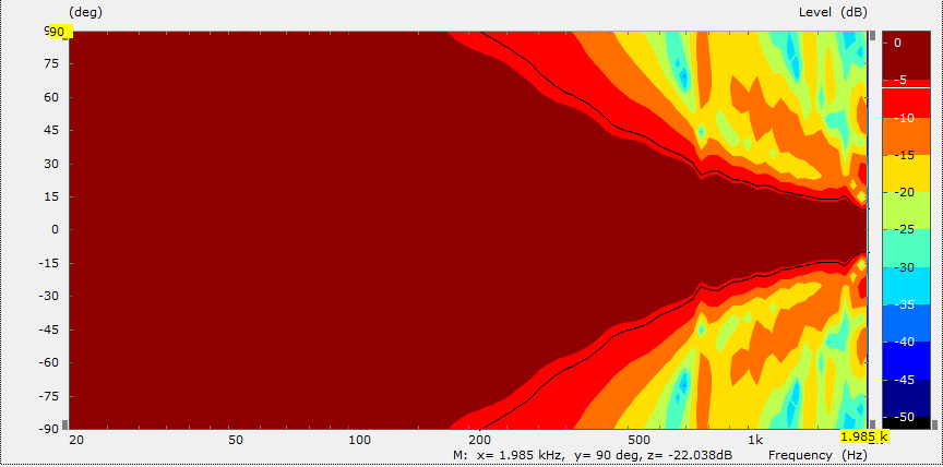

I also learnt how to process the beamwidth data better... weirdly it looks like I would be better off running the horn on its side if I want to cross over at 500Hz! for a nominal 90x60 pattern (oops). Although I think also a 400Hz crossover in the conventional oriantation would be acceptable.
Also it occurs to me that the horn was measured on the floor (half space) and my simulations are full space so I should simulate the horn in half space as well. When the weather warms I should be able to measure the horn outdoors and get some real world polar data, but I don't expect great deviation from simulation.
Horizontal normalised polar:
Vertical normalised polar:
