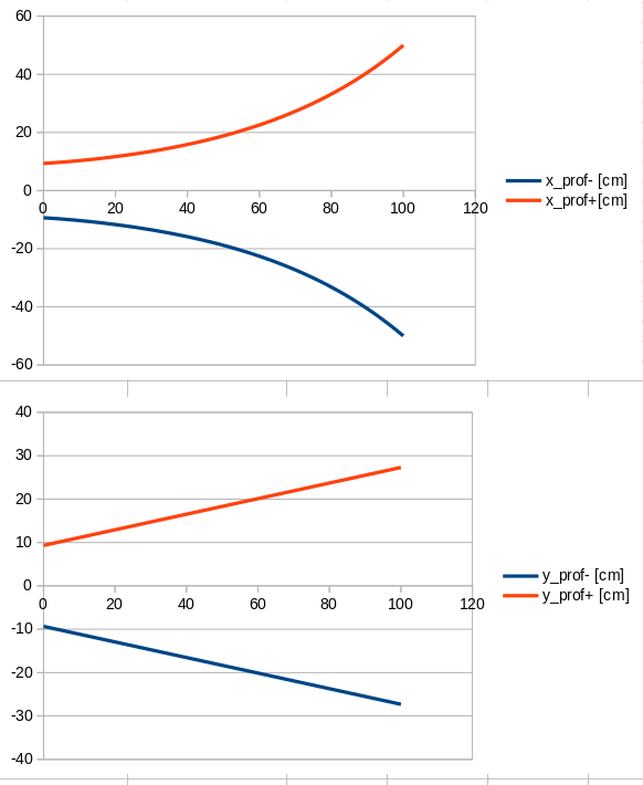

I think I nailed this but perhaps I made some mistakes and more can be wrung out of this driver or another drive can get similar results at lower cost.
The aim is a midbass horn covering 100 - 400 Hz that can keep up with a community M200 on a clone of a K-402, or is that's a bit challenging a classic dual conical CD horn. The midbass will be the same width as the K-402 (1m) and will also be a rectangular horn. The aim is to make a 3 way full horn stack that can keep up with the M200 and has low distortion. The driver used is the Beyma 15p80fe/n as it has very low Qes and high power handling and 7.5mm xmax. I selected an exponential flare as it should provide the highest fidelity.
I used the papers of Keele to design the horn:
The throat is sized for maximum acoustic efficiency, the mouth size was selected to be optimum and the rear chamber is sized for reactance annulling at 100 Hz.

I have calculated the profiles for the x and y contours of the horn. In the y plane the horn is a simple conical and in the x plane the horn makes up the remaining area such that the overall area is exponentially expanding to the final mouth size. The throat is a square and the final mouth is a rectangle with a width matching the k402 clone. As only one set of sides has to be curved this should make construction a lot easier.

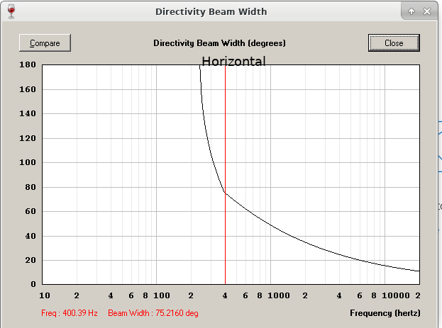

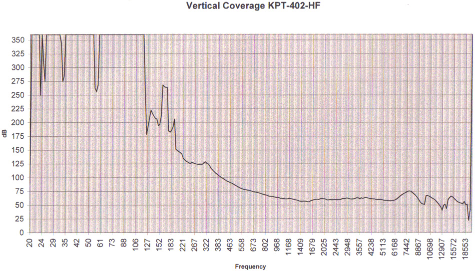

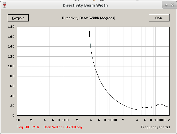

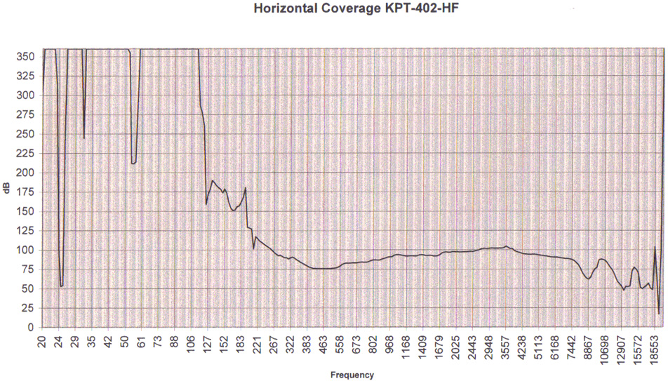

Thanks to Hornresps directivity tools I have found a problem? (more on this in a bit) with the horn, the vertical pattern at the crossover frequency of 400Hz is too wide and the horizontal too narrow. We are trying to get a nominal 90x60 but have 75x134... however the k402 reportedly has a pattern of ~75x105 at the same frequency to which this is a good match. As the mouth dimensions are quite similar this makes sense (as both horns are loosing directivity) and so will probably be also the case if I go for a similarly dimensioned dual slope conic horn for the midrange.
To simulate the pattern I made new Hornresp records with identical parameters apart from changing the flare type and the mouth area such the the diameter of the mouth would be correct for the plane under study. (as Hornresp simulates a round mouth).
From these results I'm tempted to increase the vertical dimension of the mouth to obtain a better directivity match. The current midbass horn has a side wall angle of ~20 degree which is anomalous with having a 60 degree overall pattern (they should be 30 degree). However the size and weight would increase and throat impedance will have larger ripples with the only gains been small improvements in the directivity plot around 400Hz, where its already pattern flipped and becoming non directive.

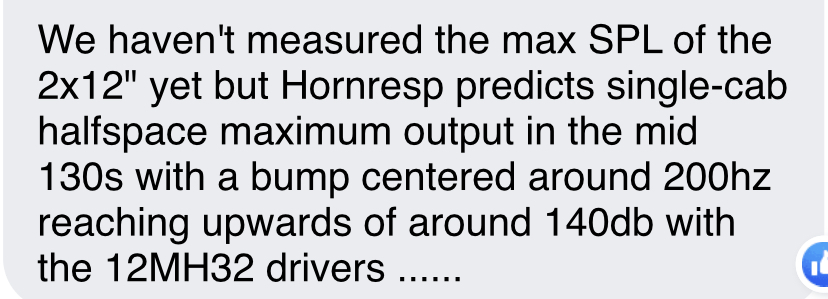

This is what MMJ said about it (see attachment). Maybe there are some newer measurements, but Facebook is a hell to search for info. I think there was a Hornresp record in the Super Planar thread here.

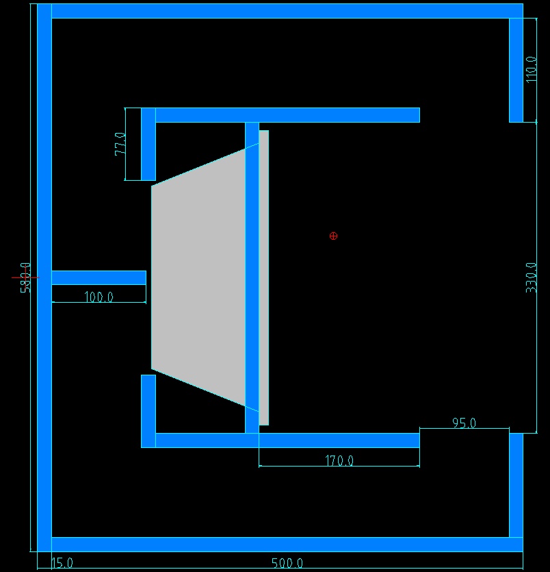

The second attachment is the plan I will build with Beyma Liberty 8 (internal height 330 mm, 15 mm plywood). I wanted to try the super planar as an alternative to the horns as it should offer similar "dynamic" performance.
I am sorry for hijacking the thread - the Super Planar sounds as a viable alternative to large front horns, so I want to try myself.

This is the predicted response with a pair of 12MH32s at 63 V, I used the file available in the FB group - High Order Quarterwave Society (DIY Paraflex & Super Planar dev community) Public Group | Facebook
I am not sure if I can share it, but I think MMJ would have no problem with that, maybe if you send him a PM.

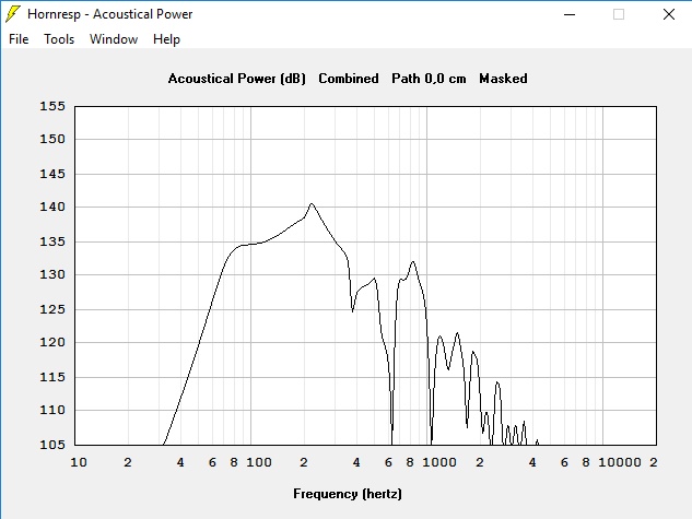

its cool, that super planar stuff is hard to navigate on FB I wish they would use a forum. Looks like the exponential horn has is tiddly beat with 139dB max SPL over the band of interest. I have got fusion360 installed now so hopefully I can generate some some CAD files. I think it would be pretty easy to build even with a basic circular saw though; when you have a conical expansion as one of the axis. Lots of projects on the go at the moment, need to get two more subs built for the end of the month.
The one design that could be louder would be a front and back loaded horn design (with the back horn having a 180 degree bend) but that would seem very difficult to build; for one how would you even get the driver in!
