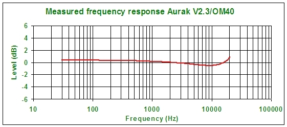

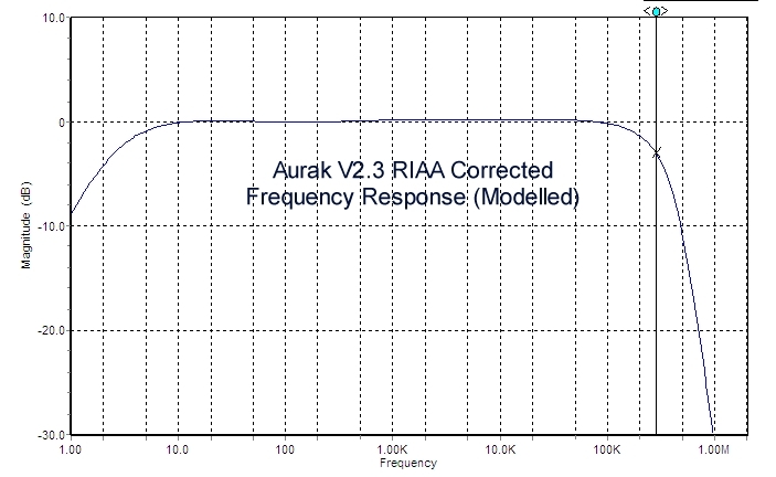

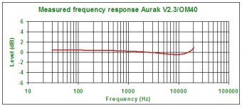

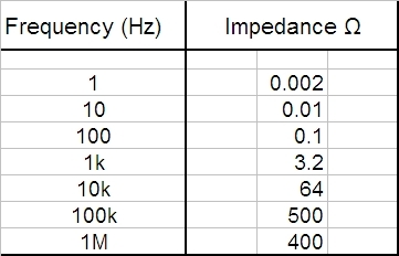

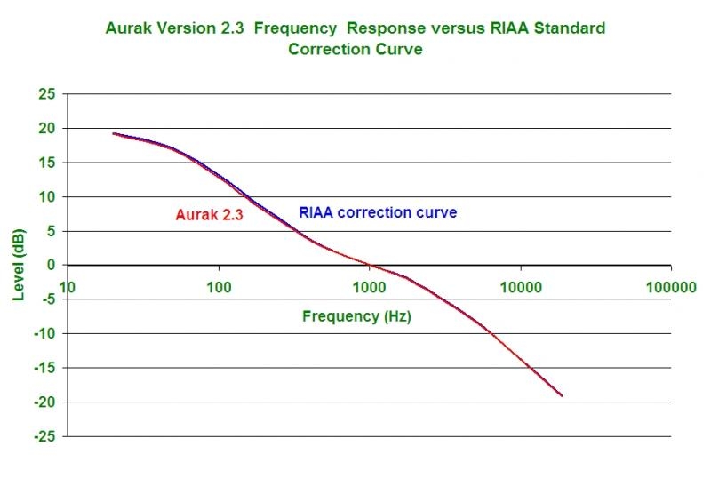

I will re-up the Aurak schematic, but first here's some old plots of modelled and measured results with Aurak and an OM40.

For both MC and MM/MI, success depends on the generator being able and happy to deliver current limited only by its own electrical impedance. Power involved is tiny, but generators aren't nec very efficient/powerful. Some MM/MI cope beautifully, others not IME. MC power loading effect on generator is perhaps more pronounced, lower efficiencies being involved.......

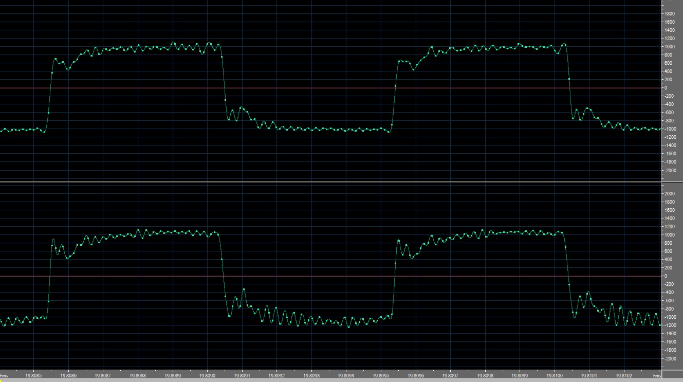

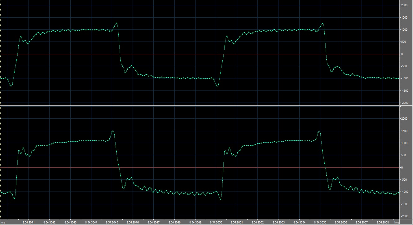

FYI - Here is the STR112 side A on my setup. The first is Lateral 5cm/sec tri-wave @ 1kHz outer groove, second is inner groove of same. Yes this disk is recorded as an analytical signal directly to the cutter and they claim great care was taken to get the displacements and velocities exactly right.
As direct as possible recording, cart buffered by 2SK74 followers directly into Tascam DR-60D mic inputs, 24/96 with 32,768 full scale.
EDIT - Note the slope changes on the inner grooves, I hope LD has a story for this. 🙂

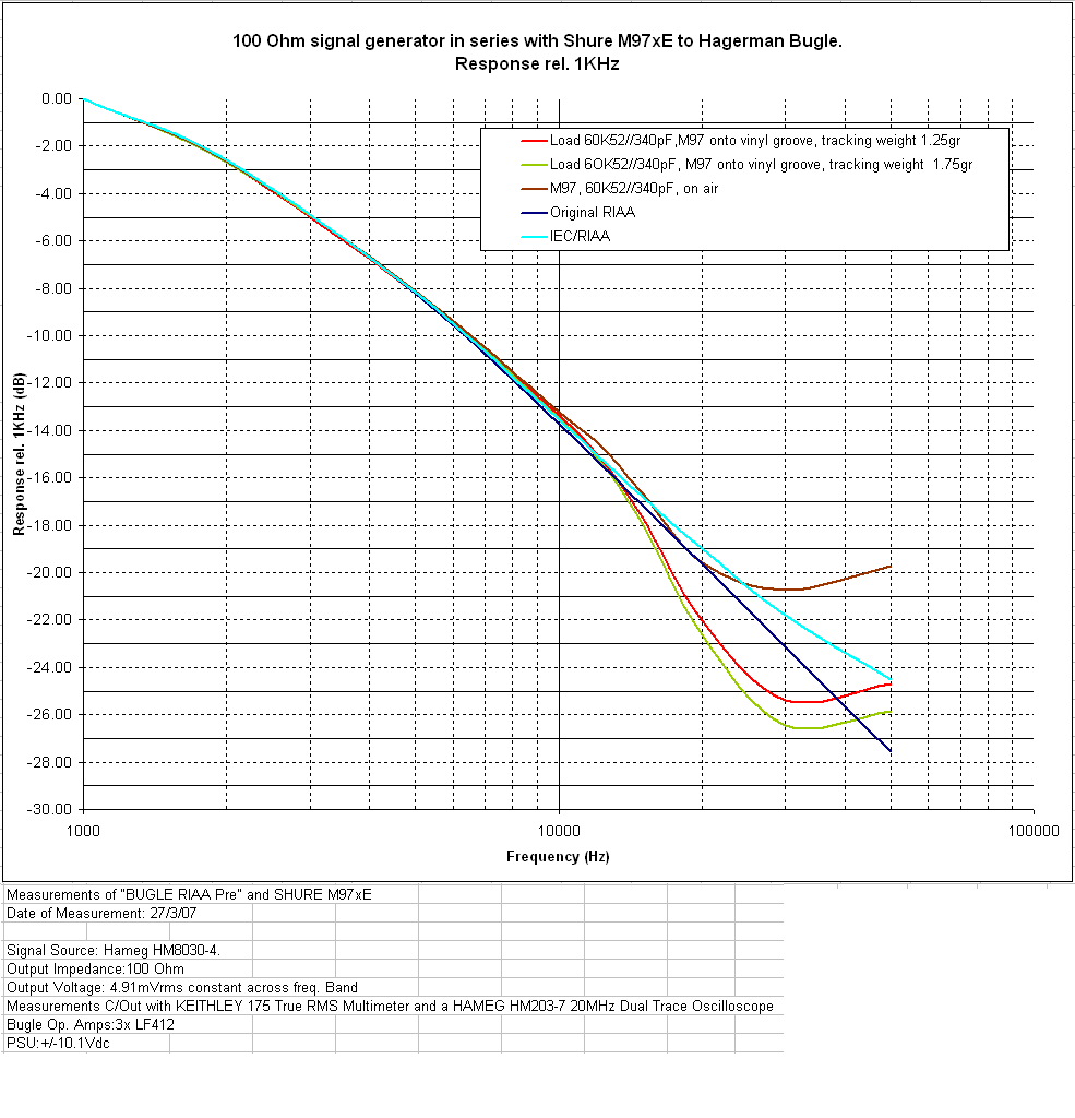

Basically we are looking for any evidence of roll off greater than second order at the high end that might be due to something other than the LCR response of cart and phono stage
How you measure this is the big question, at least for those of us mortals without the $$$ B&K test records.
Bill, sorry for not responding earlier.
Here is from some old measurements. A signal generator connected in series to the cart and then to the RIAA preamplifier.
Cart is standing off the record (on air) and also lowered onto the stationary vinyl (two different tracking weight settings). Brush was not engaged.
Now I have a digital signal generator and I can repeat the measurements in a much more consistent way and I will go higher in frequency.
George
