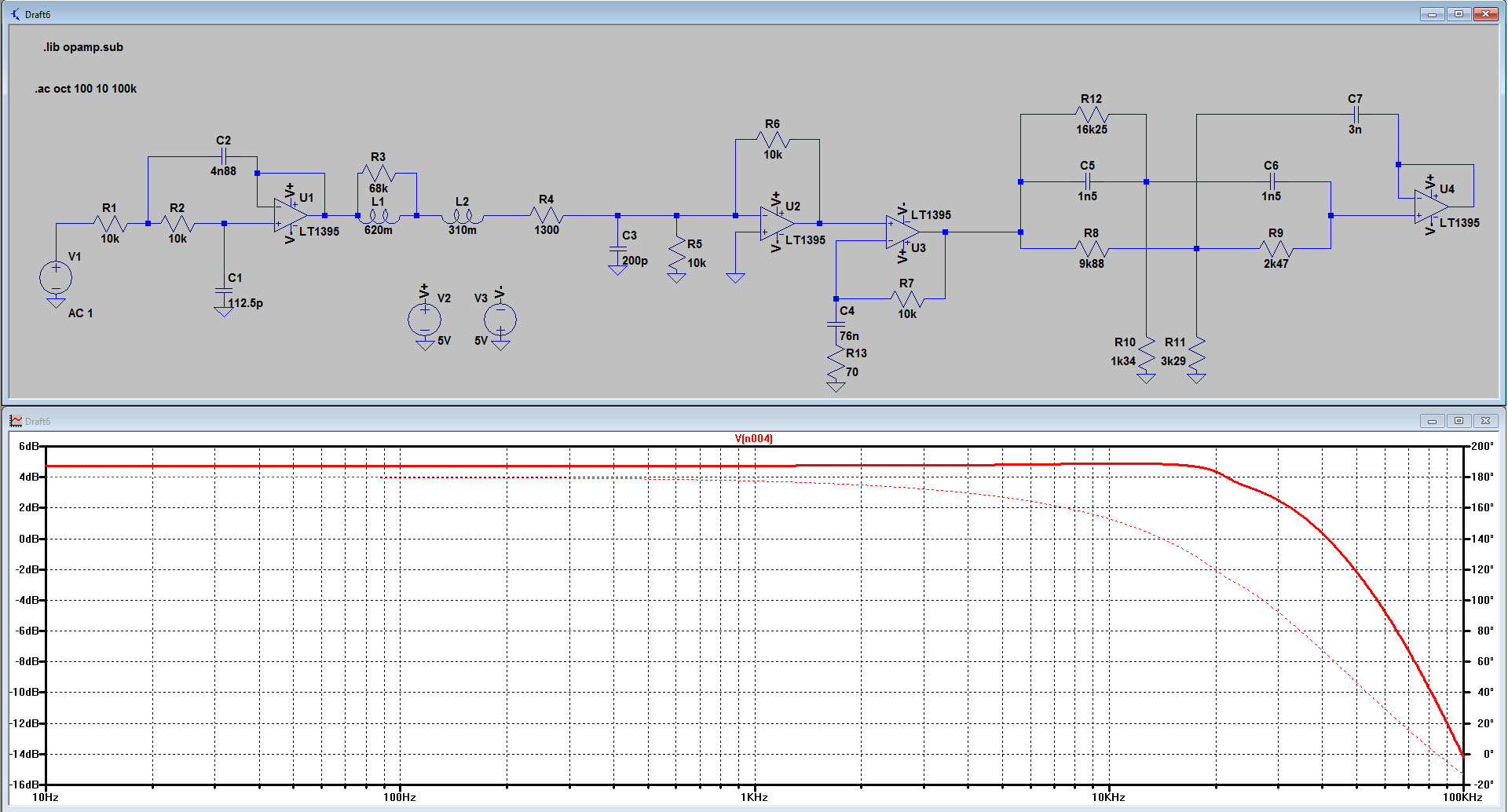

In order to keep some links together It was just pointed out to me that one of the earliest references to a damped loading was the Barney Oliver amp of 1973 http://www.hparchive.com/Manuals/Barney_Oliver_Amplifier_Manual.pdf
I also found this blast from the past. With a few tweeks would be a good candidate for a flat pre to 2kHz. LD is like the easter bunny hiding this stuff around the web 🙂
Ah, the best kept secret of all: transimpedance MM/MI loading.
Barney Oliver's stuff was great, and the tribute op-amp version is true to the spirit of that discrete preamp. It's pretty demanding of gain-bandwidth; that's how I ended up with the 'exotic' op-amp - it's necessary. There's a typo in your post, Bill - you mean 20kHz of course!
All my MM/MI pre-amps are true transimpedance these days: they present a true short circuit as a load. I came up with a very tidy circuit that takes care of the wrong LR time constant arising and converts it to 75uS in the 1st stage, whilst conserving true transimpedance loading. That is also demanding of gain-bandwidth in an op-amp, if one ever needs a genuine excuse to go exotic. I also did a valve version, using 2 stage rf pentodes, which I am particularly fond of............

Yes, that is the definitive and final 'Barney'. A tribute to Barney Oliver's discrete transimpedance circuit, done with an op amp.
It's not for the fainthearted, and neither was Barney Oliver's original, because the amplifier requires high gain-bandwidth so is essentially an rf circuit and rf rules apply.
Barney Oliver's circuit presents an impedance to the cartridge so that the cart's inductance provides the 75uS pole. So isn't true transimpedance.
A different circuit called 'Aurak' goes one further, and loads the cartridge with a true short circuit; fixing the wrong LR time constant arising in a cunning way. Aurak is the concept which evolved from sketches into something quite special, but AFAIK, only early versions, if any, survived the purge.
So there are two separate circuits : Barney is a tribute to Barney Oliver's 1973 discrete circuit. Aurak is a true transimpedance MM/MI preamp circuit.
So far, I think, you've only uncovered Barney..........
Both are improvements on standard loading, Aurak is the better IMO. Suppose I would say that.........!

Don't we have enough to start? True transimpedance means a good false summing input to me, now just figure out the equalization right? I would start with an AD745 which is decomped and then start worrying about the inevitable oscillations. 😉
