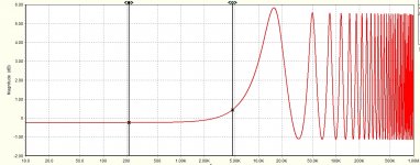

And not due to generator's natural roll-off, badly implemented RIAA which keeps rolling, cut-off on the test record etc etc.Basically we are looking for any evidence of roll off greater than second order at the high end that might be due to something other than the LCR response of cart and phono stage.
Unfortunately many things can mimic a steep monotonic roll-off over the limited frequency range of interest. More positively, I think what one is looking for as a signature is a sign of 2nd resonant peak that arises naturally in the TL model, but not the spring-mass model.
Here's a rough plot of TL resonant series, with no losses, a sort of spherical cow as to what the signature should resemble. Hope this makes sense. You can see that within this series there exists steep 'roll-offs' if one examines only a limited f range, say just above the 1st resonance.
It's probably such resemblance that might have supported historic lack of inquisitiveness as to what doesn't fit, especially at ultrasonic frequencies, and especially as to the 2nd or 3rd peak/inflections, IMO.
IIRC, mechanical response was obtained by subtracting observed response from theoretical LCR response, which IMO is a good start, and probably indicates correctly the mechanical resonant frequency, well the 1st in the series anyway. Many other factors complicate the ultrasound response, as above, and the cut-off could be anything I think. But perhaps the best about ? I suppose I would say that......😉!Next up https://sites.google.com/site/zevaudio/turt/cartridge-comparison-list/shure-1000e. not this is an M97 SAS stylus on a 1000e body. Now in this case the does appear to be a steep roll off , but as nothing posted on the test methodology could be 44.1kHz sampling rather than the claimed mech resonance.

For clarity, I don't mean that this Shure cart, nor the stytlus variants, is the best there is ! I mean that Zevaudio's approach to analysing mechanical resonance is the best I am aware of, warts and all.Only concern is the SAS is boron rod with an ultralight Namiki microridge, same as AT use. How (or why) did Jico end up with this. Doesn't bode well for the sapphire version which is a shame.
On the face of it, this cart/stylus, as presented there, has a resonant f in the audioband. For reasons discussed previously, this may not be uncommon, but I think it's better for the resonance to be above the audioband and clear of programme content.
Perhaps the move to boron was associated with moving resonant f out of the audioband, but presumably the original had a design intention associated with placement in the audioband, if the face value measurement is right ? Perhaps to prop up generator hf response, that seems common enough?
I wonder how much is design and how much is empirical, in general.

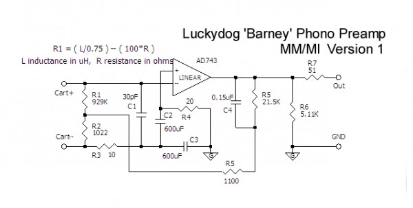

OK lucky GB and USA guys,
I am a bit lucky too to understanding Dutch a bit
but I could not understand from the text what should be R1 resistance to get right electronic damping at the input and right falling the correction curve...
Do you know the formula?
R1=4500*Lcart
With Lcart is 600mH, R1 becomes 2700 Ohm.
Thank you!
fpr AT440MLa with Lcart=490mH
R1 should be 4500*490mH=2205 Ohm = 2k2
is this correct?
is this correct?
Thank you!
is this correct?
Yes, assuming a 100pf cable capacity from TT to preamp.

In order to keep some links together It was just pointed out to me that one of the earliest references to a damped loading was the Barney Oliver amp of 1973 http://www.hparchive.com/Manuals/Barney_Oliver_Amplifier_Manual.pdf
I also found this blast from the past. With a few tweeks would be a good candidate for a flat pre to 2kHz. LD is like the easter bunny hiding this stuff around the web 🙂
