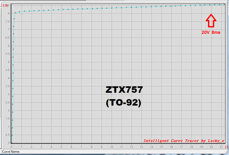

Perhaps that means the ZTX757 is even better than the attached curve. Which would be nice.
Zetex specifies Theta-JA = 175 deg C per watt for the "E-Line" TO-92 thanks to its use of zippety doo-dah silicone epoxy. That Theta-JA is 12% lower than Fairchild's spec of Theta-JA = 200 deg C per watt for their regular old TO-92.
