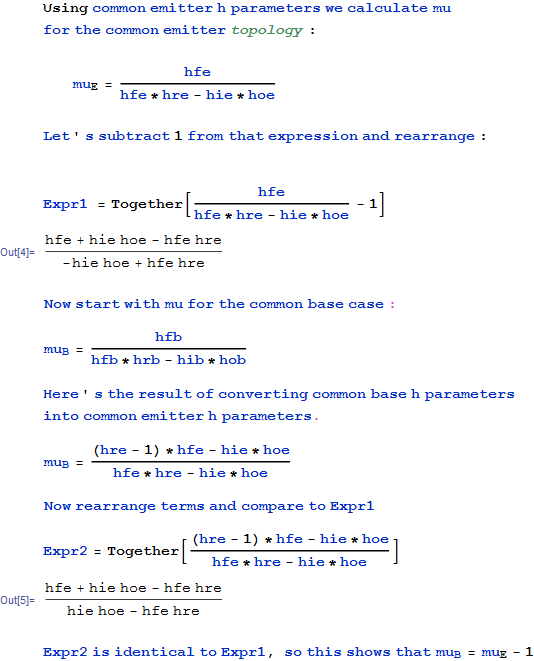

How did you get mu=((hrb-1)*hfb-hib*hob)/(hrb*hfb-hib*hob) ?
Since mu is the voltage gain of a common emitter stage, when you're deriving mu from the common base h parameters, it's necessary to convert those CB h parameters to common emitter h parameters first, then convert to ABCD parameters. Doing all this should get the expression you're asking about.
Now I understand. If you look at the exact formulas for the voltage gains of CB and CE amplifying stages, they are practically identical. The approximate formulas are identical and this means the mu's of the CB and CE amplifiers are practically identical and thus Hrb and Hre are practically identical. That is what Bob Pease stated. You really don't need to perform all those calculations. Note. I am using the book, Reference Data For Radio Engineers by ITT.

This is true and it can be shown that the gain for the CB stage is equal to the gain for the CE stage minus 1 (possible neglecting signs). Since gains are usually >>1, this verifies that they are "pratically identical":
The part in red doesn't necessarily follow. Testing it with typical numerical data for CB and CE h parameters would be informative.
The numerical CE h parameters I referenced in post #36 don't support the supposition that mu for the CE case is nearly the same as 1/hre.
I think this can be seen from the exact expression for mu for the CE case:
hfe/(hfe*hre-hie*hoe)
This can only equal (or be close to) 1/hre if the value of hie*hoe is negligible compared to hfe*hre. For the parameters in post #36 it's not true.
Can you find some numerical values for h parameters and compare the exact mu with 1/hre?

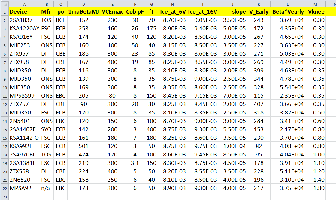

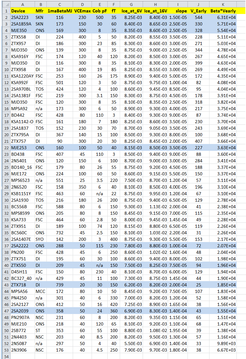

I added measurement data from a few more PNP transistors; mostly they are devices I learned about when reading this diyAudio thread. The new devices are shaded in blue.
_
_

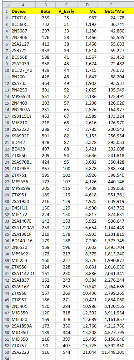

I calculated Bob Pease's "Rule Of Thumb" from his Electronic Design magazne article linked in post #27 above.
His rule is that (Beta times Mu) is about two million; in some cases one, other cases four. I tabulated that number below. Remember, these are PNP discrete transistors. Click on the funny "X" in the lower left corner of the image, to magnify it up to full size for good readability.
_
_

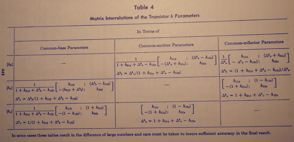

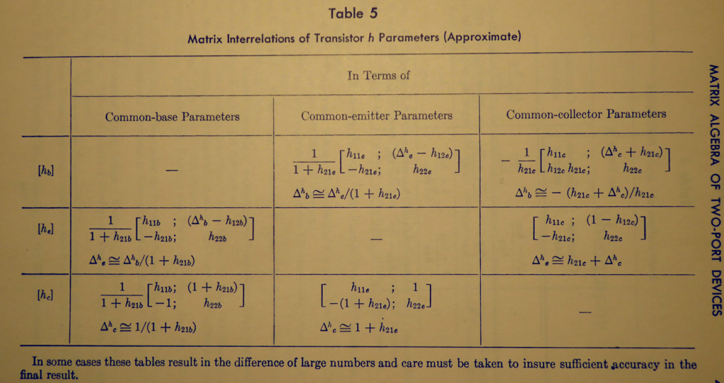

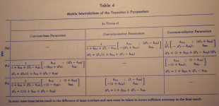

I got back to my reference books to look for the table of interrelations between h parameters for CE, CB and CC topologies.
These are not easily found. What is easy to find are tables of interrelations between various parameter types, such as Y, Z, H, ABCD, A'B'C'D' (also known as abcd), S, etc., but not between the three BJT topologies within one parameter type.
I found a good table in an old (1957) book, "Transistor Circuit Engineering" by Richard Shea.
Here is the table showing the exact conversion expressions:
Here is the table showing approximate conversion expressions:

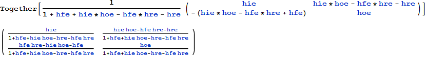

I've taken the CE to CB conversion matrix and rearranged it using Mathematica:
Showing it as the exact conversion from CE parameter matrix to CB parameter matrix:
As rayfutrell mentioned in his post about writing Fortran conversion routines, some of the various conversions have the same form.
The one shown above has that property. The conversion shown converts CE parameters to CB parameters. If one just changes all the CB parameter names to CE names in the left side, and all the CE names to CB names in the right side, the result will be the exact conversion from CB to CE h parameters. In other words:
These look complicated, but I program them into my HP50G calculator. This calculator can do matrix arithmetic, so I just type a CE h parameter matrix into the calculator, press one button, and it's converted to a CB h parameter matrix. This is very handy when doing calculations with a matrix of parameters.
This is the conversion I used to convert the CE h parameters I found on the Internet to CB parameters.

I mentioned my goal in post #1 of this thread:If Mark is looking for "maximum voltage gain", he need only find the highest Early Voltage of his PNP parts, and almost certainly find a similarly high NPN part to feed it DC without decreasing output node impedance much.
My final device selection, and my decision criteria which led to the final choice, are laid out in post #34 of this thread.I'm building current sources and current mirrors that run at about 8mA of bias, and trying to decide which device types to select. Among the criteria I have considered, is the Early Voltage (SPICE parameter "VAF"), which determines the output conductance, the "flatness" of the Ice vs Vce curves.

Beta-VA product is a nice figure of merit and leads to some quick rules of thumb. The 50's era horrifying maths are good to know but sometimes are too big a hammer.
If you want to win the game: cheat.
In this case, you can maximize the (Beta * Vearly) figure of merit by using a PNP transistor with infinite Beta, namely a BS250 P-channel MOSFET. It has a pretty good Vearly too: about 300 volts (!). Predictably, the standard MOS modeling equations use their own, different formulation which omits Vearly and installs Lambda instead. Ain't life grand.

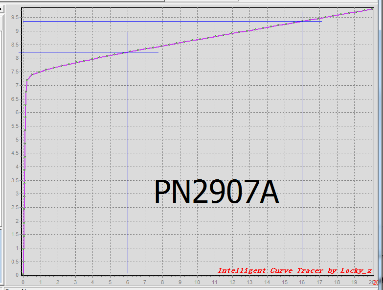

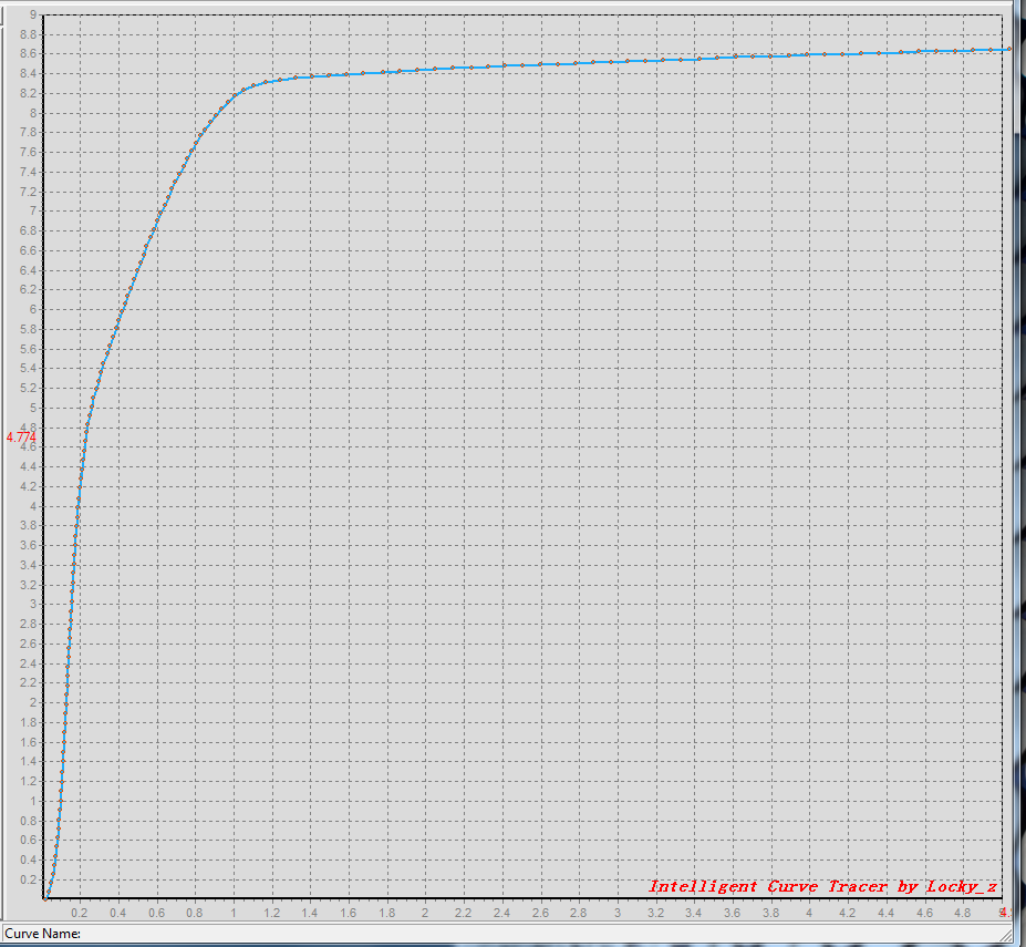

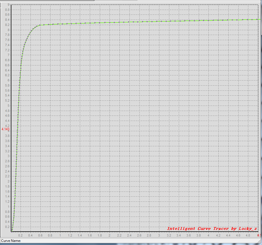

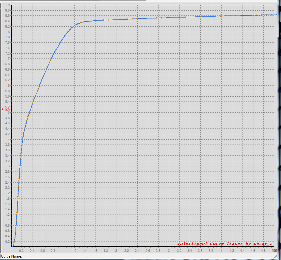

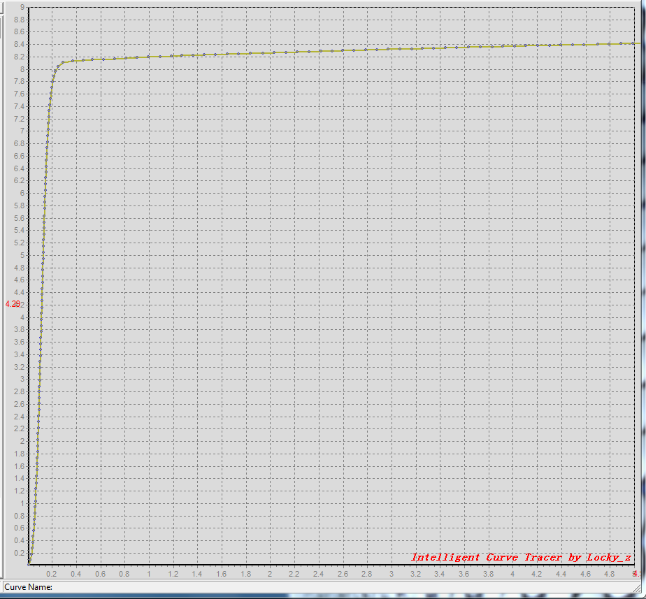

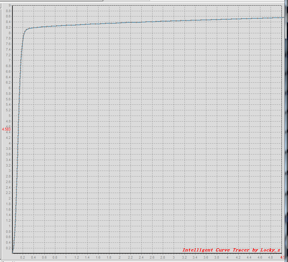

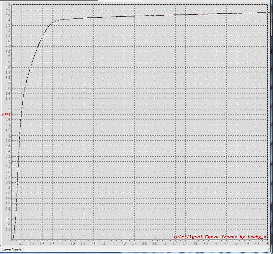

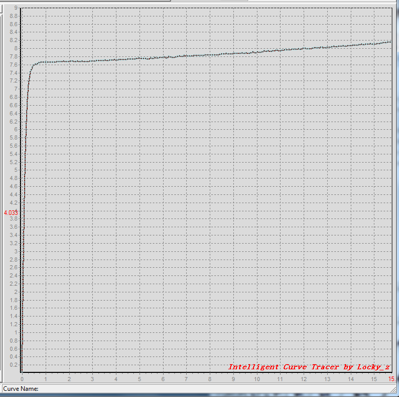

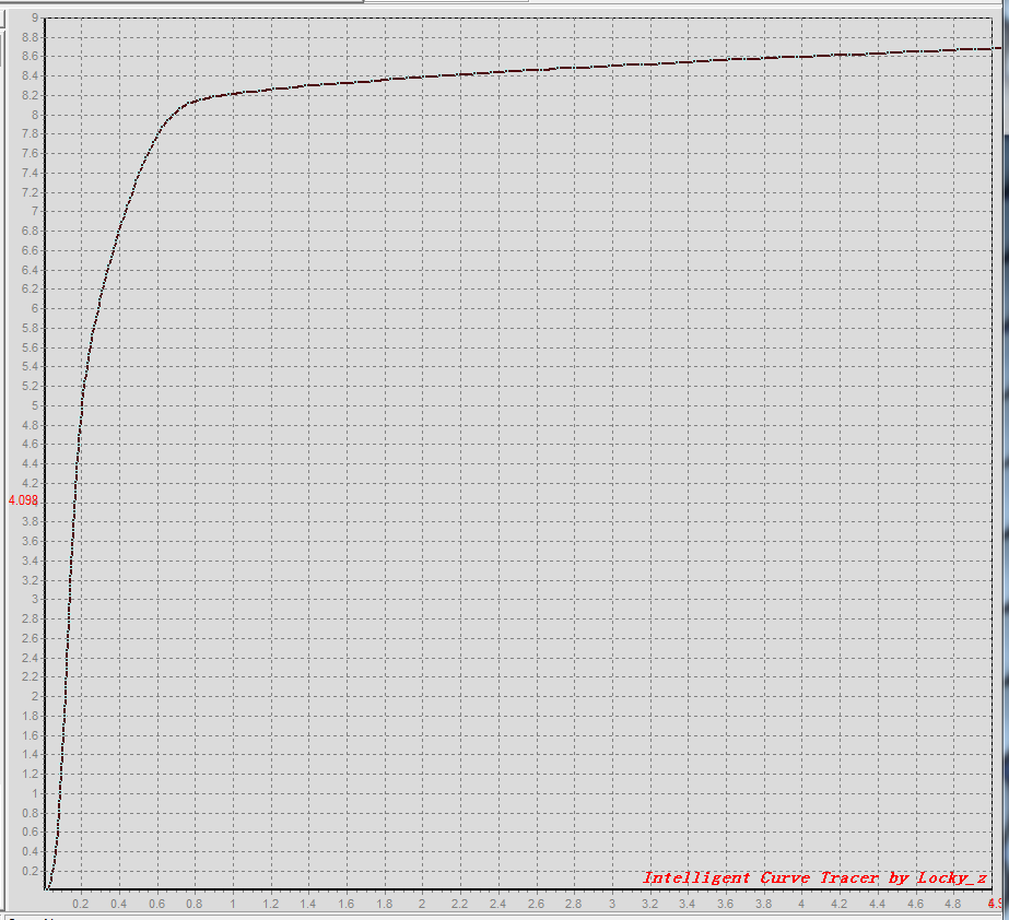

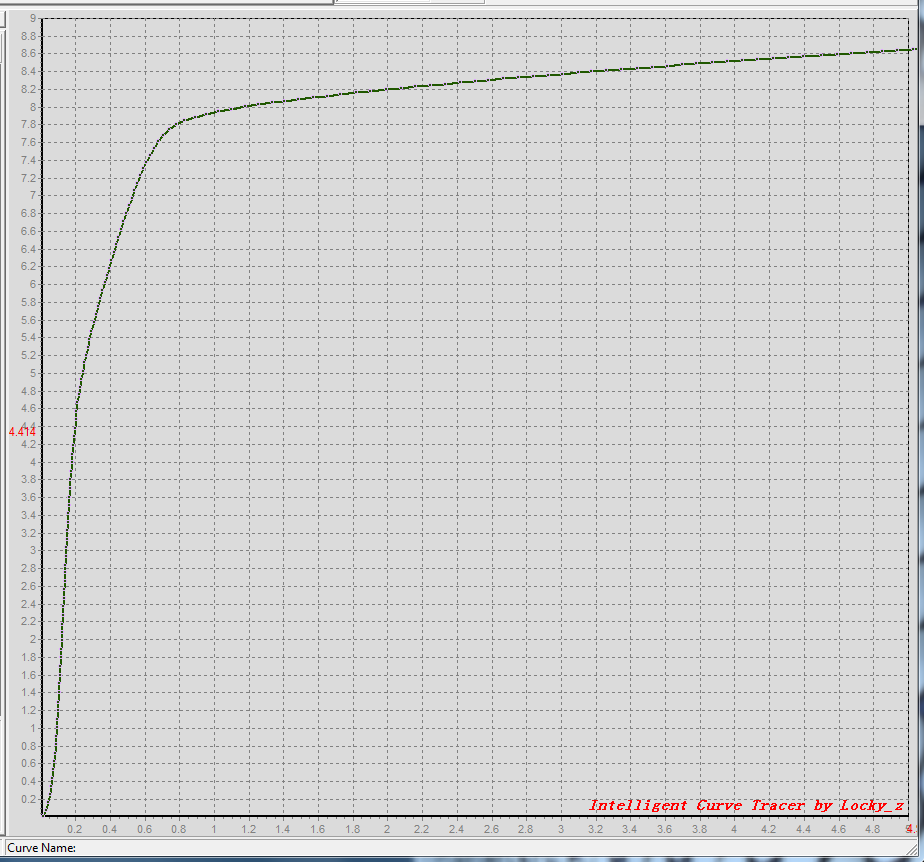

...Here's a spreadsheet... And a few raw curve tracer pictures too.
Thanks for the information, I have a small query about the data.
The spreadsheet seems to be rounded to 0.05 mA but the curves appear to show better resolution than that, why the apparent inconsistency?
Best wishes
David

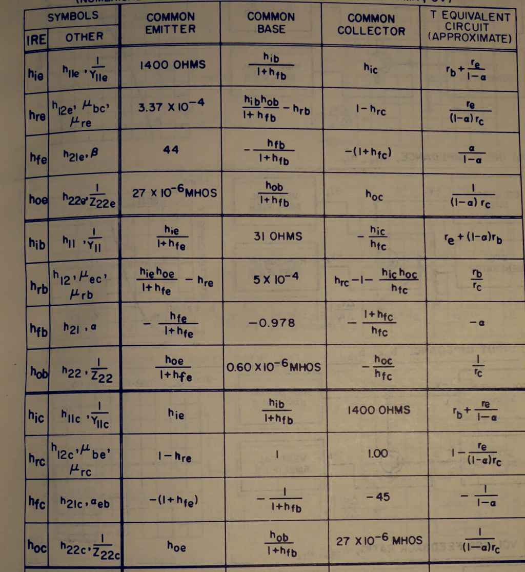

There seem to be two issues here. Whether 1/hre is nearly the same as 1/hrb is one. This question could be compromised by cancellation errors in the formulas for conversion from CE to CB parameters. The other issue is whether -1/hre is a good approximation to mue. This question doesn't involve CB parameters at all, and cancellation in the conversion formula isn't an issue. Using 15 digits in the H to ABCD conversion removes possibility of cancellation errors there.
I was only able to find one place where both CE and CB parameters for the same transistor are given. That was in the classic General Electric transistor manual. In the revised seventh edition can be found the following table, which unfortunately is for a germanium transistor:
The given CE h parameters are:
hie = 1400
hre = .000337
hfe = 44
hoe = .000027
Converting to CB h parameters gives:
hib = 31.1
hrb = .0005027
hfb = -.9778
hob = .0000005997
which matches the CB data in the table quite well.
Calculating mue using the H to ABCD method gives mue = -1915
Using -1/hre gives -2967, not a good approximation to -1915
Calculating mub using H to ABCD gives 1916, as expected.
Using 1/hrb gives 1989, a reasonably good approximation to 1916
Here hre is somewhat close to hrb, but the -1/hre approximation to mue doesn't work well.
Perhaps Pease was applying to specialty transistors, such as super gain BJTs. Perhaps he didn't mention it in his article because it's not as good an approximation as 1/hrb.
Because I read off the (I, V) datapoints by eyeballing the plots, and my eyeballs aren't infinitely precise. Take for example the PN2907A shown below.The spreadsheet seems to be rounded to 0.05 mA but the curves appear to show better resolution than that, why ... ?
My eyeballs say that at VCE=6.0, ICE = about 8.2 milliamps.
My eyeballs say that at VCE=16.0, ICE = about 9.35 milliamps.
Those are the numbers I manually typed into the spreadsheet. Then Excel calculated the slope = (9.35E-3 - 8.2E-3) / (16 - 6) = 1.15E-4 mhos. Finally Excel solved the linear equation
- slope = ICE / (VCE + Vearly)
When eyeballing the plots and typing in the data, my visual acuity may have been improved by the administration of a Glowing Pearl. Or at least, modified.
The less-than-fully-precise values of Vearly given by this informal procedure, were good enough for my purposes. If you need Vearly with greater precision, you'll need to come up with a different extraction procedure + test fixture. Or you can just use the Vearly numbers tabulated in Art Of Electronics 3rd edition, Table 8.1, page 501, and hope+trust they are correct.

I noticed that some of the PNPs with highest Early voltage, also had an uncomfortably large "knee voltage" where the ICE vs VCE curve flattens out. So I measured the twenty highest Vearly transistors again, zoomed in around the knee voltage. Here's a table, sorted by knee voltage. 2SA1837 is (tied for) best, i.e., lowest knee voltage. MPSA92 is worst, i.e., highest knee voltage.
Hover your mouse over the image to read the filename / transistor type.
_
_
- Measuring the Early voltage "VA" of some PNPs at 8mA
