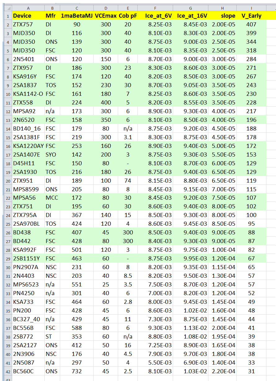

I added several more PNPs to the table today, new entries are marked in green. Sanyo lovers: your favorite is found in row #17.
When there was no "Cob" listed in the tabulated information in the datasheet, but there was a "Cob" graph, I chose the lowest-voltage datapoint (with the highest Cob) to enter into my table. Perhaps this is more pessimistic than the measurement point used by other transistors. But if they don't even spec it, should I even try to tabulate it? Hmm.

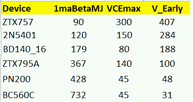

Beta and Early are inversely related (as I'm sure you observed).
Not an exact proportion for all devices. ZTX795A seems to be a happy design.
Beta and VCEmax "should" be related as square-root of Beta, for some idealized geometry (AS Grove). The root relation is not clear in your data. Possibly real geometries, possibly geometry and specs tweaked for different intended markets.

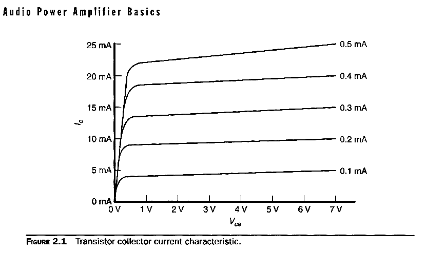

What is the meaning of this "early voltage", and how and where it is important in an audio circuit..??
Wikipedia has an article that discusses the Early voltage.
Bob Cordell's book also covers it. I've copied the very first mention (on page number 19 of a 600 page book!) below.

Added three more rows (transistor types).
Added a new column: Beta x Vearly figure of merit, and sorted the data by this F.O.M.
Found additional sources of information that let me update several "Cob" entries.
The Sanyo device that Bob Cordell's book is so enthusiastic about, finishes 31st best out of 44 transistors according to this F.O.M. Which in a way is probably a good thing; this little exercise has identified 30 transistors that are even better than the 2SA1407E.

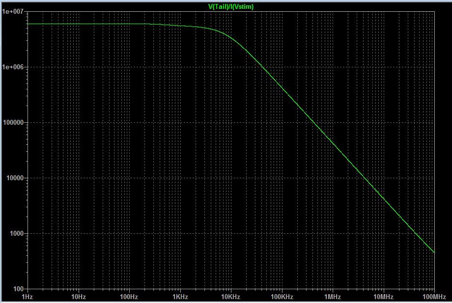

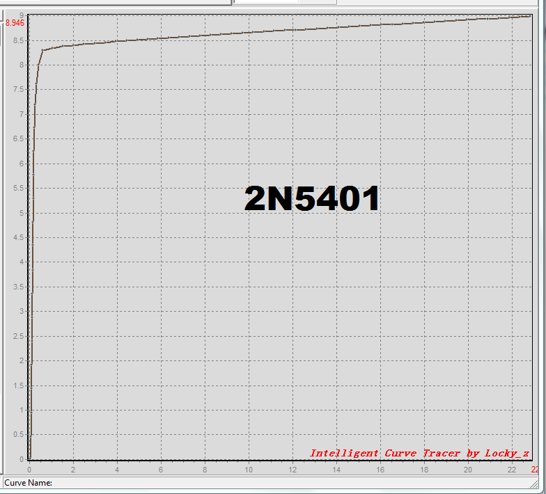

After staring at the data for a while, I chose a cascode combination: PN4250A for the "inner" device (the one whose VCE is fixed and constant thanks to cascoding), and 2N5401 for the "cascode" device (the one whose collector sees all the signal swing).I'm building current sources and current mirrors that run at about 8mA of bias, and trying to decide which device types to select.
Since I don't want the current source to gobble up tons of supply headroom, I'm operating the inner device at relatively low VCE: 1.25 volts. I decided that means I want an inner device whose "knee" is well to the left of (1.25V @ 8mA). The PN4250A seems to do this quite effortlessly, while having a relatively high Beta (300) and low Cob (6pF).
I wanted a cascode device with high Early voltage, decent Beta, low Cob, and good IV behavior at low VCE. The 2N5401 seems to fit the bill.
LTSPICE simulation says this cascode current source has an output impedance of about 6 megohms at midband, which is more than good enough because the input impedance of subsequent circuitry is a lot lower.
Now to lay it out!

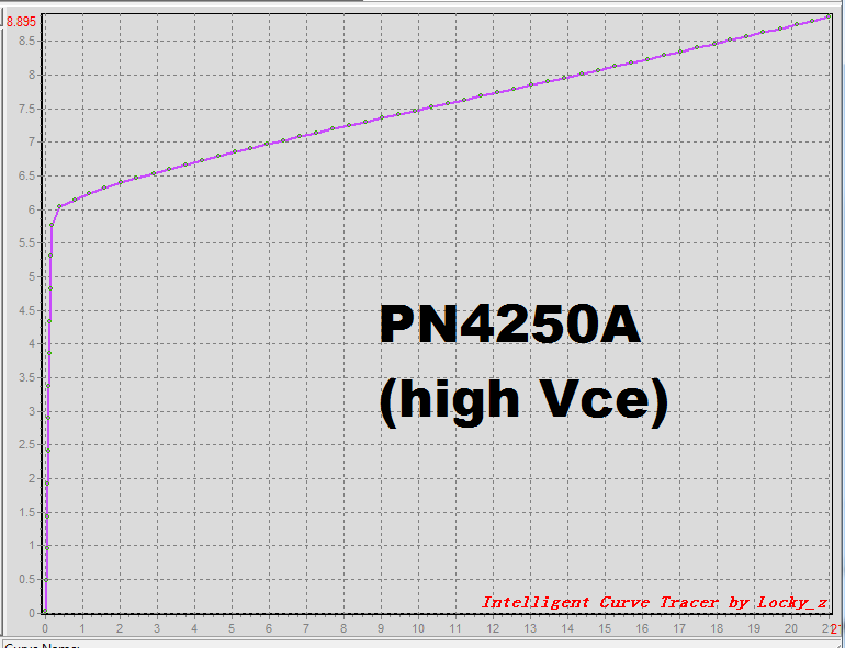

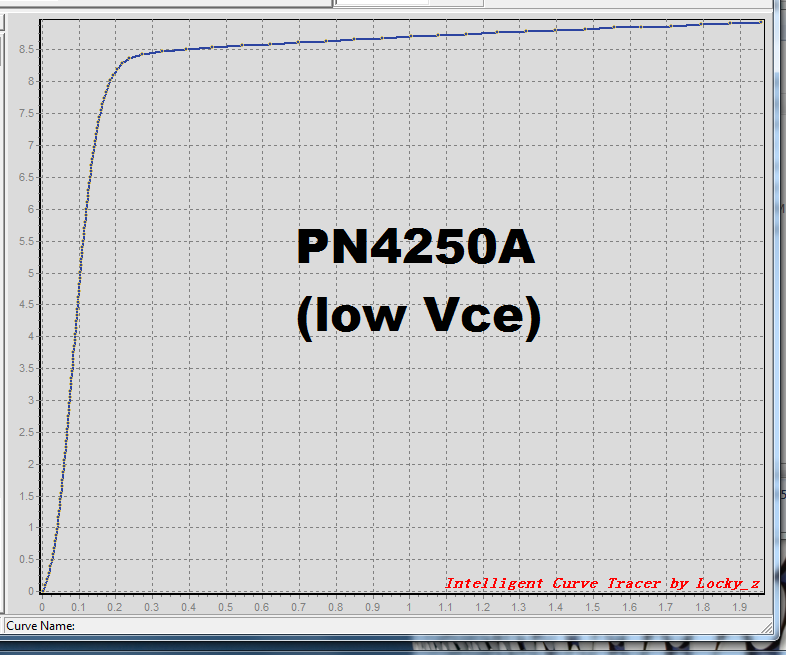

- Measuring the Early voltage "VA" of some PNPs at 8mA
