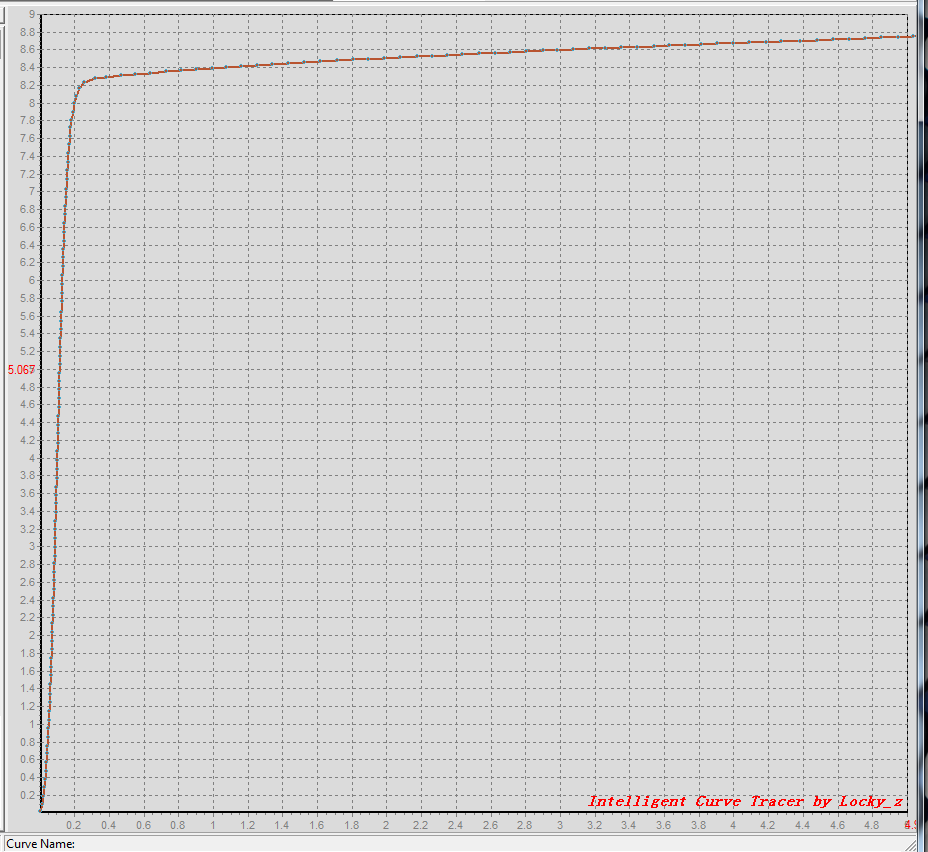

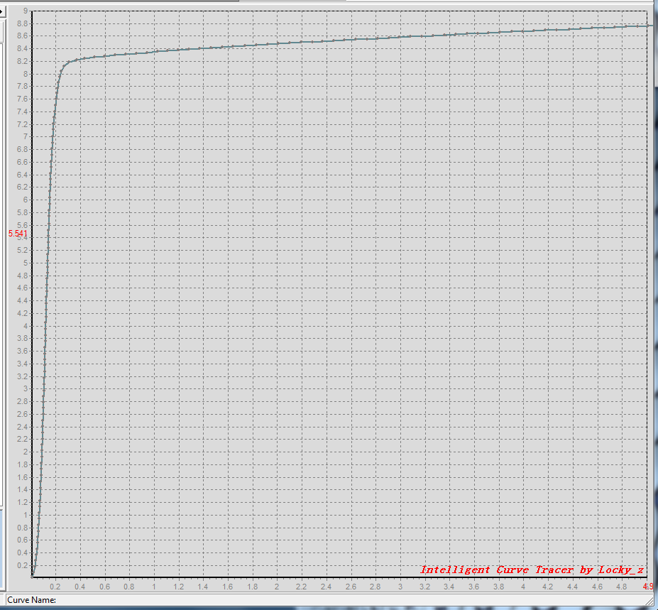

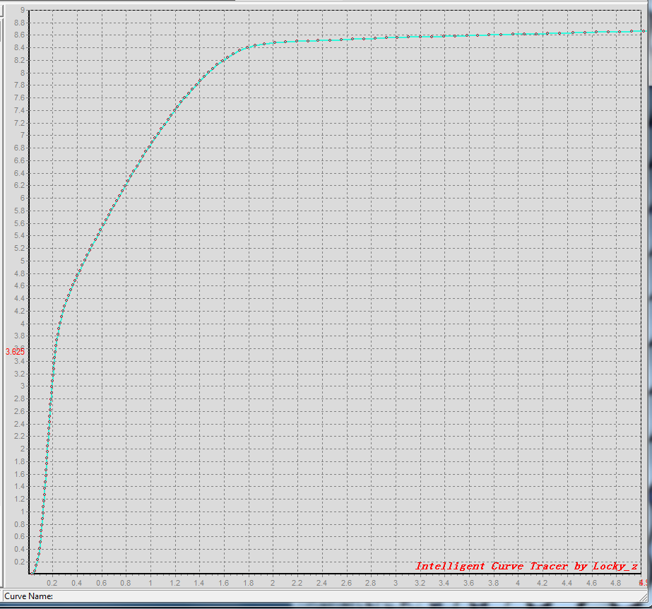

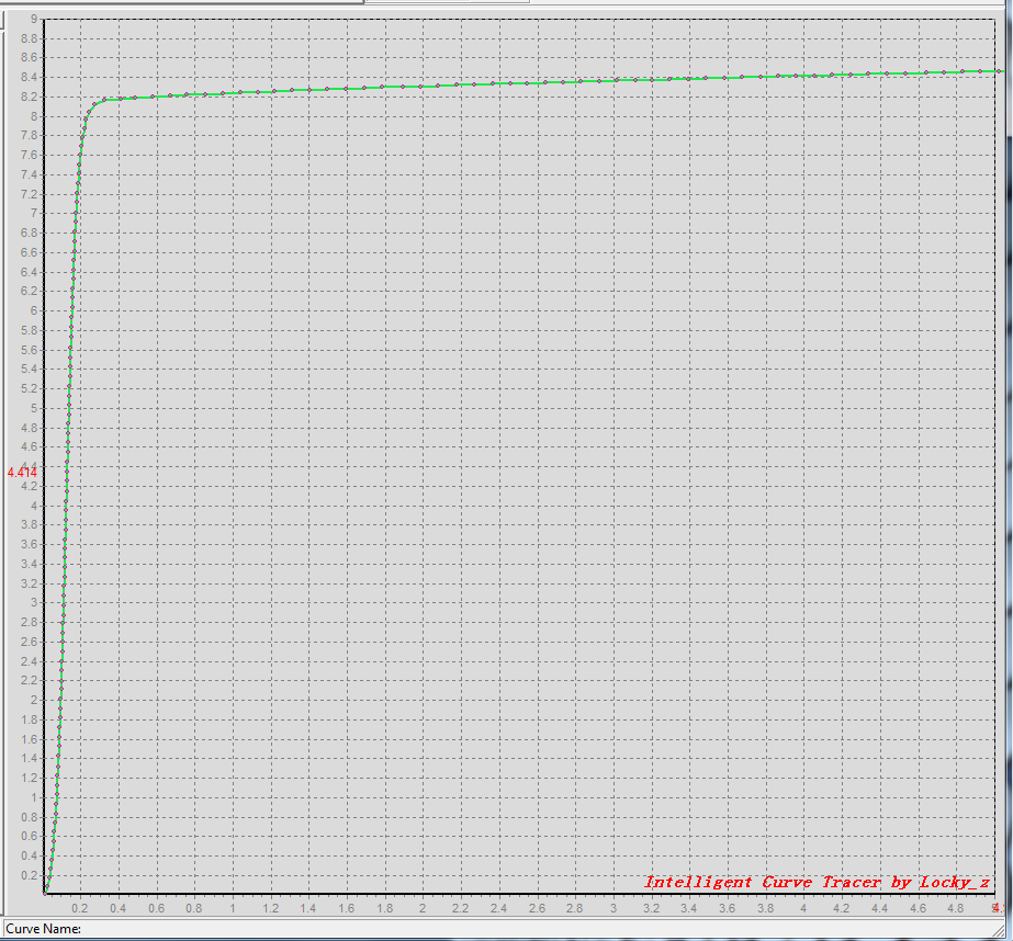

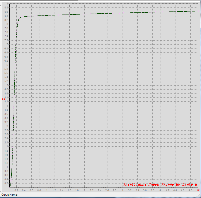

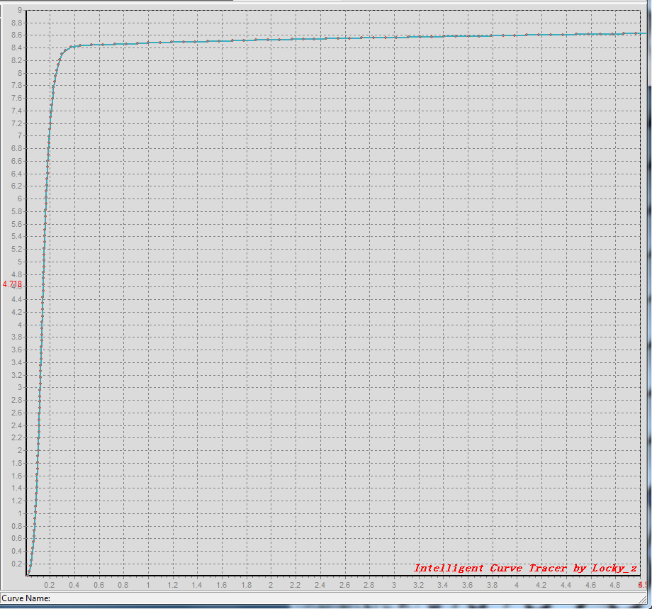

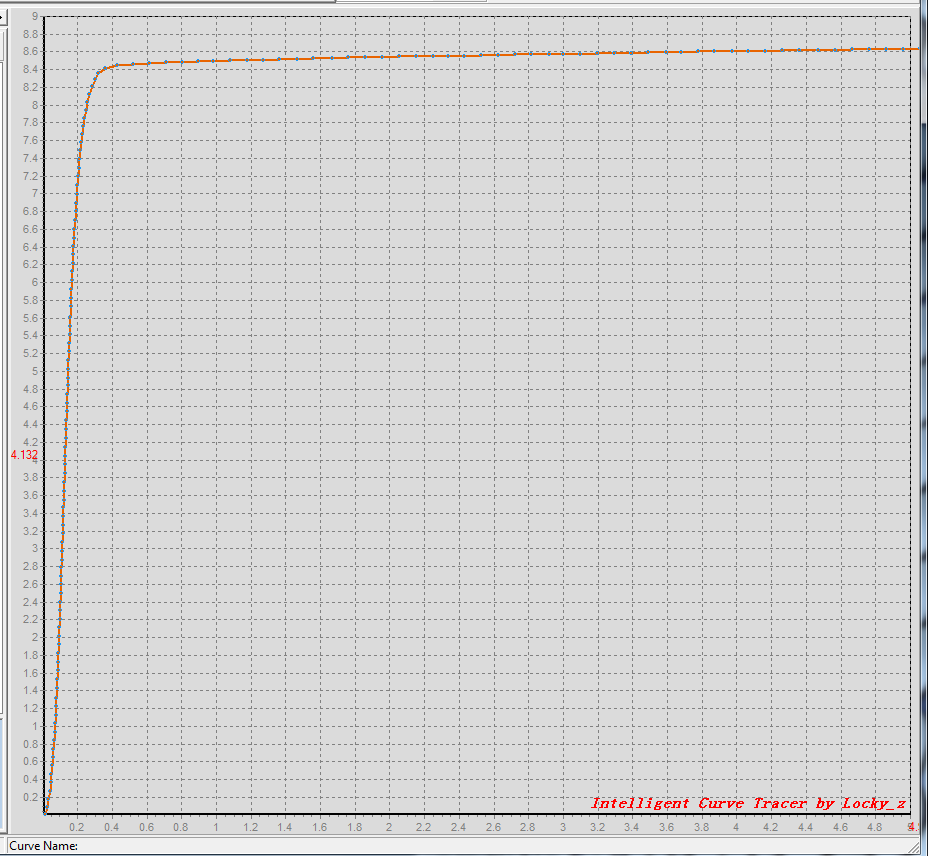

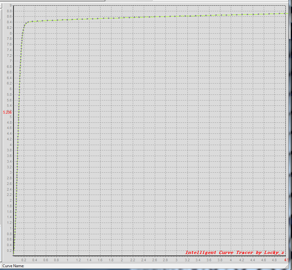

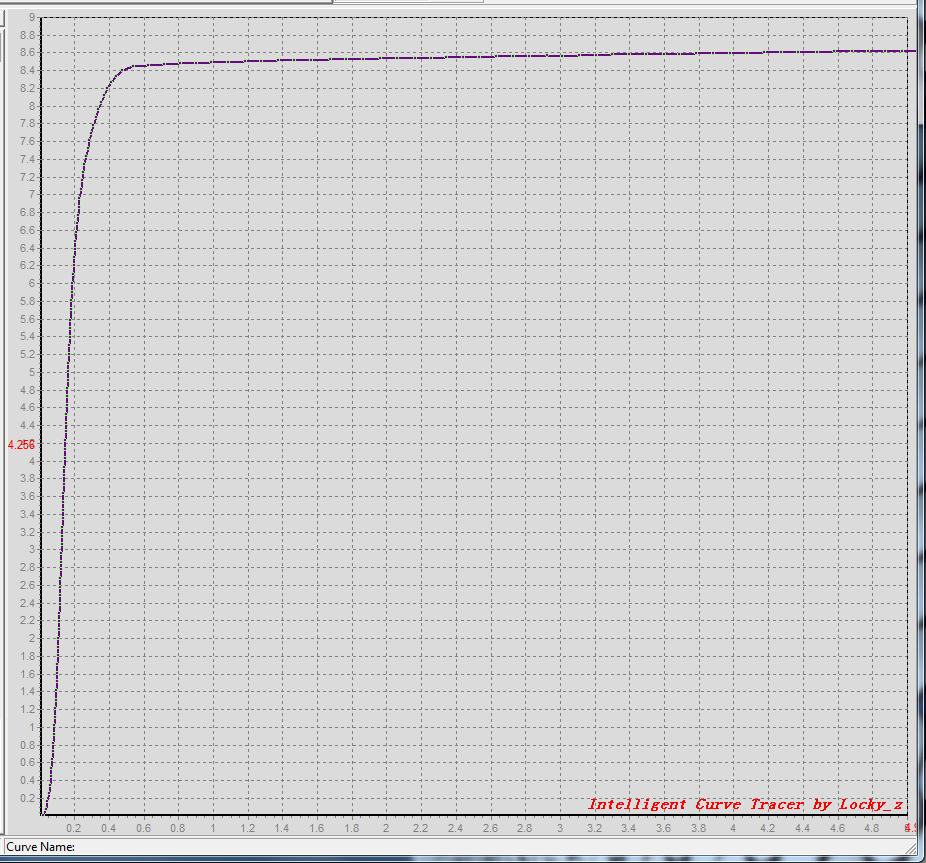

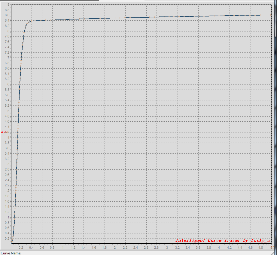

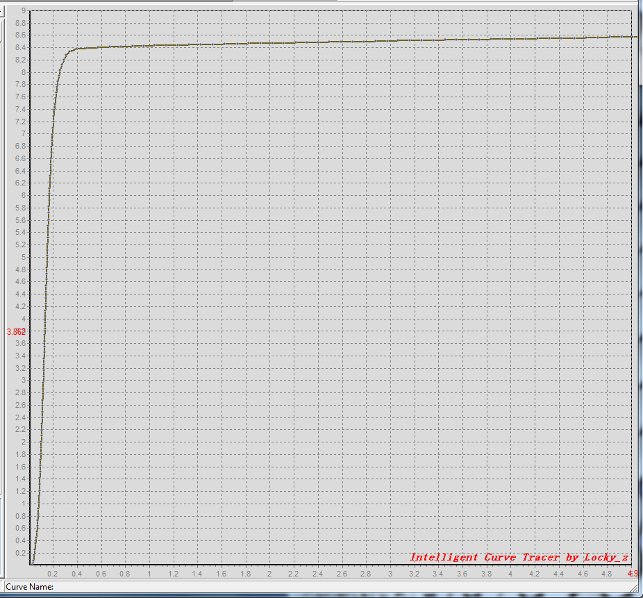

More plots of knee voltage.
_
_
Because I read off the (I, V) datapoints by eyeball...
OK, thanks for the clarification, I just wanted to have some idea of the accuracy and resolution of the data.
Your top rated transistor has a difference in Ice of only 0.15 mA, so that's only 3 of your 0.05 mA steps, and I worried about the quantization.
Even round off to the nearest step makes the result vary by 25% or more.
But eyeballs tend to do a pretty decent job of best-fit... subject to "Pearl" restrictions😉
Best wishes
David
So this is the fabled quasi-saturation. A bit of a warning sign for those using 2SC2240/2SA970 and the like as general purpose transistors at lowish voltages.

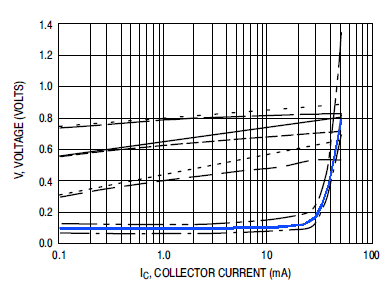

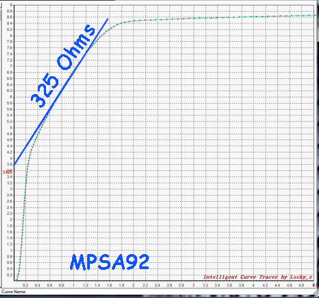

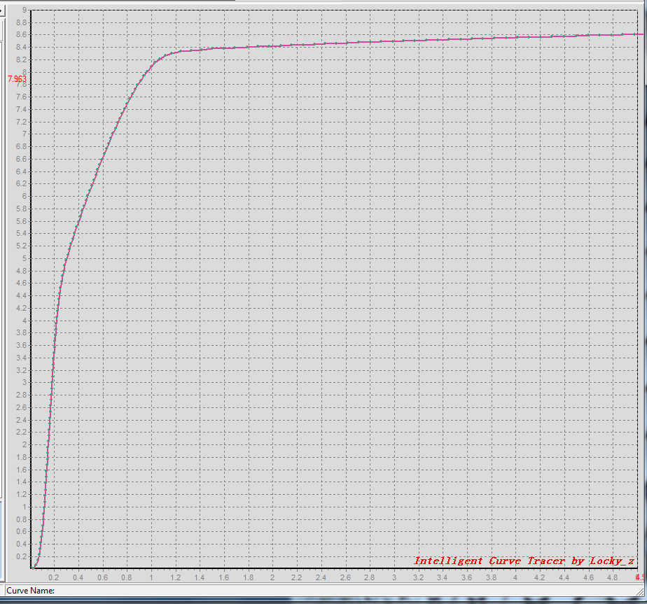

Well, MPSA92's "soft knee" looks an awful lot like a 325 Ohm resistor. See attached image.
And you can't sell a "1A" part if it has 300 Ohms inside. Probably has to be under 1r for a 1A part.
I'm skimming AS Grove for clues. I'm not sure if this is really 300r bending, or if it may be a base-resistance reflecting through.
Further tid-bit: MPSA is a High-Voltage part. That may lead to high resistance in the C-B area.
Also the ON Semi sheet shows severe fall-off or rise of hfe or Vce for currents over ~~30mA-- this is far from a high-current part. However their sketch of Vbe deviates a lot from what you actually measure, because they are forcing the Base current far past the "linear" range you explore.

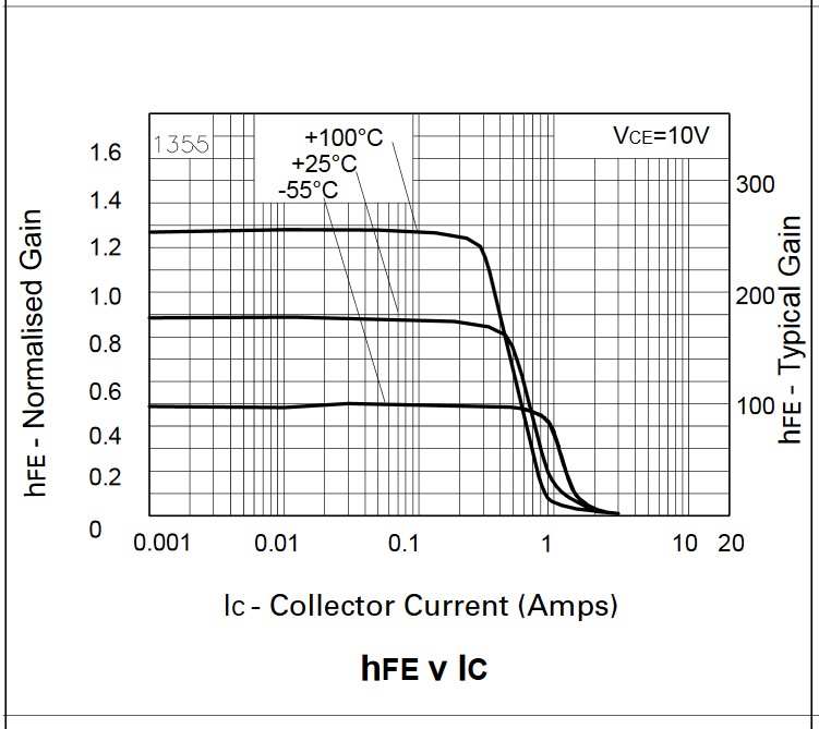

Yes the ZTX958 (tied for "best", i.e., lowest Vknee) is also a high voltage device. RatedV = 400 volts, MeasuredBeta = 167, RatedCollectorCurrent = 1.5 amperes. The ZTX958's Beta vs Collector Current plot does not begin to defecate the bedsheets until collector current > 400 milliamps at room temperature (figure below). In my opinion the weaknesses and imperfections of the MPSA92 transistor are not shared by all of its high voltage brothers.

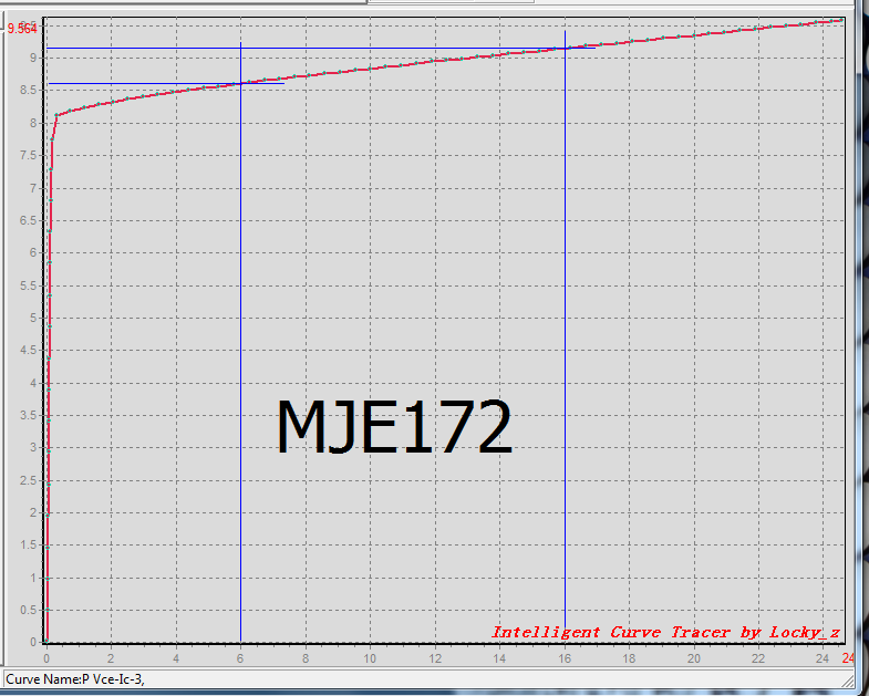

Wow, our measurements on the MJE172 transistor are very far apart. You got 30 volts and I got 150 volts! The device I measured was made by ON Semiconductor and purchased from an authorized distributor. Here's the plot, attached.
Maybe this means: If you need big Early voltage for a certain device in your design, measure the actual part and verify its Vearly before soldering it down. Undesirable for mass production, perfectly fine for DIY. It just adds more hobby hours to the build and, by definition, hours spent on a hobby are enjoyable hours.

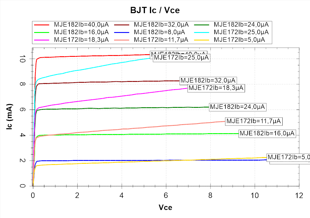

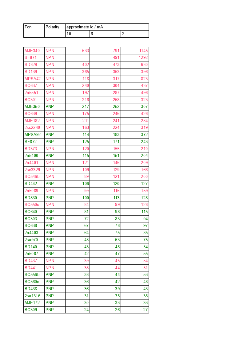

MJE172/182 traces
These are my traces of the MJE172 together with MJE182.
As you can see, these are very different indeed. I know that NPNs usually are (much) better than PNPs, but in this case the differens is vast.
Both are labelled as ON semi, but the "style" is different.
I wouldn't be surprised if your MJE172s were fake. Might be interesting to see whether they are up to spec at all (Ic, Vce, Ccb).

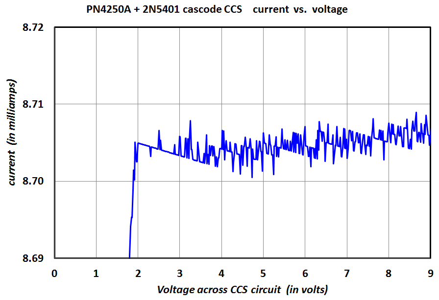

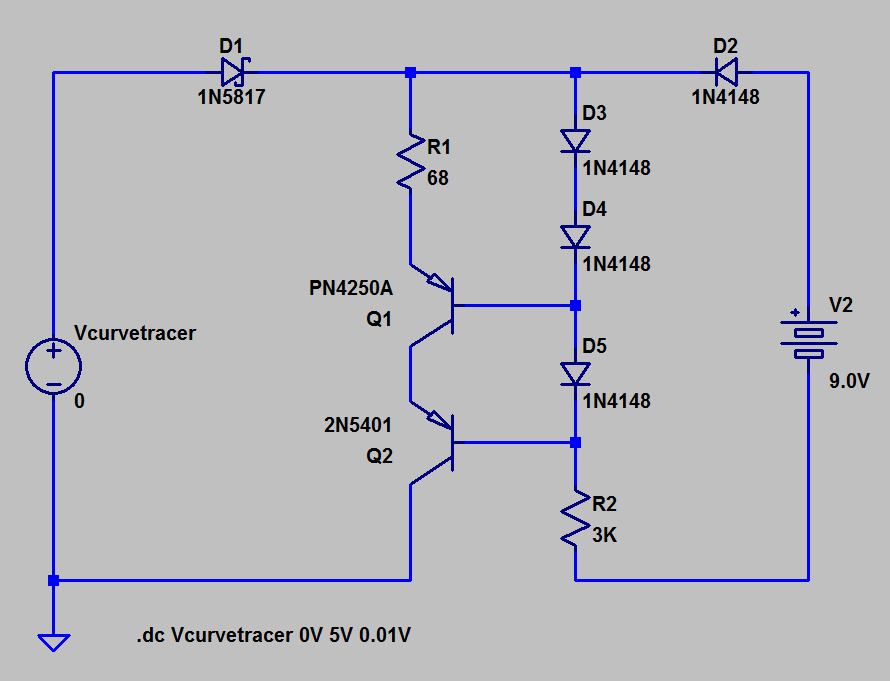

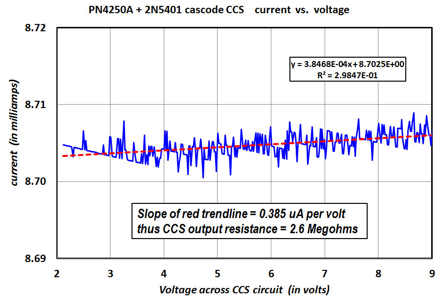

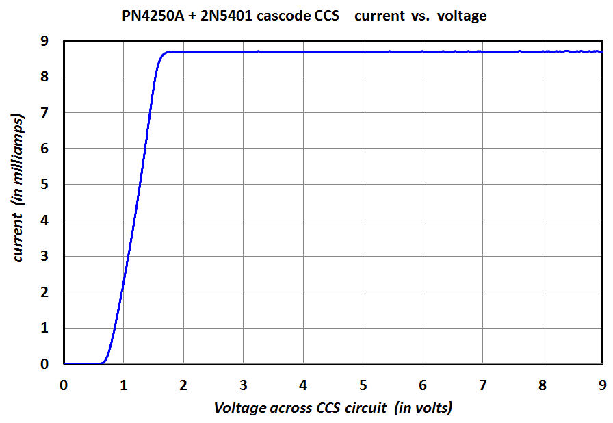

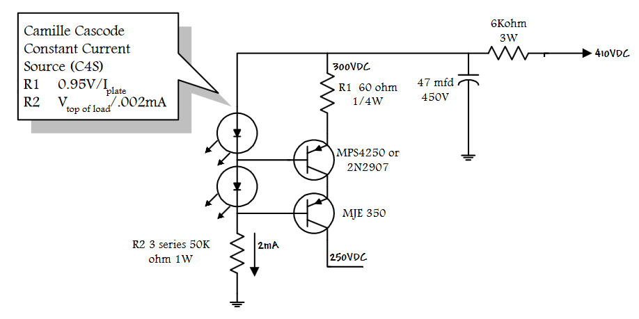

I decided to build up the cascode PNP current source from post #34, and run it through the curve tracer to see how flat the current vs. voltage behavior actually is.
As shown in the attached schematic, I'm running the bias chain (D1-D3 + R2) from a separate 9V battery, so the bias current is neither supplied nor measured by the curve tracer. Diodes D4 and D5 are paranoia / safety devices which try to prevent the battery from harming the curve tracer and vice versa. Notice that paranoia diode D4 will increase the apparent "dropout" voltage of the constant current source (but not the flatness). So I used a high current Schottky in that position, to keep the deltaV below 300 mV.
The I-V curve is shown in Figure 2 below. It's pretty flat, and the thing operates as a very nice current source at any voltage greater than 1.8 volts. I'm pleased!
Figure 3 shows a zoom-in of the flat portion; you can see that my curve tracer is not the world's most precise measuring instrument. Still, what the hell, let's try to estimate the slope (output resistance) anyway. That's in Figure 4. I asked Excel to fit a linear trendline to the data and got the dotted red line, whose equation is in the box. Excel thinks the current source's output resistance is 2.6 Megohms. This is similar, but not identical, to the LTSPICE simulated value of output resistance in post #34. I'm pleased!
I've attached a zipped archive of the Excel data if anyone wants to mess around with it.

Whoops, I forgot to compute the effective Early voltage which would give that same slope. Here we go:That's about 1.5x bigger than the product of the measured VAs of the two individual transistors: PN4250A_VA = 52, 2N5401_VA = 284. So the degeneration from emitter resistor R1 is helping a bit too. But remember that I measured VA at VCE=11 volts (midway between 6V and 16V), whereas this CCS circuit design runs the transistors at VCE=0.7 volts. Which is less.
- 8.7mA / (VA + 4.0V) = 3.85e-4 mA/volt
- VA = Early Voltage = 22593 volts
Not exactly; he was working with valves and hundreds of volts, so he used two LEDs to bias the PNP bases. I can't afford to lose that much headroom so I'm using three silicon diodes. My innermost transistor operates at VCE=0.65 volts (!). C4S runs its innermost transistor at VCE=1.70 volts.C4S CCS variation from John Camille?

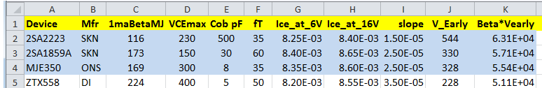

See column "B" in the final table (attachment to post #47), the tippity-top of which I copied below.After seeing how far parameters can change between manufacturers, I really see no point is making measurements without writing down at least the source company as well.
Because it's not a PNP transistor. The whole list (and this whole thread) is PNP only.You have the 2SA1859A, why not it's complement, the 2SC4883A?
