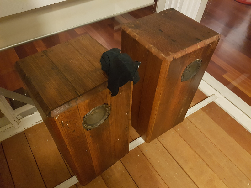

That's how I built the pictured boxes, mainly out of curiosity to try the impedance thing 🙂 It is another WAW*.
This prior build is why I'm now thinking along these lines - but bigger and better. I think I'd try stuffing the line for maximum attenuation, rather than a perfect impedance curve (unless those goals overlap - I'm not sure).
*...and it sounds fine, but was mostly built to use up some rustic materials. The enclosure is recycled floorboards. I used dowels as the nails. The back panel is ugly: there's the TL output, two 6.5" woofers and their (bass reflex) port. The visible driver is a dodgy looking but nice sounding TV speaker that I chose after the 105WK failed the audition.

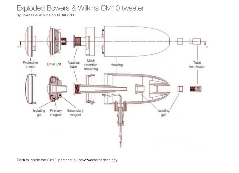

B&W Natilus approach works along these lines (when open ended, but it works as closed ended too with different stuffing of the line)
https://pearl-hifi.com/06_Lit_Archi...5_Bowers_Wilkins/B&W_Nautilus_Development.pdf
Exploded Bowers & Wilkins CM10 tweeter | Society of Sound
George
I use ¼ wavelength lines (shorter & open), B&Ws is ½ w/l

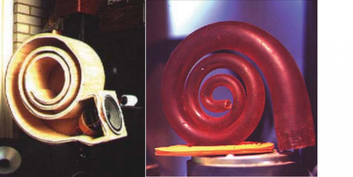

It would be an omission not to mention the (back loading) Cornu horn 🙂
George
I'd have thought designs like the Cornu or Hedlund horns (shallow, flat, no stuffing behind the driver) would reflect massively off the backwall of the cabinet.

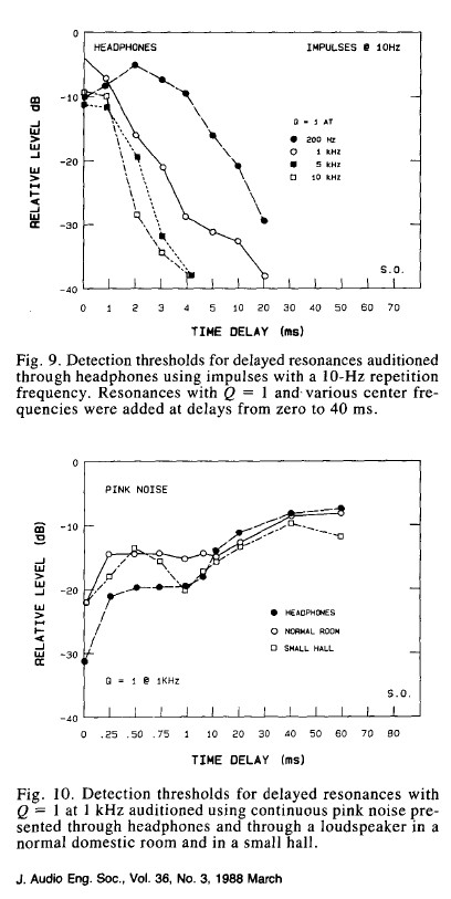

Lets keep in mind that below about 1 kHz (500 Hz certainly) the audibility of timing delayed aberration events falls off very fast. I would not think that foam would have any effect on LF devices. I try and control the diffraction only above about 1 kHz. I don't worry about it too much below 500 Hz.
The best paper I found on the topic was:
The Modification of Timbre by Resonances😛erception
and Measurement*
FLOYD E. TOOLE AND SEAN E. OLIVE
...and that seems all over the place. I found it unusually hard to interpret.
The info pictured here seems to agree with Dr Gedde's statement above, for sustained (pink) noise, but disagree for impulses, but I may be reading it incorrectly, or trying to compare apples to hedgehogs.
