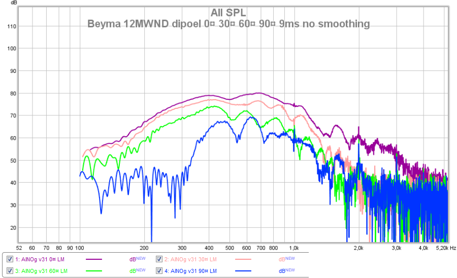

Where did this idea that OB baffles don't diffract come from? They certainly do diffract. The wave don't cancel at the edges, there is an enormous velocity gradient at the baffle edge. The pressure cancels in the plane of the baffle but there will still be a wave sent off from the edge elsewhere.
It is overruled by dipole cancellation - it must be because I can't see diffraction ripples in (off-axis) measurements, below dipole peak! A multiway dipole should be crossed so that each unit is lowpassed just above dipole peak, except the tweeter naturally.

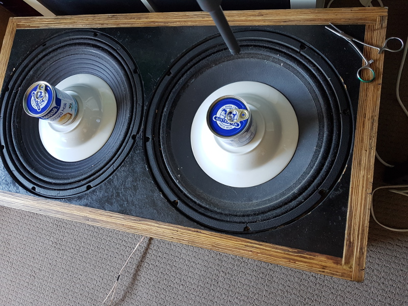

I did a few tests with an existing cabinet. This was built to satisfy many of the typical 'rules'
- good quality hardwood ply
- heavily built (all walls are double layer)
- well braced
- moderately stuffed
- airtight
All tests used the same volume settings and mic position
- mic suspended, 60 cm above a mini speaker
- mini speaker pointing sideways (90 degrees to the mic)
- I rolled off the lows to get a ~flat baseline (the free air test)

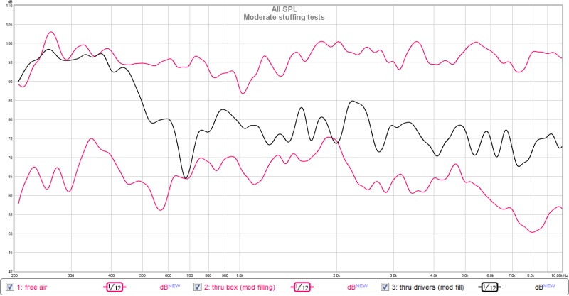

First test was to remove the 15" midbass drivers from my heavy ply cabinet, and drop this cabinet face down on top of the mini speaker. The box and carpet won't make a perfect seal, but ideally this is a test of how much sound leaks through the cabinet walls.
Next, I positioned the cabinet face up. I put the mini speaker inside the ply box, pointing into a corner, and loaded the 15" drivers back in. This is a test of how much sound leaks through the drivers.
The first graph, "Moderate stuffing tests" shows these results. MUCH more sound leaks through the cones than through the cabinet.
What I take from this: if you're using a midbass or wideband driver in a 'normal', well made box, the backwave that exits the cone will probably be worse than any cabinet radiation. In light of this, my fussing over minor construction points seems a bit silly.
If you do have a suitable box handy, please replicate this test and post your results. If yours 'eats' the backwave better than mine, I'd like to copy your ideas.

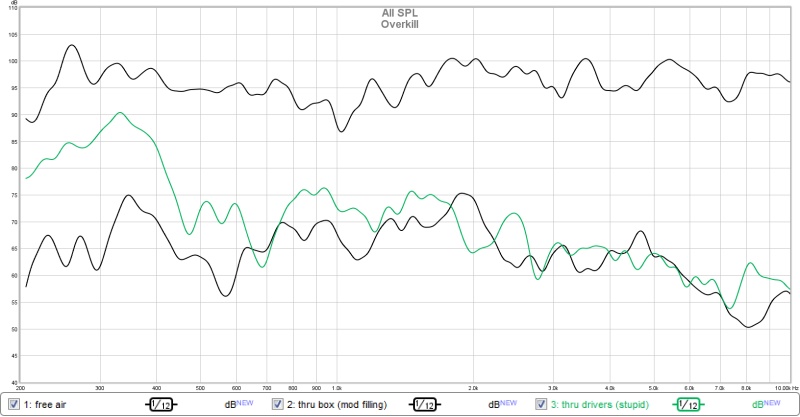

I tried lots more stuffing, in particular packing loose wool and woolen clothing around the mini speaker. That gave some benefit, mostly above 1500Hz.
This is shown in the 2nd graph, "moderate vs heavy fill".

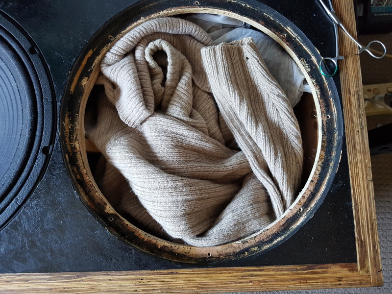

My last test was to take attenuation to an absurd extreme. The third graph, "Overkill" shows this. Even in this scenario, there's a lot more midrange leaking through the cones than through the box.
The images show the "overkill" test, where the box is packed with stuffing, as described. The drivers are largely covered and weighted down with ~500g each. It would be very difficult to get more attenuation than that, but the leakage is still high, relative to the radiation from the cabinet.

> The dominant mechanism for vibrating the cabinet is the reaction of the baffle to the vibrating drivers.
Can you show me that this is true? I see this assertion come up, but haven't seen it measured.
Fair question. What would you measure that separated the two mechanisms? OK that is perhaps something of an unfair question given the relevance you are currently assigning to your measurements.

This is why I like the test. It does a good job of isolating one part of the problem, and getting some comparative test info that shows some material based differences.
I don't think you are getting much agreement from the posters here with the "does a good job of isolating one part of the problem" aspect. The experiment is simply too unrepresentative of how a speaker cabinet vibrates in operation. You can see this by comparing your measured spectra with those from the various publications that have been cited. In these you can see a stiffness controlled region at low frequencies, a few large low frequency modes and an increasing density of less energetic modes at higher frequencies. The details may vary from case to case but this physics must be present.
I think it is good to know that, with DIY gear, one can easily show the correlation between the technical data about a material, and how it radiates sound when used in a box.
I suspect you might be showing that it is not that easy but it is good to see you having a go. To improve significantly on what one can get from a careful knuckle rap test will require a lot of effort but looks doable.

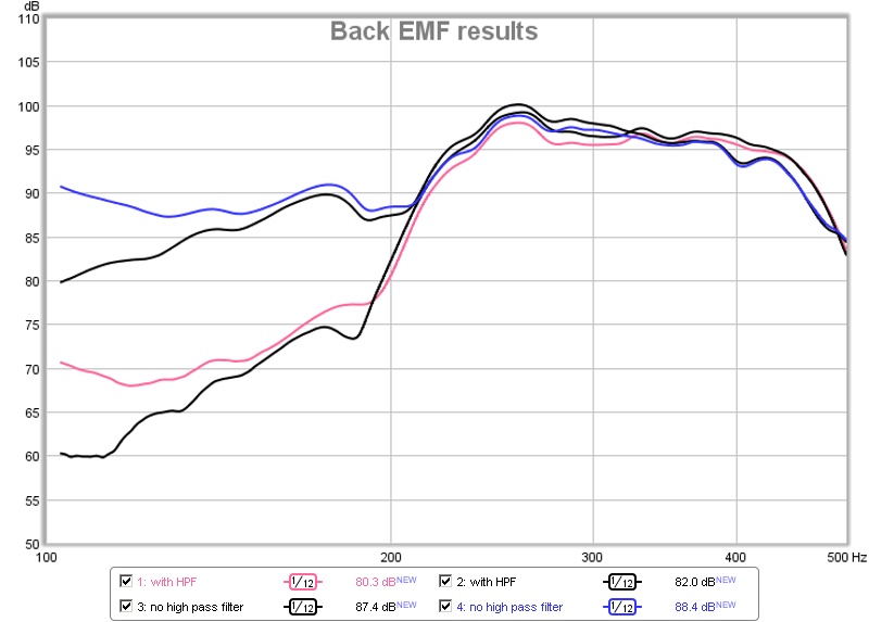

Connect the terminals on the dummy speaker together to simulate the "control" (not an EE here!) of the amp in normal operation.
I restored the cabinet to moderate stuffing, and gave this a go (I plugged the dummy woofers into another amp).
The "control" appears to be very important at LF but is insignificant by 200Hz.
The attachment shows the results with and without a high pass filter on the mini speaker.
I got the same result with different volume levels, mic positions, etc. I did not test below 100Hz since the sound generator is a mini speaker and I didn't want to blow it up... but that's low enough for the trend to be obvious.
I'd be interested to see others repeat this check with their own gear.

A) Face down (with no woofers) I can measure sound leakage that is almost entirely through the cabinet.
B) Face up (with woofers) I can measure sound leakage that is almost entirely through the woofer cones.
B) is a lot higher than A) and therefore seems B) much more important to mitigate.
The test is simple, and I encourage others to try it. I'd like to see a (reasonably portable, and living room friendly) system where B) is better.

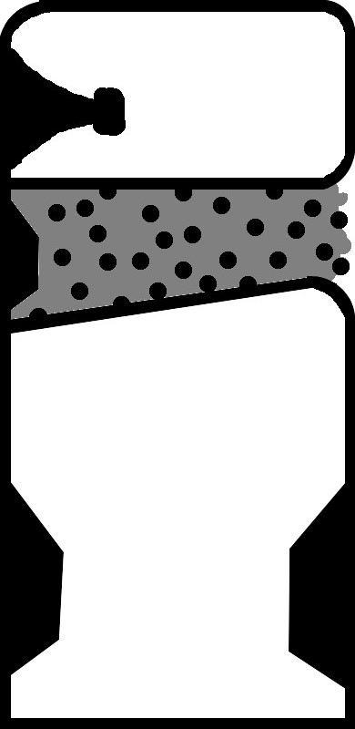

...so I'm thinking of something like this crude picture. Ideally, it'd cross to bass drivers somewhere around ~100Hz, and they'd be used in some form of opposed configuration (opposing sides or PPSL).

I want to know: what's the easiest (+ cheapest + most compact) way to mask it, so the backwave becomes non (or less) perceivable?
I’d suggest an aperiodic TL (a subset of what you have drawn)… suck the backwave down the line and damp the heck out of it.
We have had good success with this for the midTweeters in our WAW (formerly called FASTs)
