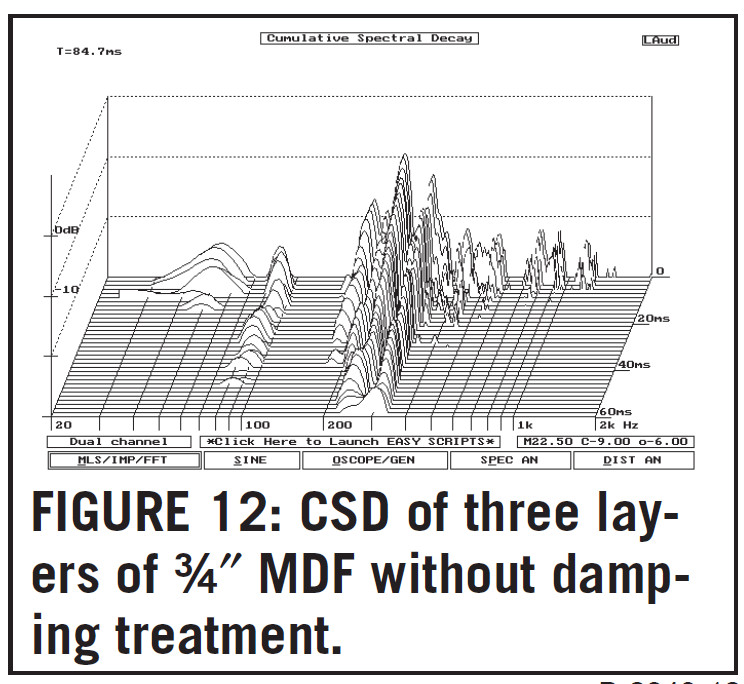

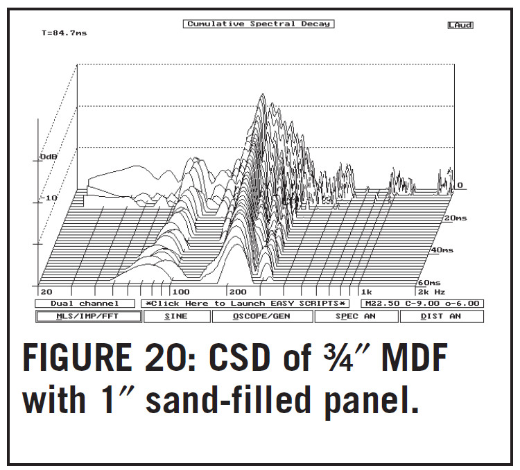

Sand would be very good, how would vermiculite work though?Another technique is to enclose sand in the cabinet walls. If too heavy try vermiculite.
From the moriyasu pdf linked earlier, it appears that a similar weight of solid MDF would do a slightly better job.
This is why I'm seeking measurements > subjective tips and stories.
A simple MDF box would be a faster and more robust build, too. I made speakers with sand filled panels once (side walls were flat MDF/sand/curved MDF), and I was a bit concerned that the weight of the sand would split a seam open if the speaker was shaken or dropped during a move.

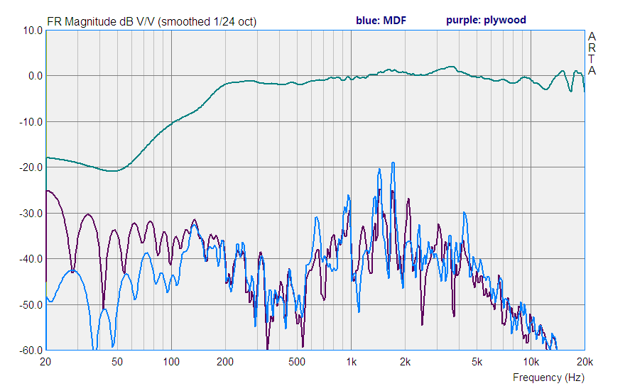

Csaba kindly sent me an additional graph; bare MDF vs. bare ply.
If the threshold for audibility is -30dB, as suggested in that BBC report, then the MDF is worse, as it crosses that line more than the ply.
Also, looking at the 5cm graphs on Csaba's page, plywood is the only material where the addition of sound absorbing material drops all peaks lower than -30dB.

It is good too work with evidence in the form of measurements but it is vital to understand what has been measured and how it is related to what you want to know. What has been measured here is not cabinet radiation at the ear for an operating speaker. The dominant mechanism for vibrating the cabinet is the reaction of the baffle to the vibrating drivers. This is missing. The air inside the cabinet is being pressurised by a tweeter so there is unlikely to be much if any signal at the low frequencies. The drivers are not moving and so how they react mechanically and electrically to the varying conditions inside the cabinet is not representative. Plus no doubt a few other things.If the threshold for audibility is -30dB, as suggested in that BBC report, then the MDF is worse, as it crosses that line more than the ply.
So what might be learnt from the measurements? The cabinet modes and their shape should be correct but because the forcing is wrong their magnitudes will be wrong. Much of the sound is likely to be emanating from the speaker cones which are almost certainly not responding in a representative manner. This would need further thought to back out the effects. The signal at low frequencies is too low.
Tapping a speaker (knuckle rap test) in a few places will also reveal the modes and their shapes but not the magnitudes. It seems simpler to perform and will excite the lowest frequency modes which I am not sure the tweeter is doing. It will also excite the speaker cones a lot less.

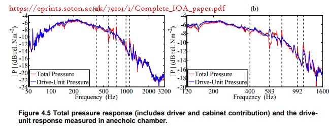

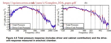

In the attachment of post #115 the author doesn't tell how the cab was made, only that is was plywood. Measurements were laser-based so minimal airborne error. My guess is that it exaggerates the effect of panel resonances in hifi loudspeakers. Here we can read what Sterophile's Atkinson thinks In his reports he shows the highest measured resonance and ringing(csd), but it's relative importance is vague.
Look at the clip from the paper mentioned (attachment here) - should we really be concerned?

He uses 20dB of eq. The reference signal is shown right there on each graph, and is pretty flat to 200Hz. Maybe he should have cropped the LF off the graphs.The air inside the cabinet is being pressurised by a tweeter so there is unlikely to be much if any signal at the low frequencies.
There are no drivers, so, yeah, obviously.The drivers are not moving
They don't exist so, yeah, obviously.Much of the sound is likely to be emanating from the speaker cones which are almost certainly not responding in a representative manner.
This is why I like the test. It does a good job of isolating one part of the problem, and getting some comparative test info that shows some material based differences.
I think it is good to know that, with DIY gear, one can easily show the correlation between the technical data about a material, and how it radiates sound when used in a box.
