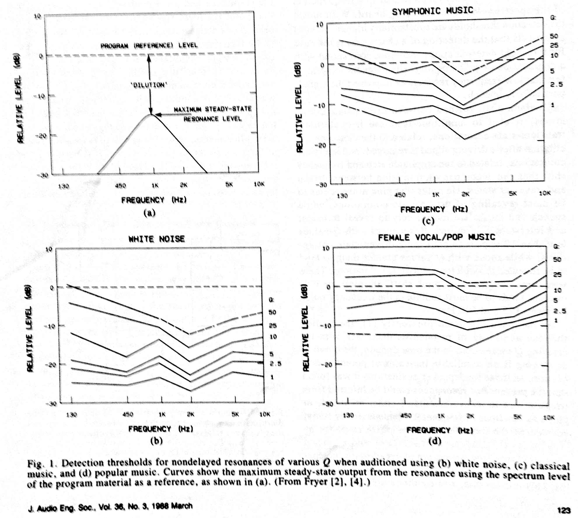

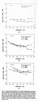

Here are audibility thresholds for non delayed resonances from Olive and from a different study by Fryer.
These are useful to illustrate impact of Q and source signal on resonance audibility.
Both confirm its easier to detect low Q resonances than high Q resonances, especially in the frequency range of loudspeaker panel resonances. At higher frequencies (eg where hard cone break up occurs), higher Q resonances become easier to detect, but low Q resonances are still easier to detect.
These studies showed (and confirmed by yet another study by Bech) that its easiest to hear low delay resonances using noise.
A yet again different by Olive on the audibility of reflection showed reflections with greater than 10ms delay are most easily detected using impulses, below that by noise. This further infers that resonances in loudspeaker cabinets are probably easiest to detect when using a noise signal.
If I am reading those curves right then as the Q goes up the total energy of the aberration goes down, since the peak level is what is held constant not the area under the curve. That's kind of wrong for resonances since as a resonance is damped the peak level drops as well as the area under the curve. That would make those curves inapplicable as far as Q goes. Noise being more evident than impulses is probably correct however.
Sean also wrote somewhere (can't remember where) that it appeared as if audibility was closely related to total energy.
I like how he expresses it here based on peak level as that is how we would observe it in a measurement.

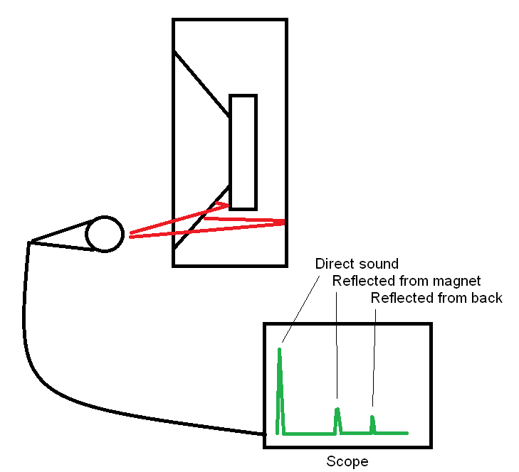

Post 52 here shows a good alternate (or addition) to the tests I tried.
His earlier comment (post 48) is interesting:
"You should see the clicks reflecting off different things inside the box on the scope [...]
The biggest one for mine was the woofer magnet"
It ties in nicely with what has come earlier in this thread here, e.g. post 158
"You have shown the sound radiation through the cone is much more significant, that's a good point. But I think that it remains to be seen if this is significant given the direct sound radiation. [...] a much heavier cone, like the pro units that I use, would be much better in this context."​
brig001's comment implies that the size / shape of the magnet and frame would be also important, e.g. I'd expect something like a Scan Speak Illuminator to do well on his test rig.
Over-engineering the cabinets is now lower on my priority list - I'll still do it, to some extent, but I won't throw stupid money at it.
