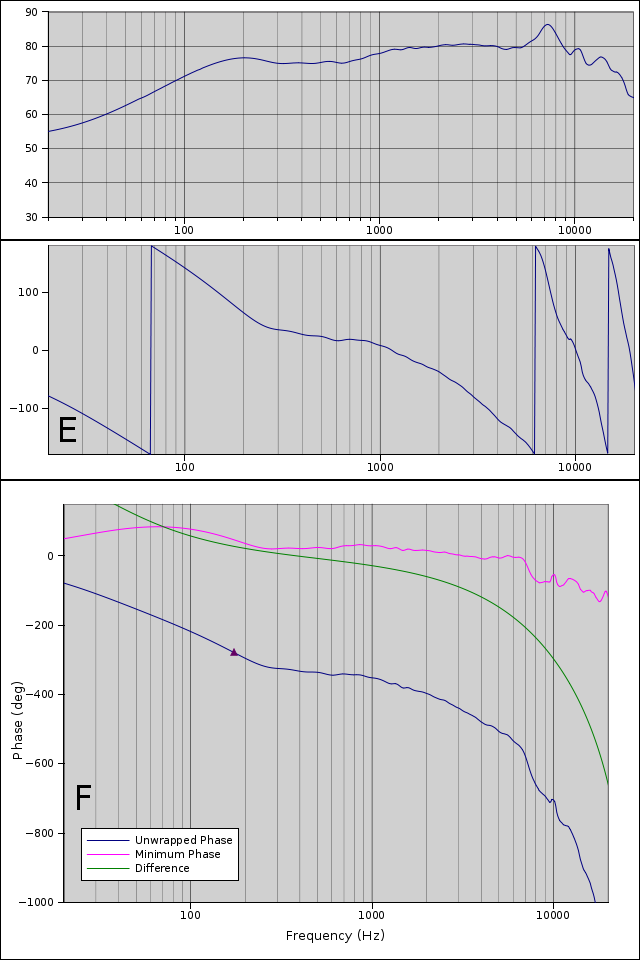

Everything you describe seems technically sound but I am confused a bit by the diagrams.
Your A and B look very nominally to be the same shape, but their scales are different by a factor of ten. B looks realistic. I don't know why A would be devoid of detail. It is too smooth. From this I don't know why the difference, C, would be a smooth curve. It might help to see the response curves that go with the phase curves.
David
Hello Dave,
Graph E in the attached figure shows the raw magnitude and phase measurements for the driver for reference. Note that the phase contains the driver phase characteristics and the time delay component. This is way the phase wraps around the -180 deg mark several times.
Graph F shows a comparison between the unwrapped phase, the calculated minimum phase, and the difference between the two. Because of the phase wrapping in E, when unwrapped, the phase ventures many times lower than -180 deg. The minimum phase, however, by definition, is constrained to +-180 deg. This is why there is a such a large difference in the scale of the two curves. If I would have gathered all of the phase data from 0ms of the impulse response, the different in scale would be much larger.
Because they are plotted on the same range (which they weren't in graphs A and B above), it can be seen that the ripples in both the two curves are the indeed same magnitude. When the curves are subtracted, we get the green curve in F, which is a smooth logarithmic curve on this logarithmic axis. When plotted on a linear scale as in C, the curve is indeed a smooth line and the time delay information can be deduced with just the slope of this line as illustrated above.
I hope that clears it up a bit!

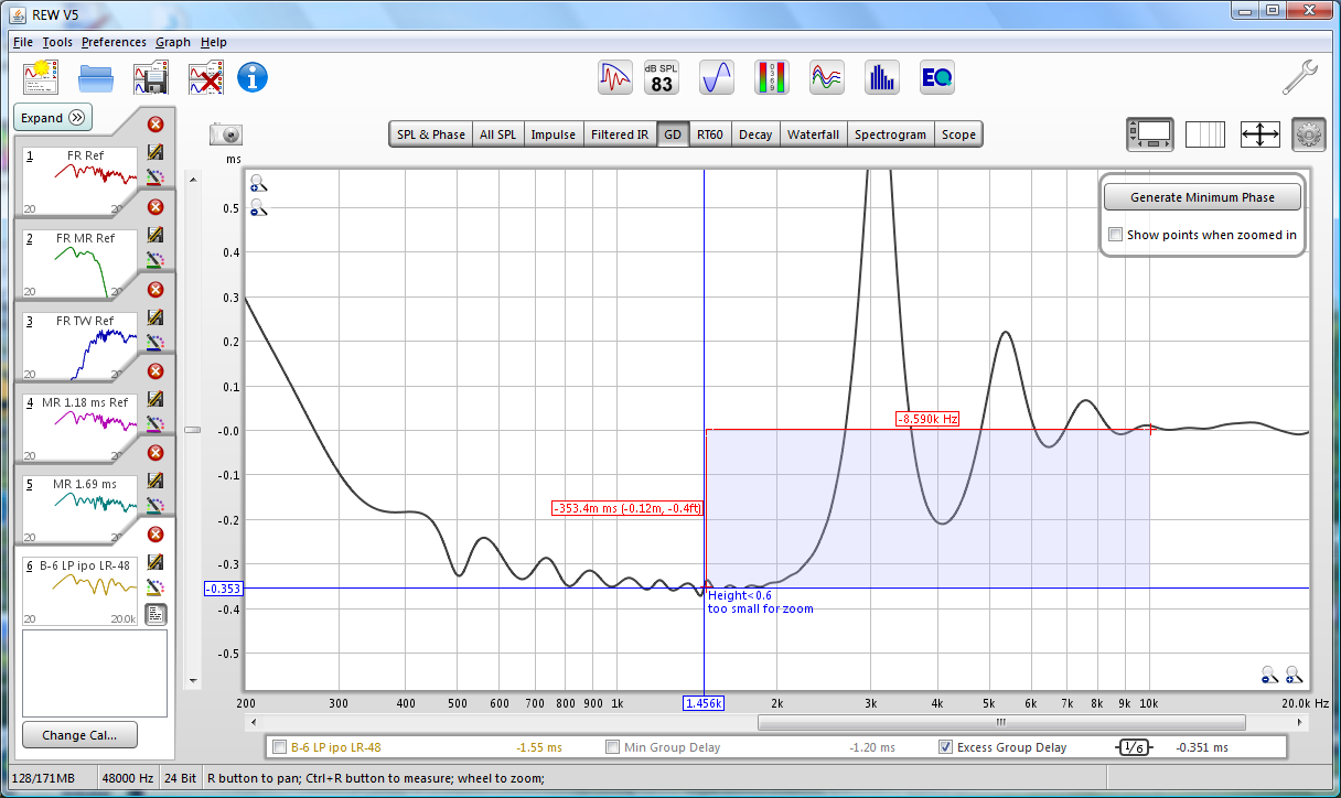

Simon’s method of using excess GD to measure the in situ acoustic offset of drivers seemed correct to me so I ran a little experiment on a speaker. I am sharing my results for your consideration.
I believe the method works fine and can give a very accurate relative driver acoustic offset with one simple measurement.
Provisos:
> The band pass portion of the driver should be utilized for determining the offset. Avoid using the range where the influence of the XO filter or the coil impedance is influencing the phase response of the driver.
> The XO network and probably the “box filter” add delay to the drivers so the results are relative to only the specific situation being measured.
> As mentioned, this says nothing about the phase alignment through the XO range.
> As mentioned, it would be difficult to measure the offset of a SW from a MW using the mic at LP due to all the room mode effects.
Measurement Conditions:
> 6.5” MW and 1” dome TW in a sealed box.
> DCX2496 XO filters: LP LR-48 at 2.03 Hz, HP But-18 at 2.03 Hz. [The polarity is reversed between them.]
> Acoustic XO at 1.8 kHz
> Mic at 30 inches from the baffle and very near the LP axis.
> REW Measurement IR was offset such that the peak is at 0 ms.
> The measurement was gated at -0.03 ms and +7 ms
The Measurements:

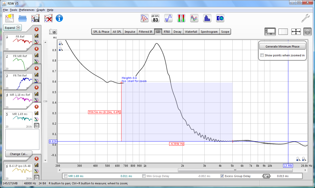

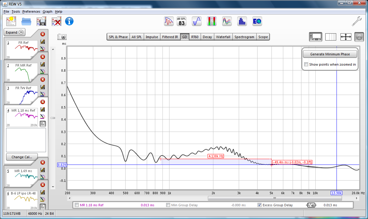

Current Reference DCX Setting; MW delay = -0.51 ms (174 mm) [relative to the TW]
Regarding the above measurement:
The bandpass portion of the TW is between 4k and 7k Hz, and the bandpass section of the MW is between 500 and 1k Hz. I avoided using the TW HF above 8 kHz where the coil impedance influences the phase.
The delta of Excess GD is measured at about +0.05 ms between these frequency ranges as shown.
I have no way to knowing if this is the correct value at this point, but using the DCX I changed the delay on the MW +0.51 ms and remeasured:
Now the above offset is about +0.56 ms or an increase of +0.51 ms. That’s the same value that was added to the MW delay. This suggests to me that this is a viable method to measure the effective acoustical offset between drivers in situ as Simon suggested.
I also changed the MW LP filter from LR-24 to But-6 and confirmed that there is a significant impact on the relative acoustic offset as expected (about -0.40 ms relative to the reference):
This highlights that the results are only relevant to the exact system being measured and say nothing about the raw drivers.
I’m a hobbyist and not sure this experiment is conclusive, but thought you may find it interesting.

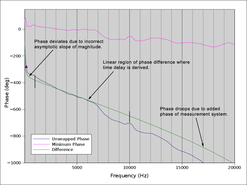

Hello David,
Have a look at graph C in my original post. This is the same curve (on a linear scale) as the green curve in F, that is, the difference between the unwrapped phase and the calculated minimum phase. You will see that it is indeed (very) linear over my selected frequency range for evaluation, 1khz - 10khz. In fact, the graphed data is almost completely obscured by the fitted line. Maybe that's why it is difficult to see what's going on.
You are correct about the errors introduced in the Hilbert transform in the low frequencies. This is, as you said, due to the incorrect roll-off of the driver measurement because of the time-bandwidth requirement not being met in this range. This is also why the y-intercept of the fitted line is not 0 deg as it should be with an ideal time delay. As I said, I did no tail correction to the plots.
The nice part about using the slope of the phase difference in the region where the phase difference is very linear, is that these errors do not affect the outcome. Indeed, the slope of the line in this region where the measured phase and calculated minimum phase is known to be accurate, is all we need to know to derive the time delay. Discarding the faulty y-intercept corrects this line to represent a pure time delay.
Dan
I have added another graph to help clarify my comments above. This graph is the same graph as graph plot F above, only with a linear frequency axis to show the linear nature of the phase difference. The vertical black lines indicate the upper and lower frequency bounds we are considering.
BUT WAIT!
It is easily seen that the green line is not in the same position in the attached plot as it is in plot F above. This is because I made an error when I created the green curve in plot F. I used the phase difference in that graph AFTER I had added the necessary 353.127 deg offset to correct for the low frequency anomalies we have been discussing. That is, the green line is simply shifted upward in plot F. This is the technique I described in my second formula.
The beauty part of the slope method is that this shift does not matter, and the same result for time delay is derived from either green line.
END GOOF UP

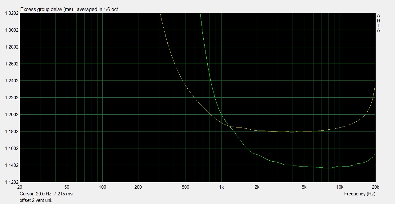

There is a significant amount of ripple in your measurements which suggest to me that you have some measurement reflections creeping into your window time, this may be causing you some inaccuracies.The Measurements:
I had no ripple at all in any of my test measurements with ARTA.
The large amount of ripple both at high and low frequencies suggests to me that there is something wrong with this measurement, I would double check your window time and perhaps try another program like ARTA to see if you get the same effects. The ripples in excess group delay between 3Khz and 8Khz look totally bogus to me, so are likely to be a measurement artefact. (a 1st order filter should have less group delay than a 4th order, not more...)I also changed the MW LP filter from LR-24 to But-6 and confirmed that there is a significant impact on the relative acoustic offset as expected (about -0.40 ms relative to the reference):
As I mentioned earlier, a 1st order filter is probably not going to give accurate results due to insufficient stop band attenuation. (But still shouldn't show ripple like this)

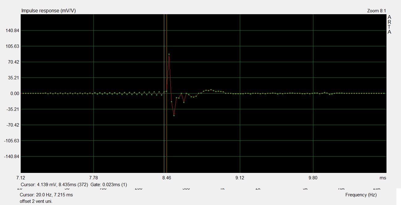

I have been trying the excess gd method presented in this file and found a couple of pratical issues.
Any IR have some physical width in samples. Very thin impulses for a ribbon tweeters, or very thick, with a long rise time for a subwoofer. And there is always some pre-ringing...The question is : where shall i locate the yellow cursor, on what sample, if i want it to be at T=0, the beginning of the IR?
BTW, we have a second issue, due to the fact that we have a discrete time scale, and the time resolution is related to the sampling freq: 1 sample resolution at 44khz is 1/44000, that is aprox 20uS, that is aprox 8mm. It seems to be the best precision we can expect by clicking for yellow cursor location.
What i mean is that whatever the method used, excess gd or other, the question is not if the method is good or not, but rather: does it always make sense to worry about the idea of estimating the time offset between 2 drivers.

The initial rise slope of the impulse is determined by the high frequency cut-off of the driver - the higher in frequency it goes the steeper the slope.I have been trying the excess gd method presented in this file and found a couple of pratical issues.
Meanwhile the width of an impulse (roughly) represents the low frequency cut-off of the driver. A tweeter with a high cut off frequency will have a narrow impulse, a woofer will have a much wider one. Not that it matters for the measurement of excess group delay as presented.
Pre-ringing only happens with linear phase filters, so either you have some sort of active crossover using linear phase filters, or the sound card itself has steep linear phase filters in either the DAC or ADC stages, or is doing sample rate conversion due to your measurement software trying to use the card in a non-native sample rate.And there is always some pre-ringing...
I don't see any noticable pre-ringing on any of the impulse measurements I take in ARTA with my sound card used at a native sample rate. (I normally use 96Khz, the only other native sample rate for my card is 48Khz, all others introduce undesirable resampling)
You never want to put the cursor exactly at time zero for any type of impulse measurement. The cursor must always be before the beginning of the impulse, including any pre-ringing. How much before doesn't really matter, as long as there are at least a few zero samples to be sure you haven't clipped the beginning off the impulse. Better to err on the side of putting it a few extra samples earlier.The question is : where shall i locate the yellow cursor, on what sample, if i want it to be at T=0, the beginning of the IR?
When measuring phase or group delay in ARTA the setting "delay time for phase estimation" is an additional computed delay from the location of the start cursor, so the earlier you set the start cursor the greater the delay time for phase estimation will be to get the same absolute phase curve, but it makes no difference to the end result as long as the start of the impulse isn't clipped off.

I've never worried about driver offset among similar drivers, that is for one 1" dome tweeter vs. the next. But obviously phase offset amongst drivers in a system is a major issue to be dealt with.
Since we find that drivers are primarily minimum phase and drivers plus network are still minimum phase, the real issue is the shift between one "way" and the next, and how we get them to blend by picking the right order and polarity.
I regret that I haven't kept track of the crossover orders that I have used over the many systems designed. If you think of it, a 2 way system with 1" dome and 6 or 8" woofer, crossing at 3k (what percentage of the product universe does this cover?) probably only has a solution or two for Linkwitz Riley type blending. A 3 way system would have a few more variables but might also show a small number of common solutions.
Regarding section group delay, all multiway loudspeakers are an assemblage of bandpasses. For a bandapass the highpass corner bends phase up and the upper lowpass corner bends the phase down. The center of the bandpass (generally) is without extra phase shift and reveals the group delay tied to the driver depth. Usually when viewing the whole system's group delay you can see a fairly constant delay time for each section (2 way or 3 way) as long as band edge delays aren't swamping the view. While your crossover choices (order and section polarity) definitely impact phase at the transitions, they tend not to mess with middle-of-section group delay.
David
David
Even if some delay is added, electronic or physical, the bandwith limitations of the drivers will never really allow to apply any arbitrary LR solution. More flexibility will be gained, but some tweak will always be needed, especially if low order slopes are required. No exact nor absolute time offset to be found, i'm afraid, only xover choice related aproximations.
The bending of phase at the bottom and top end of each bandpass is a minimum phase characteristic where the phase shift introduced is a result of the amplitude response, so what's neat about measuring excess group delay (derived from excess phase) is that this effect is entirely eliminated in the measurement, so we don't need to guess where in the passband the phase shift might be neutral. Also the passband being flat is assumed in the above as non flatness of amplitude response of real drivers is obviously going to introduce phase shift and group delay.Regarding section group delay, all multiway loudspeakers are an assemblage of bandpasses. For a bandapass the highpass corner bends phase up and the upper lowpass corner bends the phase down. The center of the bandpass (generally) is without extra phase shift and reveals the group delay tied to the driver depth.
The excess group delay of a single band-passed driver (combination of electrical and acoustic roll-offs) is a flat line, assuming both the driver and crossover section are minimum phase, which as you say usually the case except for weird exceptions like whizzer cone drivers which are really all-pass systems in and of themselves...
The measurements of "normal" drivers I've taken with and without added crossover confirm this flat line response for excess group delay. Because the phase/group delay variations caused by non flatness of amplitude response are eliminated even if the driver has a fairly jaggy (but still minimum phase) response it doesn't matter - the excess group delay is a flat extremely smooth line without any smoothing applied.
(The excess group delay curve I posted right back in the original message was not smoothed, so even though the amplitude/phase response of the driver and baffle was quite jaggy, once the calculated minimum phase was subtracted from the measured phase the excess phase left over is an extremely smooth curve, and therefore so is the excess group delay)
The main limitations are that the excess group delay does diverge from a flat line at very low and very high frequencies, but I believe this is due to measurement bandwidth limitations, not any actual change in excess group delay of the system. (Since the phase shift is affected by amplitude response well outside the measured bandwidth a finite bandwidth will introduce phase errors at the edges of the measurement bandwidth...)
With a 96Khz sampling rate I find the line flat well out past 20Khz, and at the bottom end it depends on the window length of the impulse...typically within about an octave or two of the time bandwidth limit the line is flat.
Because the amplitude related phase variations are eliminated it makes it very revealing of the true pure time delay in the system. (In typical measurements I find the excess group delay of the multiway system to be a tiny fraction of the normal group delay variations which are due to amplitude response non flatness)
Exactly. And when viewed as excess group delay this becomes plainly obvious - the crossover only affects the group delay of the transition region - how much the group delay increases near the crossover frequency and over what bandwidth. Within the bandpass of each unit (where adjacent drivers are sufficiently attenuated in their own stopbands) the excess group delay is purely down to the time delay of the drivers, which is the basis for trying to use it as a measurement technique for relative acoustic centre offset.Usually when viewing the whole system's group delay you can see a fairly constant delay time for each section (2 way or 3 way) as long as band edge delays aren't swamping the view. While your crossover choices (order and section polarity) definitely impact phase at the transitions, they tend not to mess with middle-of-section group delay.
As for the "does it matter" or "is it audible" part of the discussion, what I find interesting is that some people (not referring to you here) believe that group delay at a crossover frequency introduced by the crossover is audible (despite only typically spanning 1 to 2 octaves) yet somehow a group delay difference between two drivers due to acoustic offset which causes a group delay shift potentially spanning many more octaves somehow isn't audible.
Again referring to my original example we had a 3rd order filter with the tweeter acoustic centre only 20mm ahead of the woofer - considerably less than some designs, and we can see that the crossover itself introduces group delay of 0.15ms near the crossover frequency, but a modest 20mm driver offset introduces a group delay of 0.1ms - almost as much as the crossover but over 4-5 octaves. (Everything below about 3Khz...)
From what I can remember the ear is sensitive to inter-aural time differences as small as 20uS, what is unanswered is whether its sensitive to time delays in the order of 100-150uS between fundamentals and harmonics which span the two different passbands which have different group delays...
We can't do much about the group delay introduced over a narrow range by the all-pass nature of the crossover itself, but we can eliminate the gross delay error between the drivers so that the bulk of the passband of each driver arrives in time with its neighbours with just a modest bump in the delay at the transition frequency.
Does it matter ? Not for tonal balance obviously, but for timing related cues ? Maybe. I'm not convinced either way to be honest, but I wonder if its something that hasn't been given enough attention, simply because its "too hard" to time align drivers in most designs due to physical constraints and diffraction issues, and that the effect may be subtle.
Could part of the imaging "magic" of some full range drivers simply come down to timing coherency of not having any gross (shelved) group delay variations between high and low frequencies which is commonplace on flat baffle non time aligned speakers ? Worthy of further investigation I think.
I agree, but i still don´t see the need to measure the time offset to get a time aligned system...
My point is choose and build a suitable xover and then add whatever delays are necessary to get the best blend. Thats what do with the linear phasr FIR filters i use.
