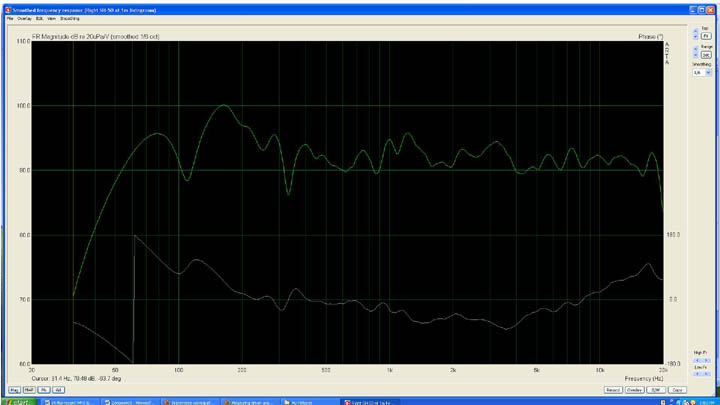

Here is an old SH-50 speaker that has crossovers around 400Hz and around 1200Hz, it was measured in place in my living room with a motorcycle and secretary desk in very close proximity (6 inches) from the mouth and a wall 3 feet away.
This is at 1 meter in room, no eq, passive xover and with as one can see, there is no phase rotation like one would expect from a forth order xover used on the hf for example. It is the same dusty speaker, same location I posted to with the square waves it produced.
The close acoustic spacing (less than ¼ wl) allows drivers to add coherently into one source within the horn, as the high frequencies emerge from a crossover first, they go to the rearmost driver. AS the wave progresses forward from the small end, at a region where the horn expansion rate is suitable for mid range, those frequency components are added in time as they emerge from the xover next, same for the lower frequencies and so on in a four way system. What emerges is a portion of a spherical wavefront “as if” it came from a single wide band driver on a large CD horn and so this is the response across the horns pattern, not limited to one exact spot like when drivers are farther apart..

DBMandrake said:
The group delay that is due to the minimum phase part of the drivers response will be corrected by any equalisation curve in the network for that driver which corrects the response error.
Right;
So if your driver had a peak in its response and attendant group delay, equalising that peak in the response in the network will also correct the group delay error. The flatter the equalised frequency response of the individual driver the flatter the group delay will be.
Yep;
What is left over after that is the group delay due to the distance offset. Assuming a relatively flat amplitude response its the time delay from acoustic centres that still sets the baseline group delay difference between the two drivers, and is the part that can only be corrected with physical offset. (Or a pure delay)
That is exactly how the square waves I linked were produced, in the case of an SH-50, it is a passive crossover network and the progressive delays imposed by the driver mounting locations on the horn shape exactly counter the time delays imposed by the mid/low and mid/high crossovers.
While normal crossovers have a step in the group delay caused by the shape and amount of phase rotation (going from well above to well below xover) which puts the high frequency ahead of the low frequency range, it is possible to eliminate that as well.
With DSP that is easy but it can be done passively also, examine the phase response for the sh-50 I posted a couple back.
That is the actual measured phase (at a meter in a cluttered living room) not with excess phase removed, that looks like one driver not 7..
