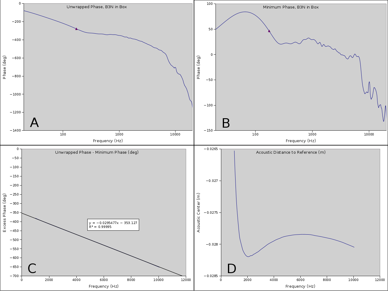

In fact one of my goals was to be able to measure the acoustic offset in any existing design with a single measurement without disassembly of the speaker or crossover/wiring, and I'm not aware of any other approaches which will do this with any degree of accuracy.

That's it with some details to make sure it's clear. The first (with a caveat I'll add later) is that the CAD program should have the 3-d locations in space specified for drivers and mic. This provides the excess delay due to not being coincident drivers (such as a coax). You select some reference (I usually use the baffle surface) when making the measurements and use this in CAD.I've looked at your method and I really like its simplicity. Just to get this straight:
- Measure each driver individually and as a pair (three measurements total for a 2-way)
- Calculate the minimum-phase with the HBT.
- Load the data into a CAD program.
- In the program give the farthest driver just the right amount of delay so that the simulated combined response of the two drivers gets identical to the measured pair.
The amount of delay necessary is the relative delay time between the two drivers.
The second point is that you can alter either driver's offset, but it's probably best to adjust the driver with the deepest offset from the reference. Since tweeters are usually not deep, their center is not far from the front of the faceplate. The caveat I mentioned is that since we cannot know the precise acoustic center of any driver, there will always be a small amount of error, even using the tweeter as the (0,0,0) reference because it could really be something like (0,0,-5mm) or some such value. The small amount of geometry error won't have any significant impact.
After adding the appropriate delay to the woofer (when adjusting it for the z-axis offset), the result is the relative offset of the woofer to that specific tweeter for the z-axis. What this provides to the CAD software is total delay, x-axis for horizontal placement on the baffle, y-axis for vertical displacement between drivers on the baffle and the z-axis for the physical difference between drivers from the reference (the baffle surface example).
You can also do this with either polarity for any driver, just be sure that the CAD program is set up to match it. As a rule I always connected both in positive polarity.
If you design to a single point only and do not wish to investigate other points in space for the microphone, the only thing needed in absolute sense is the total delay. You can simply set the woofer and tweeter at (0,0,0) and add delay to the woofer z-axis for the total delay from the three axes. This will not give you the relative acoustic offset between individual drivers, it gives you the total delay as seen at the microphone position where you made the measurements, the same delay as in the 3-d model. The physical equivalent would be having the woofer and tweeter in-line with the woofer offset quite some distance behind the tweeter. This doesn't work in the real world, of course, but for design in CAD it can. The limitation is that you can't then move the mic position in CAD to investigate other points because this will introduce error in the total excess-delay.
I have always measured with raw tweeters, no cap for protection, because it can be done at very low power. I've even measured ribbon tweeters that way. If you do that, just be careful with power setting. I've seen recommendations to always measure with something like a 100uF cap on the tweeter. This will help protect against power amp turn-on or other issues and probably won't create an issue with the tweeter highpass. The cap won't alter the excess delay so you should still get accurate results for offset.
Dave

I think you're tripping up on the distinction between group delay and excess group delay here.If your interest is in physical driver offset then you will need to look at drivers without networks (of course). Even systems split into sections will not give an offset tied to physical parameters (such as voice coil depth) since the filters will add an unknown extra delay for the woofer and advance for the tweeter.
Yes the individual high pass and low pass sections will add phase shift and therefore group delay, however this phase shift is minimum phase.
If no excess phase is added by the high and low pass filters then it makes no difference to the excess group delay - it's cancelled out.
(I guess if you had an all-pass response contained within one section of a crossover, like a lattice phase equalizer this assumption would fall apart, but most crossovers even with amplitude response corrections will be minimum phase?)
In front of me I'm looking at individual measurements of woofer and tweeter crossed over at 4Khz, and their excess group delay curves are almost dead flat over a wide range despite the high pass and low pass filters being in place. The main source of inaccuracy seems to be limitations imposed at the low frequency end by the FFT window size, but that's always going to be the case.
Which is precisely what excess group delay is measuring! 😀To me the only way to come up with useful numbers is the Hilbert Transform phase comparison to actual phase. Since you have group delay measurement as an option then group delay of the unit vs. group delay of the Hilbert transform should be parallel curves that can be subtracted for a single valued answer.
ARTA is calculating excess phase by subtracting Hilbert Transform calculated minimum phase from actual measured phase, and then differentiating the excess phase to get excess group delay, which is equivalent to the method you're suggesting.

Some years ago I spent considerable time trying to find a way to determine absolute acoustic center. Nothing worked. I know of one other person who I respect who was doing so simultaneously, so we discussed our efforts. Neither one of us was successful. Not too long after that there was a working group within the AES (I think it was them) that was given the same task. My understanding is that they were also unsuccessful when they closed the group.Is this true? I know if we look at group delay it isn't a single valued number, but if we compare measured phase to HBT phase, we should have an excess phase amount that converts to an exact distance. It may vary with angle, so there isn't a hard point for all angles, but can't we come up with a real source depth?
David S.
The reason why has to do with the basic method. It's a simple task to measure phase today, it's a simple task to generate phase with the HBT, but therein lies the rub. The HBT is based on an FR with assumptions. Those relate to the highpass and, more importantly, the lowpass. Older systems such as mine (LAUD) had limitation to 24K, others maybe to 30K. The HBT algorithms use data beyond that, so either the user creates it or the software has to extend with some assumption, often continuing the curve from the last data point either flat or at the same slope. Either way, it's an assumption.
Add to that the issue of whether or not there is a point at the upper end where the FR may start to be non-MP (I've never been convinced that it is). That adds additional uncertainty, even for the current systems that can measure to higher frequency.
In a bit of a simplistic way, it's a bit like the Heisenberg Uncertainty Principle. The more precise we try to be about the driver SPL, the less certain we are about the accuracy of the corresponding HBT phase that is generated from it. We have no other means of determining the true MP response.
To actually measure true MP we have to first know the absolute acoustic center (AAC) so that we can remove the correct amount of excess phase from the measurement (assuming we know the effective AAC of the measuring microphone!). But to know the AAC we have to know the SPL response with certainty, since we must use that to generate the HBT phase.
There are similar uncertainties with other methods, such as the impulse response. There are just too many dependencies and uncertainties.
The only thing we need for design, however, is the relative acoustic offset unless one designs from measurements directly. I've done the latter a fair amount in situations where I understood what would occur at other points than the mic measurement position. The relative offset is one of the easiest design considerations. It is not an absolute, it is dependent only upon the SPL frequency response and we can even use variations in the FR as long as the model is not changed after the phase is generated with the HBT. Change the lowpass slope of one driver and the excess phase changes. But all we need do is change the offset of the driver by the same amount on its z-axis in the model and the relative offset that results will still give us exactly the same summed response as before. That's why I abandoned efforts on the absolute, all that's needed to design is the relative.
The offset may change with angle as well, though I've not tested that. I was told that it does and I can see why it would. But other considerations off-axis are probably of much greater concern, though it's one reason I have used offset midrange units to try to align the centers on the z-axis. Changes in diffraction and driver directionality will be orders of magnitude larger than most changes in the relative offset for most systems, at least for lateral changes in axis.
Sorry for verbose response. It started out short. 🙁

Just think about where excess phase comes from and then you can immediately see what excess group delay will and won't show.
If you measure each driver on it's own most drivers will be almost perfectly minimum phase, with a few special cases.
One exception is a dual cone driver which is definitely not minimum phase at high frequencies, showing an all-pass like excess phase curve and group delay peak due to its mechanical crossover. That's an uncommon case for a multi-way design though.
Another possible exception is what dlr alluded to earlier - that some drivers may show a little bit of excess group delay increase right at the top end of their range - my speculation is that this only occurs on drivers that are physically large for the frequencies involved, (so far I've only seen it on full range drivers, not tweeters) and happens due to a shrinking effective radiating area pushing back the effective acoustic centre...(in this case the acoustic centre really is moving slightly at high frequencies)
Anyway in the majority of cases the driver is minimum phase over the bandwidth of interest. If you then add the crossover, most crossovers sections are also going to be minimum phase, unless you had some kind of special all-pass correction within a single drivers section. (Does anyone do this passively ?) So adding the individual crossover sections doesn't change the excess group delay reading. (experimentally verified on a simple 3rd order high/low pass filter)
All that's left to generate excess phase is the all-pass function formed by the summation of the two drivers, and the acoustic offsets, so these are the only two things that will show up in excess group delay.
So at and near the crossover frequency the excess group delay is largely due to the all-pass function of the overall speaker, and far enough away from the crossover frequency (when the opposing driver is sufficiently attenuated) the excess group delay should be only that due to distance.

I would like to relate some success I have had determining acoustic offsets between drivers using the unwrapped phase minus the minimum phase method mentioned by a few above, with a few added analytical tricks.
I thought it better to bump up this old thread rather than start a new one.
Using ARTA, I measured two drivers in a prototype enclosure without moving the baffle or microphone between measurements. On the attached plots, graph A is the unwrapped phase for one driver, a B3N, from 20Hz to 20kHz. Note that the phase does not include the entire delay to the microphone; I moved the gate start cursor in ARTA to just before the impulse. Importantly, I retained this marker for the second driver. Thus, the distances calculated are not fully to the microphone, but rather to a "phantom microphone" closer to the drivers, if you like. Since I am interested in the relative acoustic offsets this works fine for me. This method would work well to determine the relative acoustic offset of two drivers mounted on test baffles, ensuring that the distance from the baffle to the microphone is identical. But, since I had already designed the enclosure, this was purely academic for me. I suppose if you are interested in an absolute offset for a driver you could use the entire impulse from time 0ms knowing the baffle to microphone distance precisely.
Graph B is the calculated minimum phase for this driver. The markers on the graphs indicate the time-bandwidth limit for the gated response as reported by ARTA. From the looks of the graph it seems this should be higher, though I haven't investigated this.
Graph C is the unwrapped phase data minus the minimum phase data calculated with a spreadsheet. Since we're interested in the range where a crossover frequency will be used, the frequency range plotted is 1kHz to 10kHz. In this span the graph is very linear (on a linear x-axis) indicating this represents a pure time delay. Below this the data departs from linear because of the time-bandwith limit, and above the range it departs due to the phase response of my preamp, I believe. A linear regression is plotted on the graph with a very good fit indicated by the regression coefficient. Note that for a perfect time delay the y-intercept would be 0, but here it is indicated as about -353 deg; again this is due to the low frequency limitations of the measurement and for the method I used here it does not matter.
That is because I calculated the acoustic offset using just the slope of the line indicated in the equation box:
L = (c*m)/360 (meters), where
c = speed of sound, m/s
m = slope of fitted line, deg/Hz
For this example, the calculated offset from the reference location is -2.793cm.
If desired, the phase data at each frequency can be used for the calculation of the offset if the data is adjusted by subtracting the y-intercept value from the fitted line equation:
L = (c/f) * [(Punw - Pmin - b)/360] (meters), where
f = frequency (Hz)
Punw = unwrapped phase data (deg)
Pmin = minimum phase data (deg)
b = y-intercept (deg)
This is plotted in graph D. Note the full range of the graph spans just 2mm and the values agree well with the value calculated from the slope alone. This method is interesting to me because it allows investigation of the acoustic center of a driver versus frequency.
The same measurement and calculation was done for my second driver, a tweeter, and its offset to the reference location was calculated as -4.677cm. (If a tweeter center that is located behind the driver's seems odd, that is because I am using a slanted baffle.)
After some fun trigonometry to account for the angle from the woofer to the microphone, a relative offset between the drivers in the z dimension (parallel to the floor) of 2.24cm was determined. When I compared this to a scale CAD drawing of the enclosure and drivers, the result jived well with the physical placements: a good sanity check for me.
For all the explanation above, this method just uses a very simple spreadsheet calculation. I'm interested in comments on the method and result presented.
