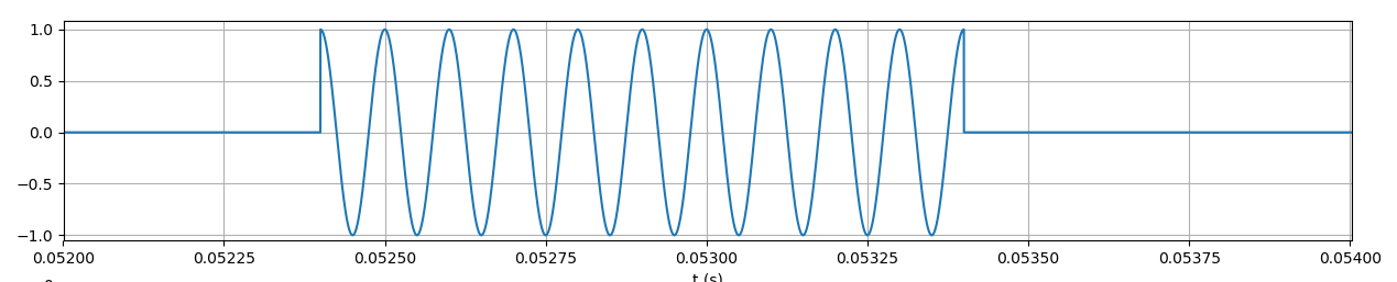

I don't see how measuring 30 cycles would fix the issue described. The error may be smaller, but in principle it is still there, no?
The crux of the thing is to measure over a cycle of the 100Hz; even 20 cycles of the 1kHz give an error as shown in the lower graph.
But if you use a pure single freq signal, you can measure over a single cycle with no issues.
Jan
But if you use a single freq signal, with or without harmonics, you can measure over a single cycle with no issues.
That's how I understood it.
Jan

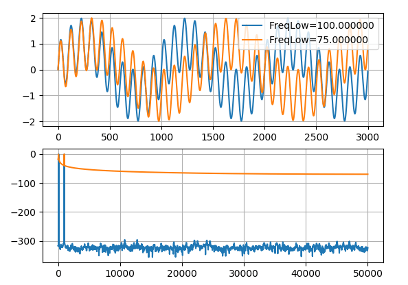

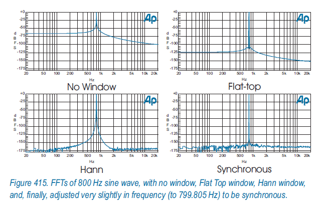

In this specific case the waveform is periodic over 10 cycles of 1kHz so it would be periodic over 30 cycles also. But in the general case the trick is windowing. FFT of a non-periodic signal is useless without a window. In this case it's 1k + 75Hs (orange) or 100Hz (blue) and an integer number of 75Hz periods do not fit into 30ms, so the FFT is a mess.

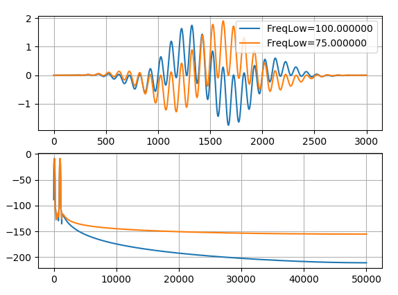

But application of a window function (here Kaiser 12 on the same signal) allows to pretend the signal is periodic by smoothly fading both edges of the acquired data to zero. And then it works. FFT noise floor is slightly elevated but non significant (-150dB...)
If the DAC clock (generating sinewave) and the ADC clock (acquiring it) are not synchronized then it is not possible to acquire an integer number of periods, it will always be an unknown fractional number because the sample clocks are not the same. In this case the usual method with windowing is the only way... and synchronous measurements are not possible, which is a shame, because they're damn useful.

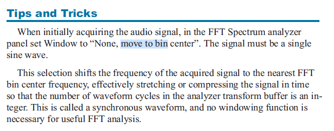

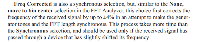

I just reviewed how AP does it in my 2722. Synchronous FFT has preference, but you can also select to slightly move an incoming signal frequency to make it synchronous with the FFT analysis.
The other option is to move the signal frequency slightly so it falls in an FFT bin center.
Jan

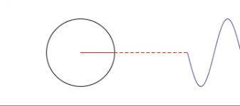

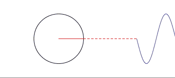

A sinusoid is formed by rotating a vector of constant length (determines the peak value of the voltage) and with a constant angular velocity (determines the frequency of the signal). In order for additional spectral components to appear in the spectrum of the sinusoid, the vector must convulsively change its length and change the speed of rotation.
We are talking about a pure sinusoidal signal and the nature of its origin is absolutely the same for the first period of the burst, for the last one, for any other.
