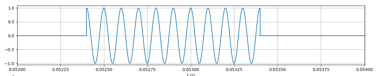

Oh yes, good analogy. And the sine burst is like opening a book in the middle, starting to read a page, and it begins in the middle of a sentence that means nothing.
By the way, why not use this test signal instead?
peufeu, can you read any page in the middle of a book? And why do you think that the amplifier should not accurately amplify any audio signals, the spectrum of which, according to some sources, extends up to 90 kHz or more. As for pulse signals, they are widely used for testing, such as rectangular.
An ideal amplifier (01 - no signal delay, group delay=0) does not introduce any distortion (neither vector nor speed).

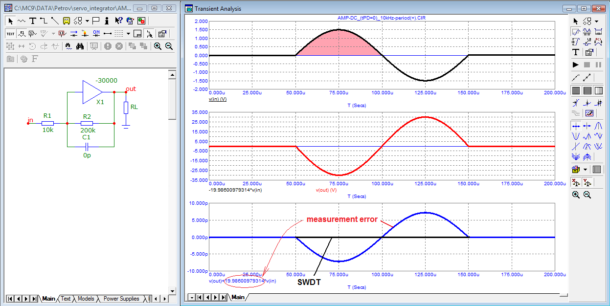

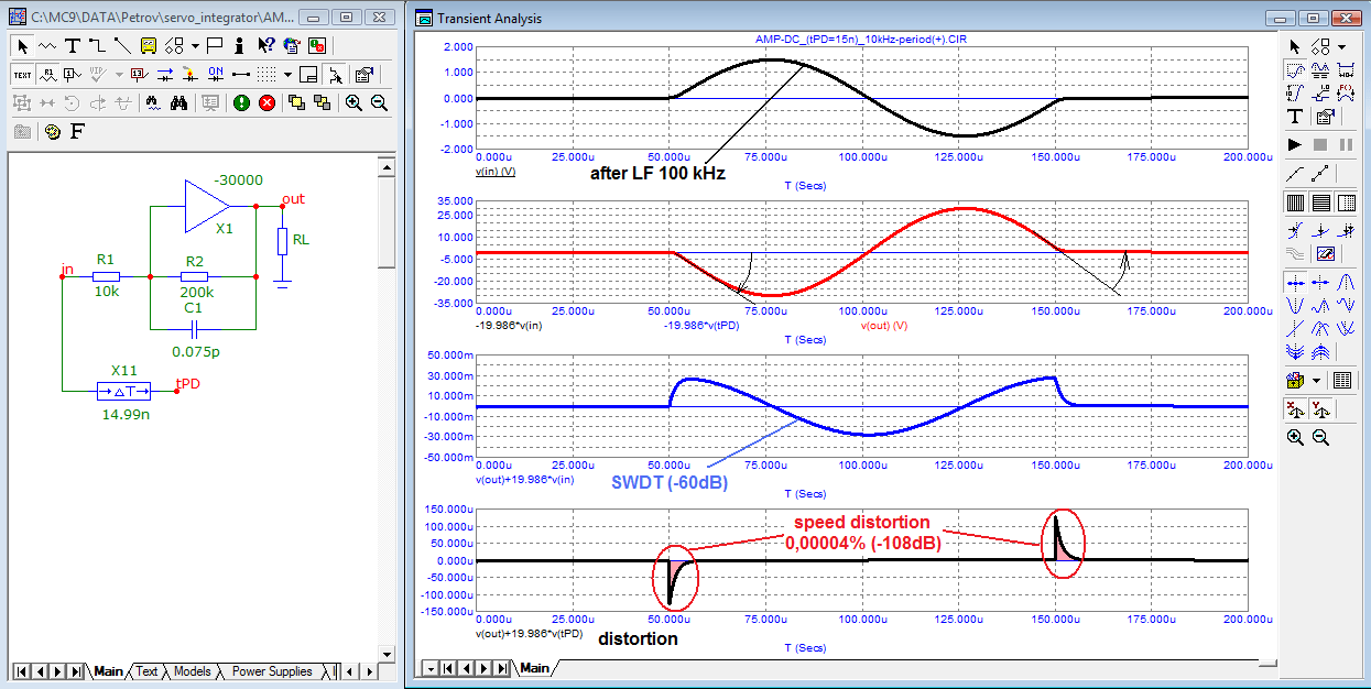

Even an ideal amplifier that does not introduce non-linear distortions, but has a signal propagation delay of 15 ns (02) introduces vector distortions up to -60 dB (SWDT test) and high-speed distortions, the peak level of which reaches 0.00004%.

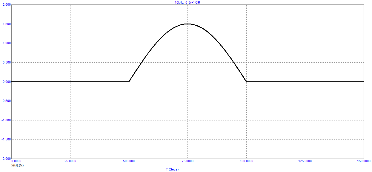

If I understood correctly the author of this post https://www.diyaudio.com/community/threads/sound-quality-vs-measurements.200865/post-2868515 guessed to use one half-cycle of the sine (03) to reveal the difference in amplification of signals by different amplifiers. And he found her.
In a real amplifier operating on a real load, along with a negative feedback signal, not only distortion products but also back-EMF signals from the acoustic system arrive at the summation point, which contributes to the expansion of the spectrum of harmonic components. At the same time, with significant delays in the passage of the signal, the smallest details of the sound material are smeared, the nuances responsible for the naturalness of the sound fall out, and higher harmonics are added to which human hearing is very sensitive. In this case, the sound becomes “dead”, different from live sound, and under certain conditions (depending on the group delay behavior not only in the audio range, but far beyond it) annoying - typically “transistor”.
It should, but the tests that will tell you if it does don't include using unlimited bandwidth signals that can only exist inside a computer...And why do you think that the amplifier should not accurately amplify any audio signals
Sure, but you did not model an ideal amplifier with 15ns delay. You modeled a first order lowpass filter with -3dB frequency at 10MHz and a gain of 19.986. Then you compared its response to an ideal amplifier with 15ns delay and found a difference ;DEven an ideal amplifier that does not introduce non-linear distortions, but has a signal propagation delay of 15 ns (02) introduces vector distortions up to -60 dB (SWDT test) and high-speed distortions, the peak level of which reaches 0.00004%.
SWDT without compensating for delay is meaningless, so I'm not looking at the middle plot.
The label "measurement error" corresponds to the gain being 19.986 and not 20, of course.

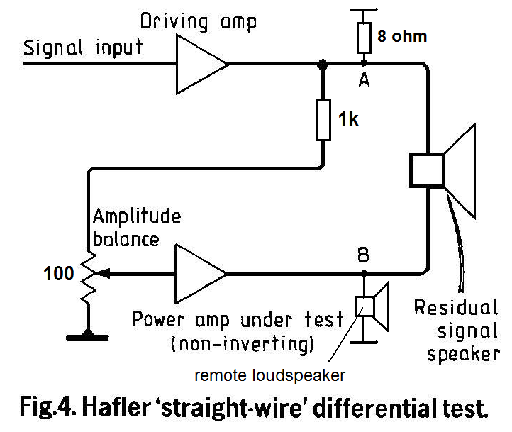

SWDT according to Hafler is nothing but vector error according to Jiri Dostal.
vector errors are measured as is, without delay compensation. Compensation method for measuring all types of distortion provides for delay compensation
Vector error is important if the circuit will mix the input and output signals, in this case you want to know what kind of phase shift will occur. Not the case for an audio amplifier, in this case it makes sense to use delay compensation.

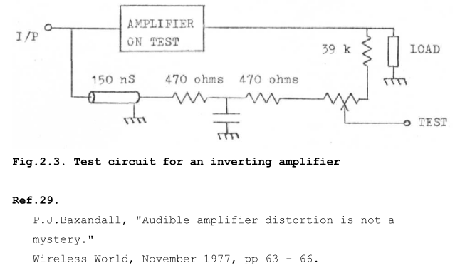

the Hafler test measures vector errors (what Dostal described), and the Baxandall test is a compensation method for measuring distortion at the input signal level. The output signal of the amplifier under test is then normalized to the level of the input signal. At the same time, the distortions introduced by the amplifier are also weakened by a factor of Ku. To improve the accuracy of measurements, it is better to measure at the output voltage level of the amplifier. To do this, the input signal must be normalized to the output level and delayed by the group delay of the amplifier.

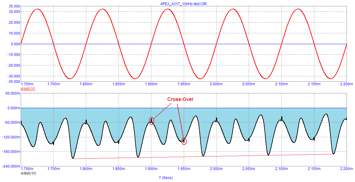

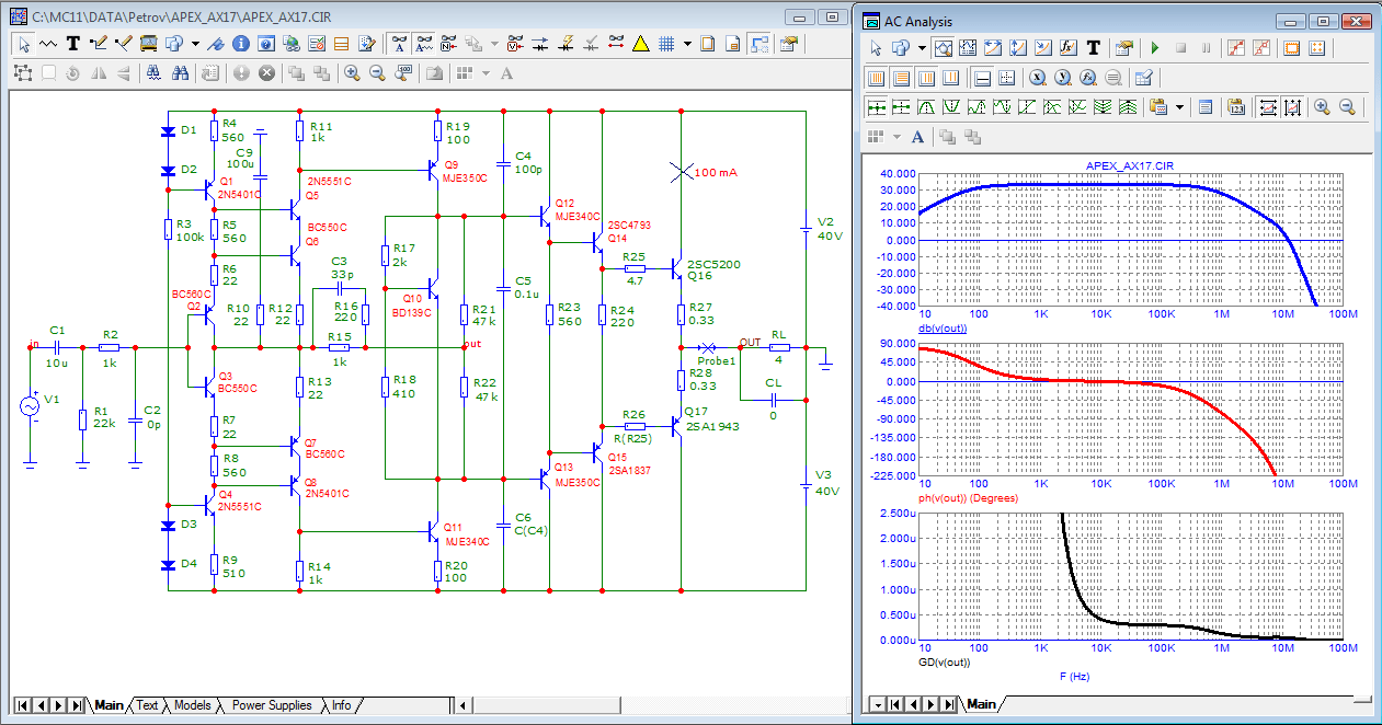

It is known that the main distortions are introduced by the output stage. Cross-Over distortion is highly dependent on the quiescent current. In class AB amplifiers, the emitter resistors of the output transistors also affect crossover distortion. Therefore, you have to choose a compromise between temperature stabilization and crossover distortion.

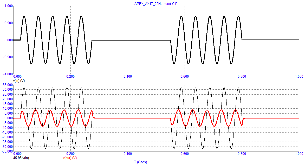

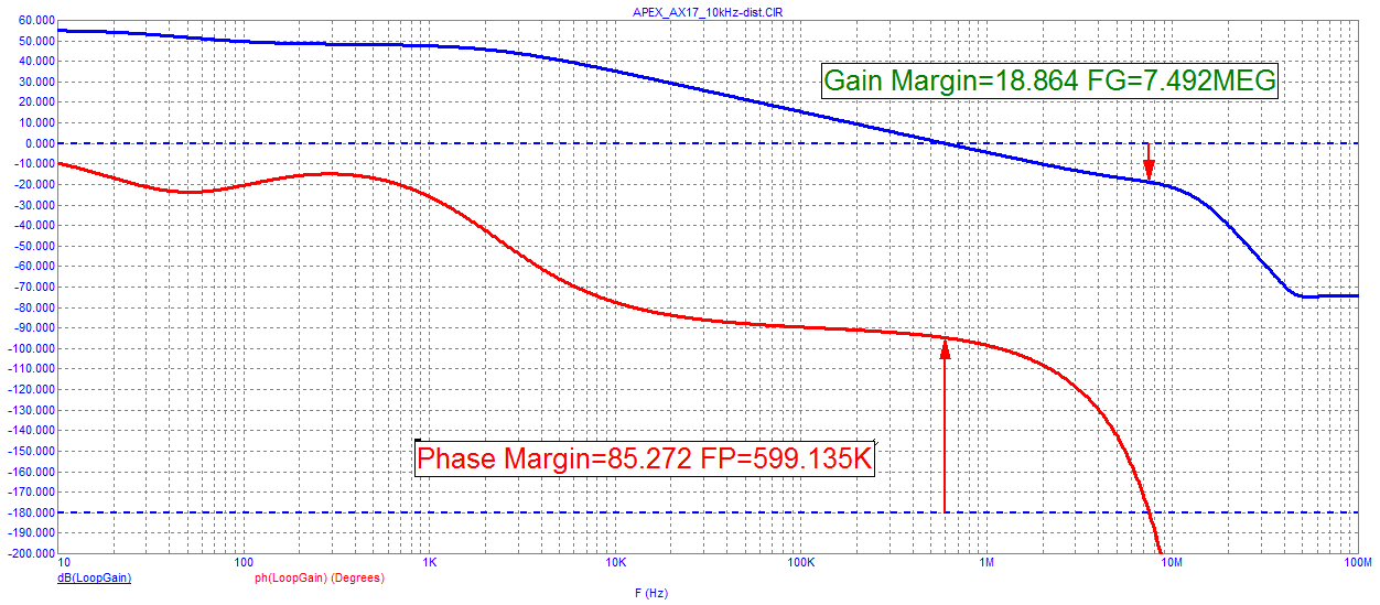

For cloning, the relatively simple APEX AX17 amplifier is popular among radio amateurs. Let's take a look at its main characteristics: Bode diagram, loop gain, distortion at a frequency of 10 kHz and a burst at a frequency of 20 Hz.
From the Bode diagram, you can see that the bandwidth at the bottom is -3 dB at about 70 Hz! (Fig. 01). Group delay above 10 kHz is about 300 ns (which would seem not so much compared to other amplifiers). The loop gain in the audio band is not constant, in the low-frequency region about 50 dB, and at a frequency of 20 kHz - 30 dB.
The distortion products of a 10 kHz signal even at the 22-nd period have a significant DC offset, the transient process is still far from over. The distortion products show a small amount of crossover distortion compared to non-linear distortion. The input burst with a frequency of 20 Hz is passed through a 100 kHz filter, while the output signal has clearly expressed both linear distortions (low output signal amplitude) and significant waveform distortions, especially in the first period and at the end of the bursts.

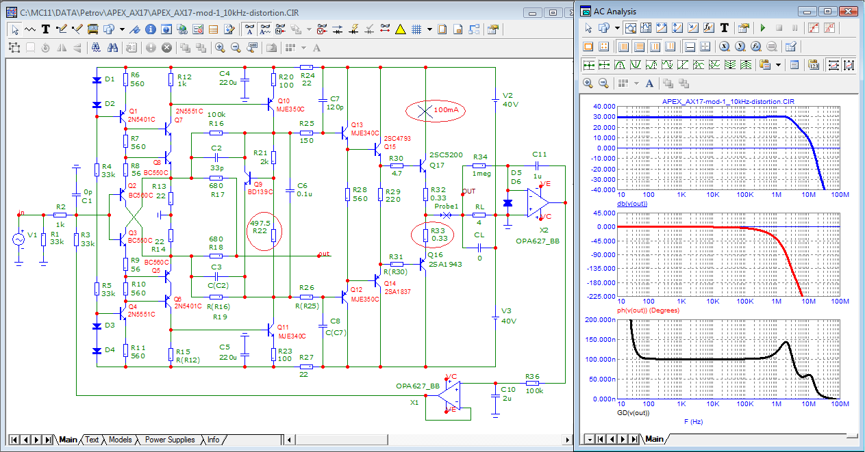

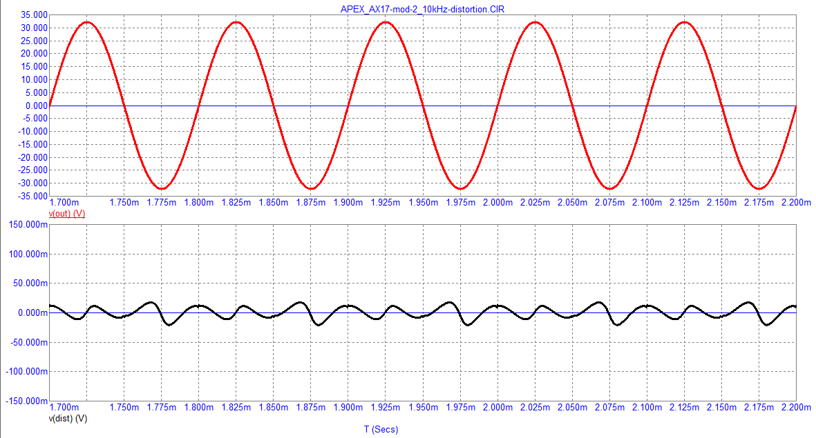

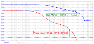

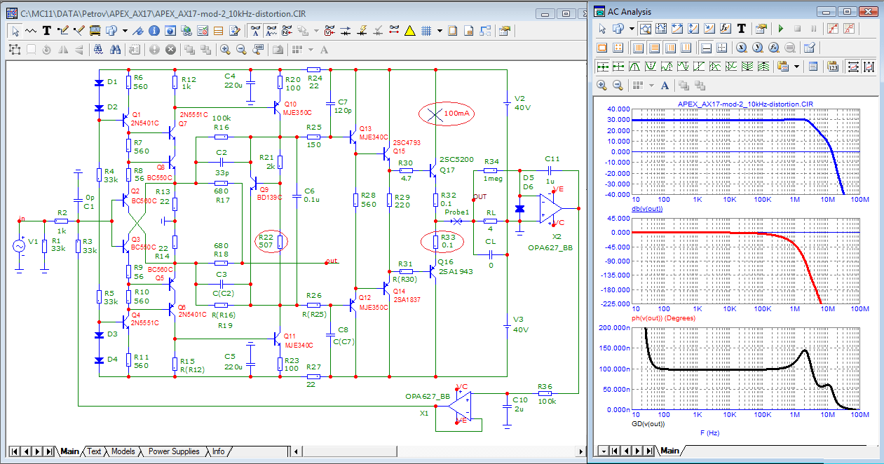

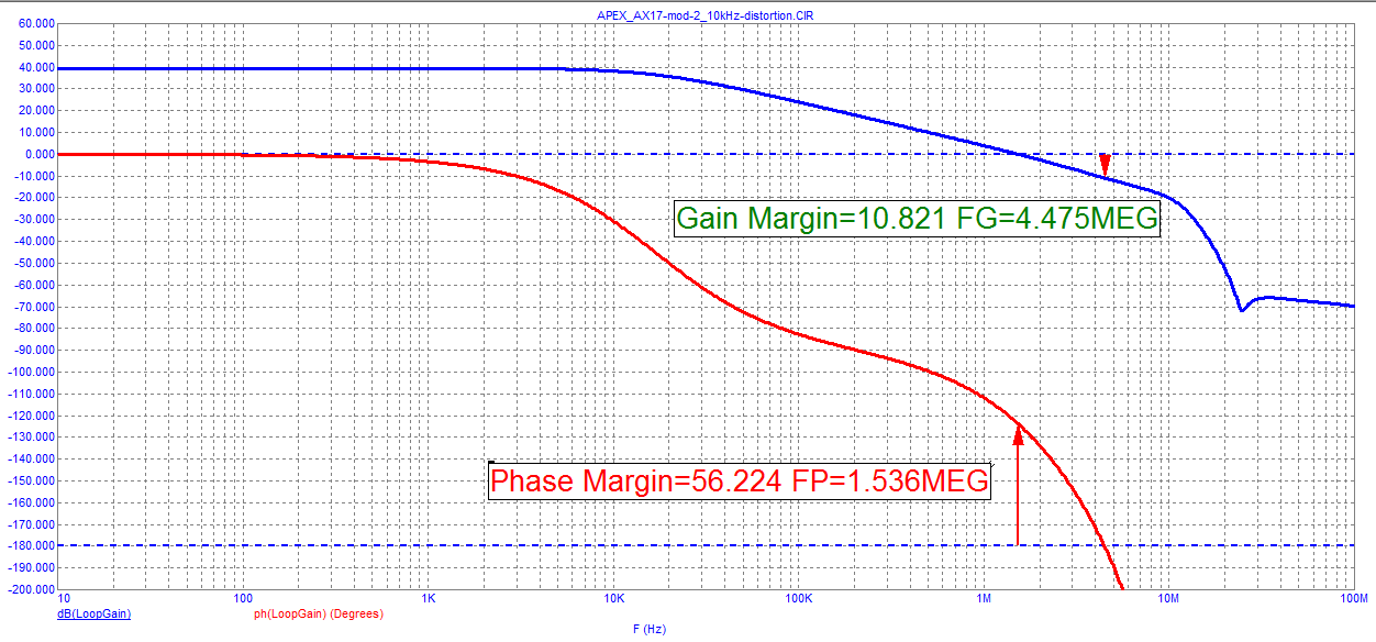

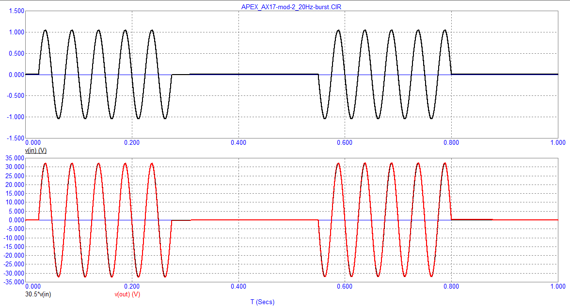

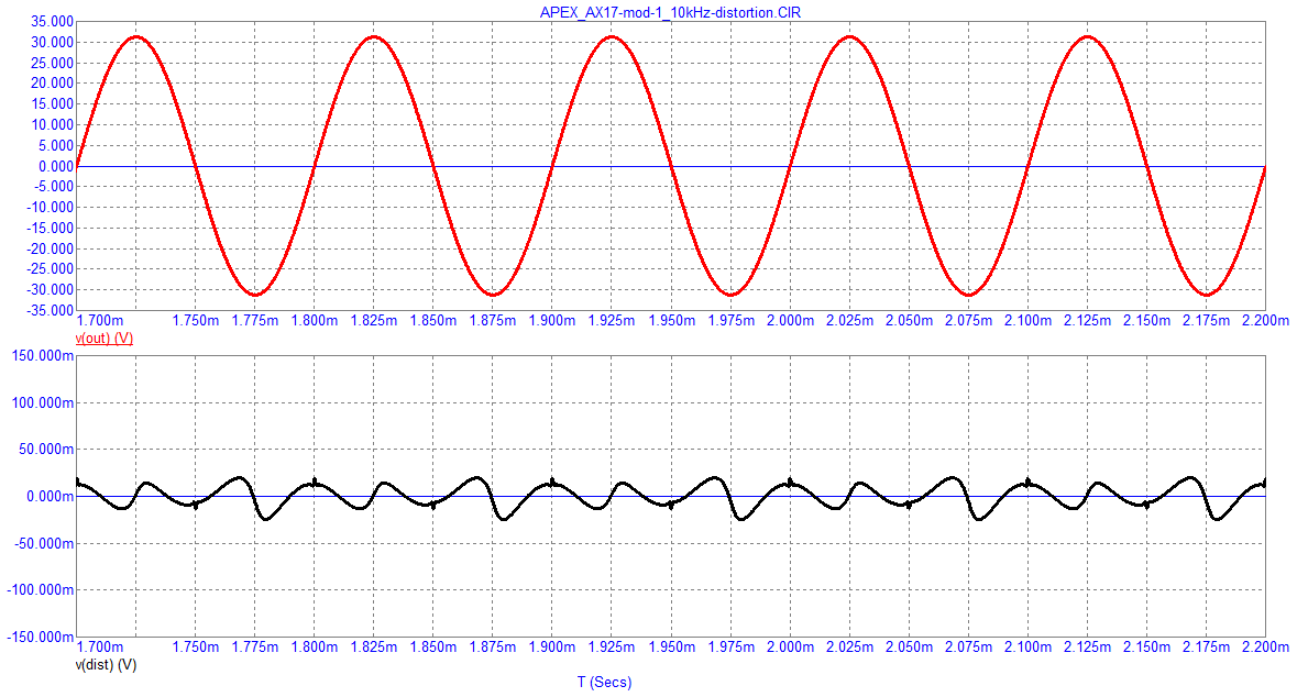

Let's try to reduce the signal propagation delay time in the entire audio range. To do this, we will turn the amplifier into a DC amplifier using an integrator and slightly alter the VAS.
It is known that the main contribution to the nonlinear distortion is made by the output stage. Therefore, for the purity of the experiment, we will leave it unchanged (with the same current modes). As a result of a little refinement, the loop gain is about 40 dB and is constant throughout the entire audio range. The distortion products of the 10 kHz signal are significantly reduced and have no DC bias. The 20Hz burst signal is also amplified without visible distortion.
In order to reduce switching distortion, emitter resistors are reduced from 0.33 Ohm to 0.1 Ohm. But even with 0.33 Ohm resistors, switching distortions are small due to the group delay reduction by more than 3 times.
