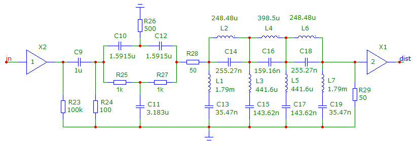

Yes, but you can google twin T notch filter. Its simple design. Im using 1k and 2k trimmers with 200ohm multiturn trimmers in series and 10nF ceramic capacitors (bad choice, they are too temperature sensitive).

Passive.
But Im working on with active, variable Q filter using dual op-amp 🙂

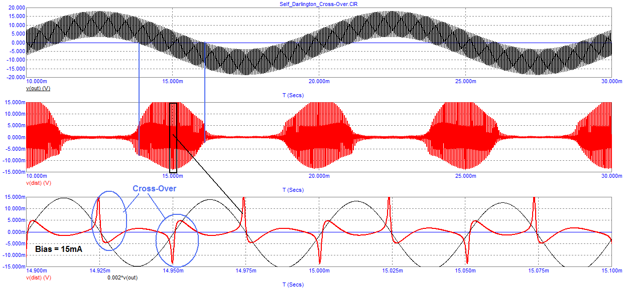

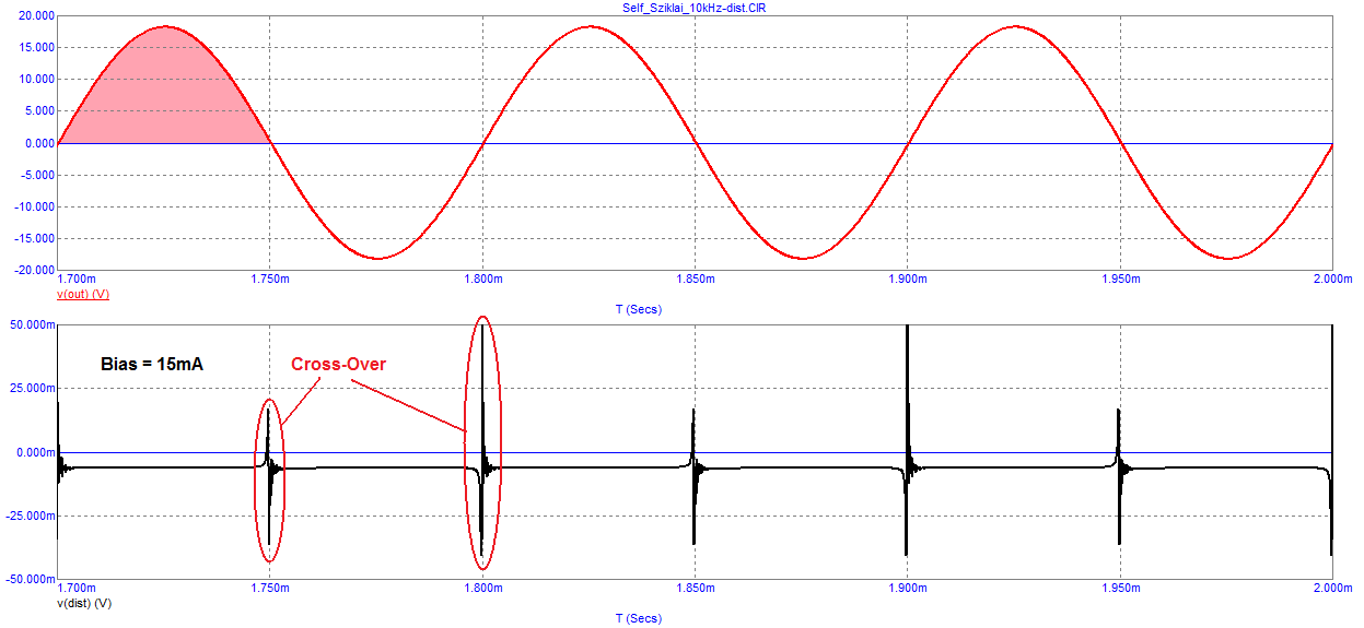

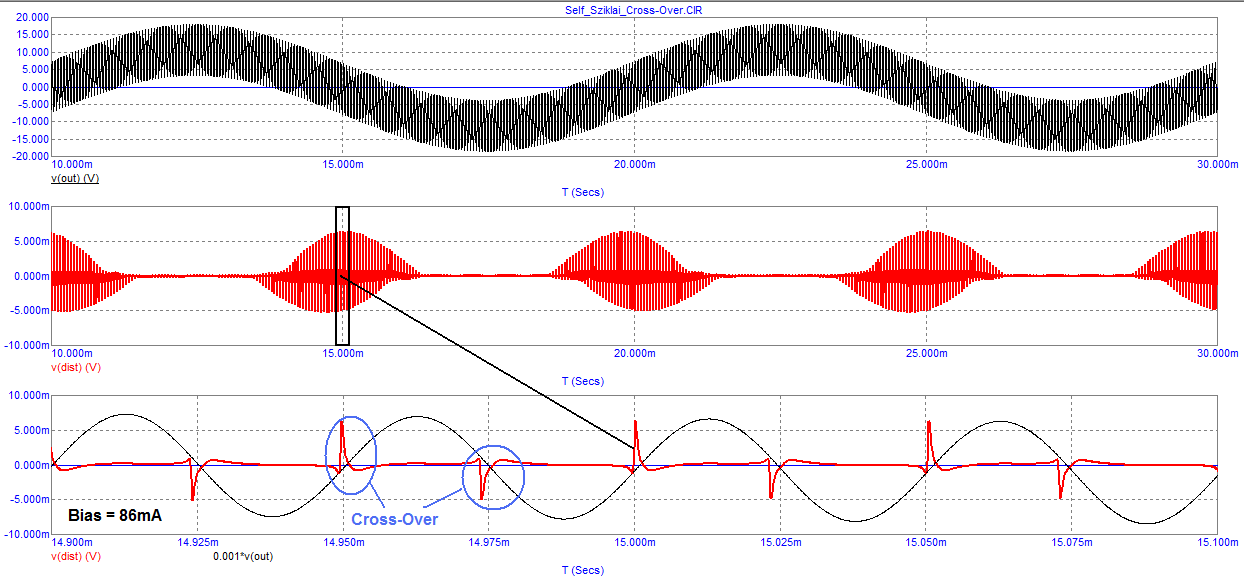

examples of crossover distortion versus quiescent current are shown here:

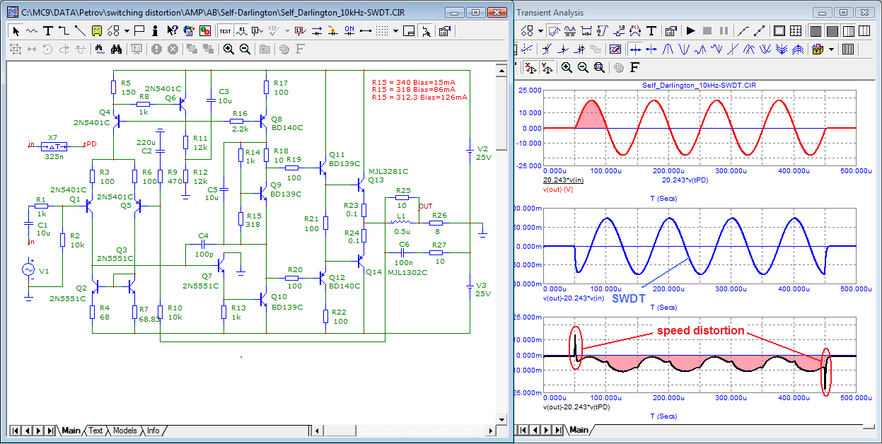

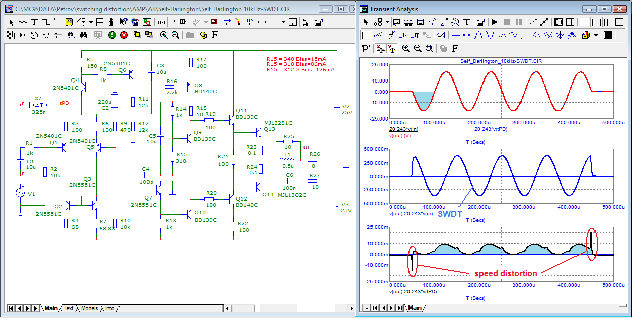

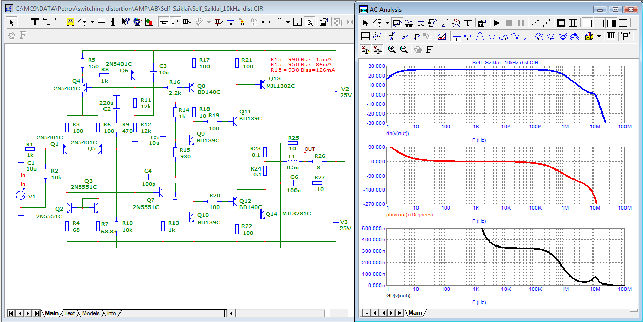

Regarding the work of negative feedback in audio frequency amplifiers, Kirill Hamer spoke competently in an interview with the magazine.
His statement is confirmed by David Hafler's SWDT test.

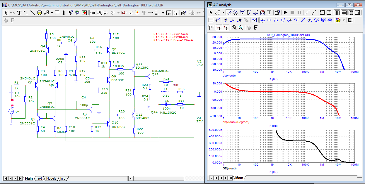

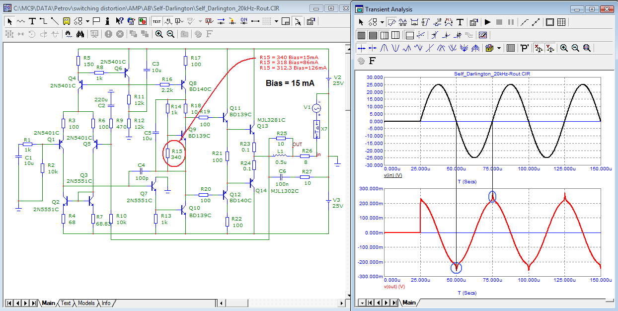

As an example, let's take a typical amplifier repeatedly described in various sources.

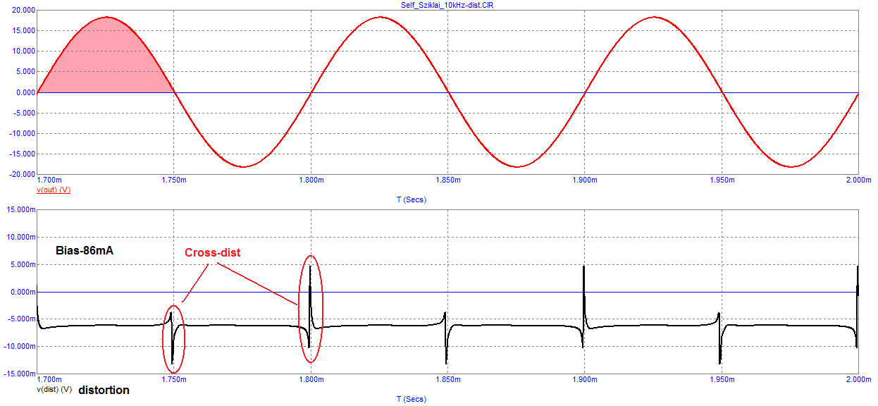

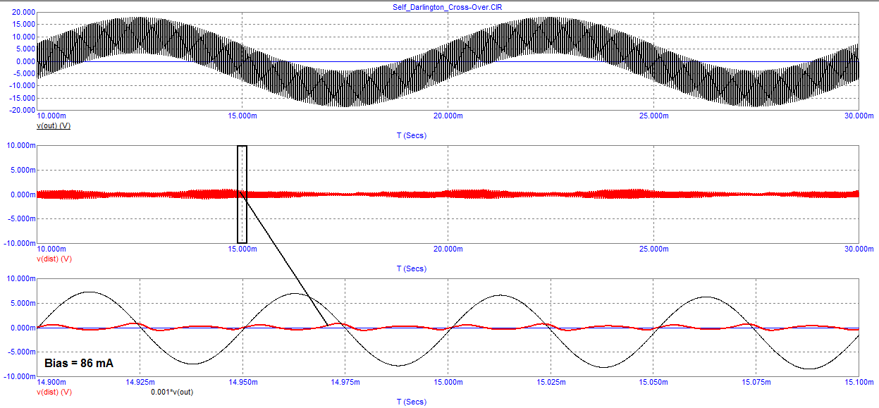

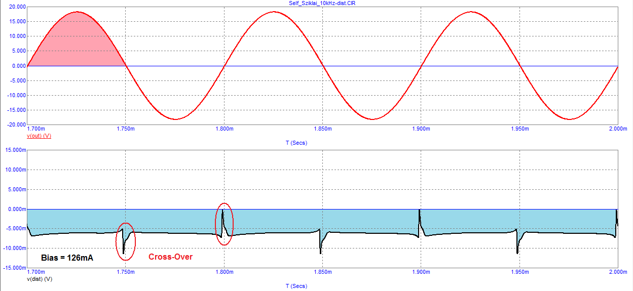

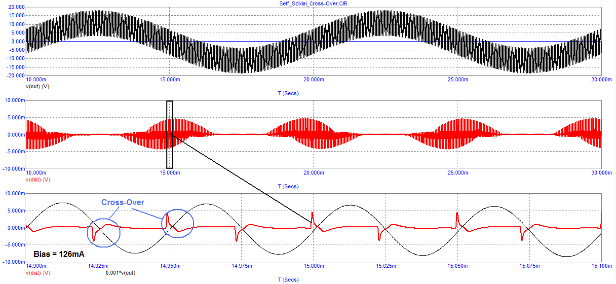

The situation is better with the Darlington "two" output stage at the same quiescent currents. However, due to the relatively large signal propagation delay time, the peak value of high-speed distortion is greater than the level of non-linear distortion.

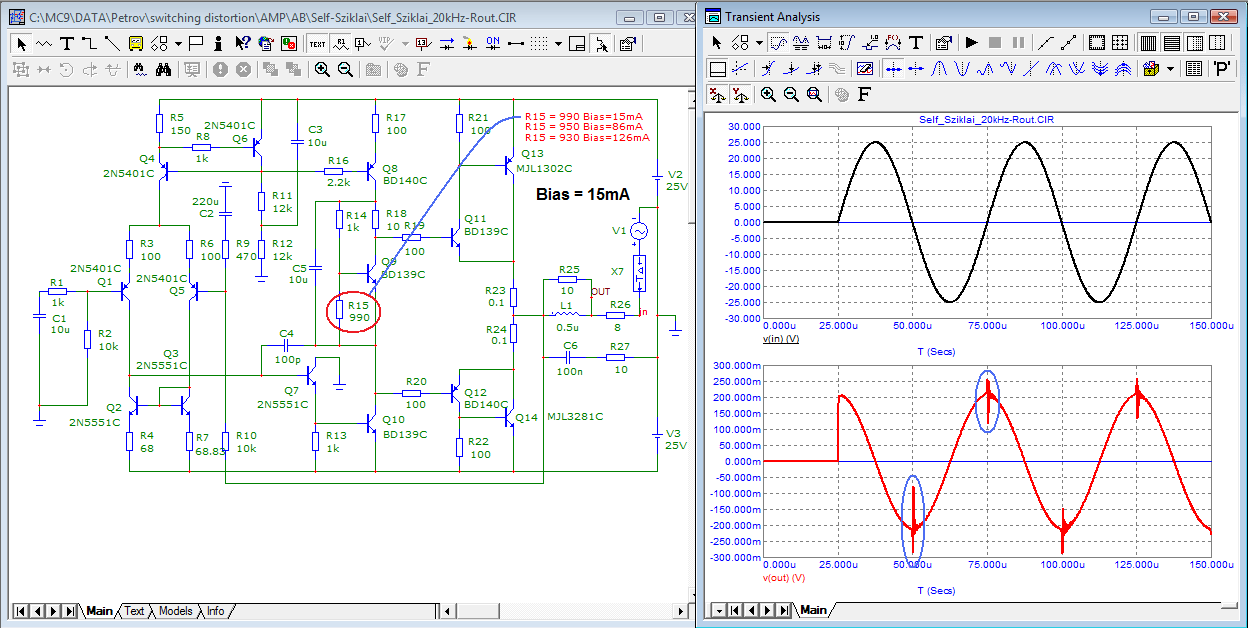

Yes, static crossover distortion is just another name for "current-dependent nonlinear output impedance variations"... To nitpick, I would not put the spikes due to transistors that turn off too slowly in the "output impedance" category, but this test will cause them to show up regardless.this method is usually used to measure the output impedance of an amplifier.
CFP/Sziklai is absolutely terrible in this regard, unsuitable for class AB, only for class A

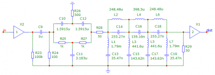

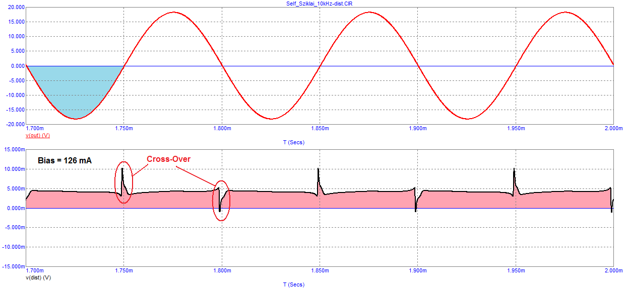

Crossover (switching) distortions appear mainly in class AB amplifiers with global negative feedback having low speed.
The feedback speed depends on the signal transit time (time Propagation Delay), in other words, on the signal arrival delay at the comparison node.
Until now, the main attention has been paid to THD measurements, which are carried out in a steady state and do not reveal many types of really introduced distortions, such as: high-speed distortions, the appearance of a constant component depending on the polarity of the first half-cycle of the signal, and others.
Not all radio amateurs have access to professional measuring equipment. But even with professional equipment today, audio equipment designers first design circuits and test and optimize their parameters in simulators.

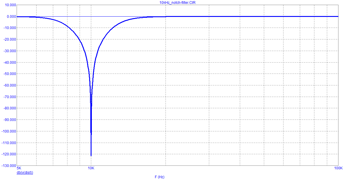

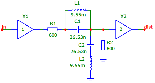

The simplest way to isolate the distortion products of a given frequency is to use notch filters.
Two filters are offered to the attention of radio amateurs.
Transients in a 10 kHz notch filter take about 15 periods (1.5 ms), so when using such a filter, set the test time to 2 ms or more and look at the distortion products after 1.5 ms. In a number of amplifiers, a constant component appears in the products. In such cases, change the polarity of the input signal and test again.

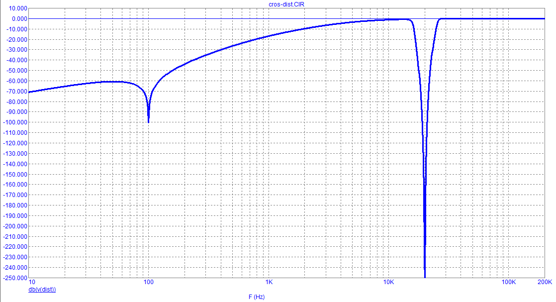

Transients in the 100 Hz and 20 kHz filter take 5 to 10 ms. Therefore, when testing, we set the time to 30 ms and look at the distortion products after 10 ms. If necessary, we stretch the area of interest to us.
