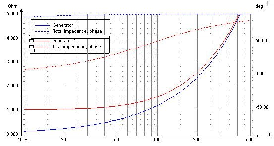

Check your imp. mag. scale. Should be log for starters. You should see the lower one being resistive instead of inductive at low f.
The scale is just like that. The resistive part is a bit different, but normally when we do XO analysis, no software distinguishes the difference between these two in terms of the impedance phase even though both are labeled the same unductance value. Surely this will effect speaker response.
Well, try changing the scale so that it´s from 0 to 10 ohms. You should see what I mean...

The XO software should calculate the phase correctly. This is from LspCAD simulating a 1.9 mH inductor with (almost) 0 DCR and with 1 ohm DCR. That said, I'd expect your top graph to show more phase droop down low so I don't know what's going on there.
attachment.php
I see. Never thought that little bit of resistance (0.5ohm in my case) would make that much difference in the phase. But has anyone measured how this difference would effect the low frequency response. Since the impedance phase has so much variation, there should be some measurable and audible difference.
The phase angle is between the resistive part and the reactive part. 45 deg would mean equal magnitudes ie. 1 ohm resistance, 1 ohm reactance. Easy to calculate.
Yes. The series resistance of the inductor needs to be added into the passive crossover design. The resistance causes loss and the "apparent" load is higher so the coil needs to be larger obviously. The change is phase should show up in the model with the driver. All these factors do pretty much exactly what one would expect. Higher Q in the sealed box, lower sensitivity of the driver, less control over driver motion because of the resistor in series with the low output impedance amplifier, more dynamic compression because of the lack of control and so on.

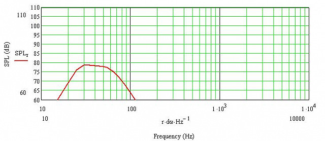

my series resistance experiment with an OB sub some time last year:
"I added 9.2 Ohms of series resistance to my OB sub, a Hawthorne 15" Augie. I was basically trying to see what the Carver Amazing Loudspeaker might have sounded like and squeeze more deep bass out of the Augie. There was a suitable resistor (e.g. 9.2 Ohm 1% 50 watt) available at a local surplus supplier HSC Electronic Supply - Silicon Valley's Electronic Marketplace for $1.75/ea, so I decided to give-er-a-go. Fancier circuits could have been and still can be implemented that waste less power, but this was quick and easy.
My baffle is 2 ft tall by 3 ft wide which is larger than most anyone uses with an Augie and considered more than optimal by most Augie users. I just had not bothered to cut the board I bought for the purpose of baffling the Augie b/c it used to fit so well under the TV. The theory of operation here at HA, which is not new and has been used "for many long years I know"(for Blues fans), is that you can use a thinner baffle than what would be calculated to mount a highish Q woofer b/c the added bass boost at resonance will compensate for the roll-off caused by the the baffle width. The 2 responses will combine and make a nice, smooth, extended bass response to somewhere near driver resonance. From my limited understanding it seems reasonable enough. So the Solo/Duet is 24" wide and the Amazing Loudspeaker, from what I can find on the web, is 30" wide at the bass but thinner at the top. Not all that different but the frequency extension of the Solos is usually measured somewhere between the mid 40s to 50s by the users capable of doing so while the Amazing supposedly does 20Hz (though I haven't seen that measured anywhere). I don't recall anyone stating how deep the Augies went in their rooms. I know from experience that it sounds deeper then the PSI by itself.
The Qts of the Amazing woofer according to many sources on the Web is around 3, the PSI and Augie are more near a normal 0.9. The resonance of the Augie is 27Hz where as the Amazing woofer is usually stated as 22Hz. The equation for adjusting woofer Q with series resistance according to True Audio: Audio Spectrum Analyzer and Loudspeaker Design Software is given as Q(tc) = Q(tco) ( (Re + Rg)/ Re ). The relevant Augie specs are given as Re: 5.69 Ohms and Qt: 0.92. Plugging the numbers into the equation with the 9.2Ohm resistors gives us Q(tc)= 0.92 ((5.69+9.2)/5.69). Our new Q(tc) is then 2.4 if I did my math correctly. That's close enough to the Amazing IMO to see what the effect may be and my additional baffle width will maybe compensate for my lower Q(tc). Of course my Resonant Frequency is also 5Hz higher, but I just don't feel like cutting my baffle today .... This also means that I have virtually no DF, but prior experience has left me unconvinced of it's worth anyway. YMMV
I have no measuring equipment, but listening impressions basically go like this: Augie w/o resistor is putting out a lot more midrange, but apparently less deep bass. As far as bass quality goes (the usual fast vs. slow bass argument) I can't tell the difference. YMMV on that one as well. Many people claim to hear the effect, but I discovered today that I really cannot. At least not easily. Sort of a bummer. I was always hoping for the magic Q(tc) of 0.5 to cure all that ales my bass. Just yesterday I thought that the quality of bass was mostly determined by Q(tc). Now I don't know what to think. I mean I also thought that OB bass was less affected by the room than boxed bass. Perhaps this is untrue as well? If there isn't any perceivable difference in quality, might the room and room modes still have a profound effect on the bass we get from OB? I don't know, just thinking out loud. There are a lot of factors that could be at play here. B_Y3P!
Just a note on the set-up: I've got a 24 db/octave LR x-over set just below 60Hz, a 250 watt amp driving the Augie and 25 watt amp on the PSI.
Here are some computer simulations of the 2 different responses courtesy of Scorpion from Audio Circle:
withought added resistance

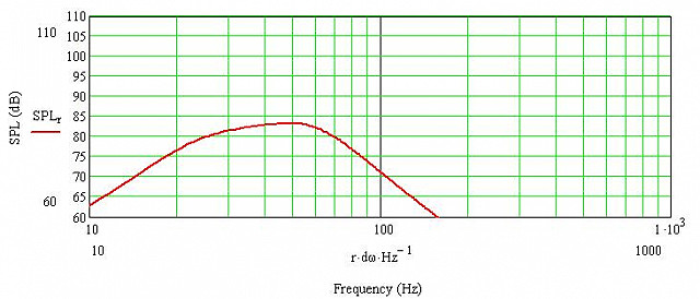

with 9.2Ohm resistance

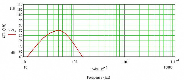

U Baffle

As far as I know these don't take the room into consideration though. With the decreased efficiency I have bottomed the Augie out for the first time during an explosion on a movie but apparently did no damage."
