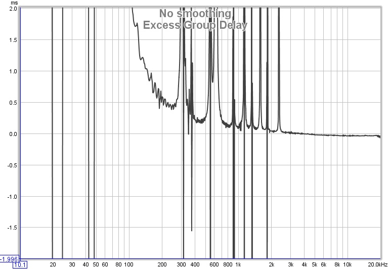

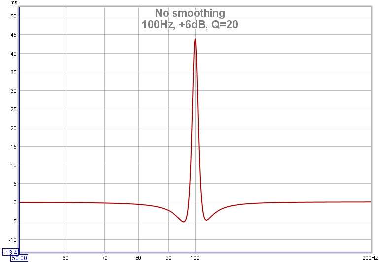

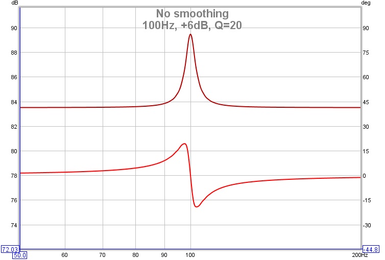

One thing that I found during some measurements, is that the impedance phase of an air core inductor is different from a cored inductor. I'm sure this is going to have some effect on system performance, but I haven't explored it too much.
Excess group delay is, I believe, covered in detail in Joseph D'Appolito's "Testing Loudspeakers", but it is easy to explain - it is simply the group delay calculated from the excess phase. In a loudspeaker measurement context the main uses for excess group delay are to examine drive unit time alignment and to determine measurement delays to permit correct (delay-free) phase information to be displayed. As the excess phase is largely free of the response related fluctuations of the system measurement (except where those deviate from minimum phase behaviour) the excess group delay shows the time alignments and delays much more clearly than the measured group delay.I've heard of excess phase and group delay but not excess group delay.
The measurement would certainly be much cleaner in an anechoic environment, but it is misleading to say the spikes are computational artefacts - they are a faithful reflection of the behaviour of the measured system, including the contribution of the environment in which the speaker or drive unit was measured.These are for the planar speaker of post #1090, right? It appears that the curves were taken under non-anechoic conditions. As such the "hash" in the response curves give rise to similar hash on the phase curve. Differentiating the phase curve turns the high slope of the phase curve hash into sporadic spikes. It is a measurement and computational artifact. It is not a characteristic of the driver. (It would totally go away when measured under anechoic conditions.)
There is no autoscaling, but the plot does cover a large span. Here it is for a span 100 times smaller, again with no smoothing. The excess group delay is very flat above approx 2.5kHz because the measurement is very close to minimum phase in that region and hence measured phase and minimum phase move in concert.Another clue would be the level peaking to 150ms. The curves are flat between the spikes because the autoscaling has been dominated by the extremely high spikes, compressing any true info between the spikes.
That is a rather strange comment. The sound doesn't need to "go" anywhere to have a large group delay, the plot is showing us how the different frequencies in the measurement are affected. As a much simpler example, below is a measurement of the amplitude, phase and group delay of a simple 2nd order parametric filter, +6dB at 100Hz, Q=20. The group delay at the filter's centre frequency is a little over 43ms (excess phase and excess GD are zero for this example as this is an entirely minimum phase system).(At about a ms a foot, where would the sound go for 150ms?)
I hope that helps clarify excess group delay somewhat, though having read through some of the postings in this thread learning from one another does not appear to be high on the agenda.
Thanks for the explanation. I am used to seeing the terms independently but not together. I've never had trouble using group delay curves of systems to guage the delay in the woofer region, the delay in the tweeter region, and hence the relative arrival time differences.
The context was "here is a driver and its measurements". The discussion then became whether it (the driver) was minimum phase or not. If the measuring environment was leading to a conclusion that the driver wasn't minimum phase, then I would consider that misleading. I still maintain, and it seems Earl agrees, that the spikes are as likely an artifact of the differentiation process. They certainly aren't characteristic of the driver.
I am also uncomfortable with a notion that the spikes in the excess group delay curve represent burst of non-minimum phase behavior and the flatter regions contained within are minimum phase. Most of the non-minimum phase systems I've seen would have an excess phase curve that would be definable by an allpass of some complexity, rather than seemingly random spikes. Just never seen that before. Perhaps I'm starting to agree with Earl here that acoustic response in a room isn't well suited to the MP notion.
Perhaps a bit of hyperbole on my part, and yes, high Q resonances can lead to rapid phase shift, hence large group delay. I'd still lay money that a number of delay spikes all near 150ms, is a computational artifact. What would you attribute it to?
Indeed.
