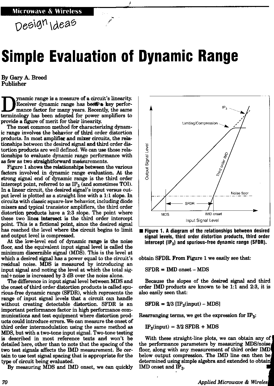

So the "compact impulse response" or lack of "tail" or other names for the same things should be called signal to noise ration at a particular frequency and SPL. Speakers with no drive make little noise (noise being anything including distortion not in the original signal) however, the noise increases with increasing drive. This idea names a way to actually specify the results with numbers rather than "see it is better!"
Have long measured signal to noise ratio and dynamic range at different SPL and frequencies to quantify driver behavior. This idea moves these concepts from pseudo-science into quantified data. Now please, I am not saying any of the non-quantified method is bad but again, it produces no numeric values so different transducers cannot be compared.
Just to help a little have attached a simple explanation of dynamic range WHICH IS NOT signal range. This is written for RF amplifiers but the concepts are valid for transducers as well.
