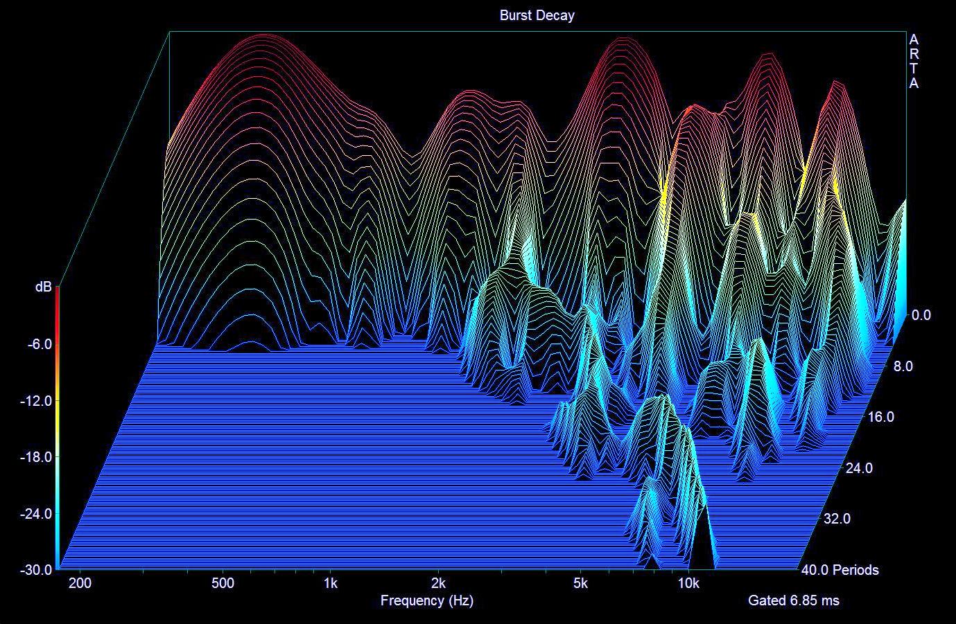

Besides a uniform or at least "smooth changing" dispersion with frequency,
i regard CSD's highly. To me there is a clear correlation between sound
quality and CSD although the importance of fast decay lowers IMO at
the ends of the audio spectrum, especially at the upper end.
In my experience a bit ringing above say 8 Khz is not that critical
than in the presence region from 2..6 Khz. Also the bass to midrange
region should be as "clean as possible".
For the frequencies below the Schröder frequency of the room,
things seem a bit tricky.
The more balanced the room modes are, the more a speakers
misbehavior gets into focus.
But i feel even in a mediocre room it is audible whether a speaker
produces a "smeared" bass or not. I know that some do not share
this opinion.
I did some "burst decays" whith ARTA under suboptimal conditions,
there are some reflections visible in the measurements.
But the burst decays shown clearly correlate with the sonical quality
of the three speakers (quality not meant necessarily in terms of
"good" and "bad").
I the burst decays the "time" axis is normalized to periods and
not in absolute time. This means compared to a CSD the decay
at higher frequencies is made more stretched and visible.
