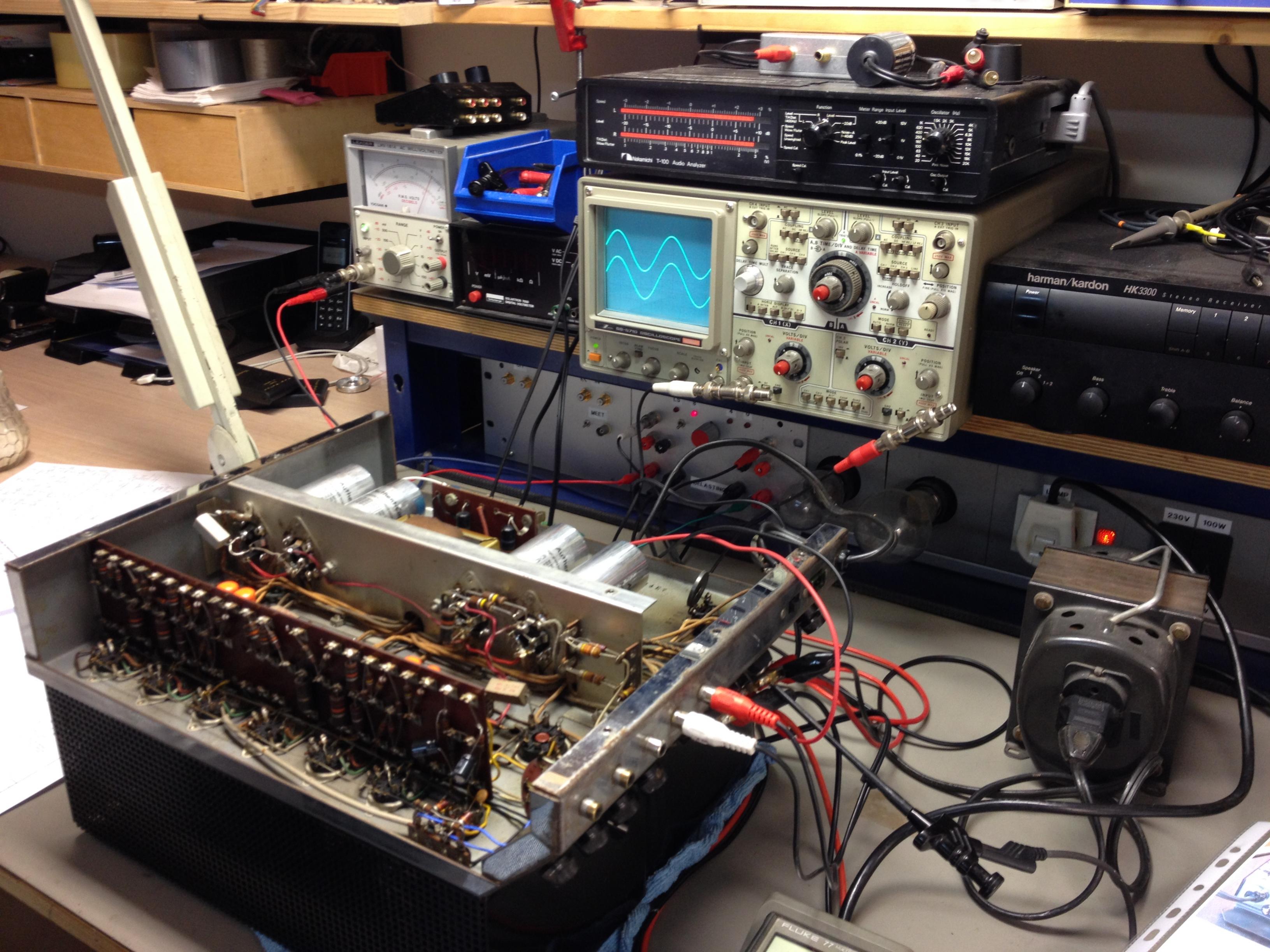

Tonight we had our session measuring the MC275.
The amplifier was fed with a 400 Hz signal.
Voltage at the 8 ohm loudspeaker output terminals was 2,66 VRMS.
This is a little under 1 watt of output power; the loudspeaker terminal was actually loaded with a 9 ohm resistance (the 8 ohm tap is actually 9 ohm to have the same load wrt the 4 and 16 ohm taps).
Then we measured the AC voltages at the grids of the KT88 power tubes; this was done referenced to ground.
At both grids the AC voltage was 15,5 VRMS.
Then measurement of the AC voltages at the plates and cathodes of both KT88's; all four values the same at 11,7 VRMS.
The output transformer has a step down ratio at the 9 ohm tap of 16:1, the load impedance of the output stage therefore is 16² x 9 = 2k3.
When we calculate back from the loudspeaker terminal, the total push-pull output swing of the KT88's must be 2,66 x 16 = 42,56 VRMS.
We measured the plate and cathode voltage swings already to be 11,7 VRMS each; the total output swing of the tubes therefore is 4 x 11,7 = 46,8 VRMS.
This is slightly higher than the value of 42,56 VRMS; this difference is the insertion (copper) loss in the output transformer (0,8 dB in this case).
So to get 46,8 VRMS out of the pair of KT88 tubes there was 2 x 15,5 VRMS = 31 VRMS at their two grids.
The voltage gain of this output stage therefore is 46,8 : 31 = 1,51.
This confirmed my measurements a couple of years ago: the output stage behaves as a composite cathodyne phase splitter with a maximum theoretical gain of 2 in case of being unloaded. Because of the 2k3 load impedance the real voltage gain is 1,51.
So yes, there is voltage gain in the output stage.

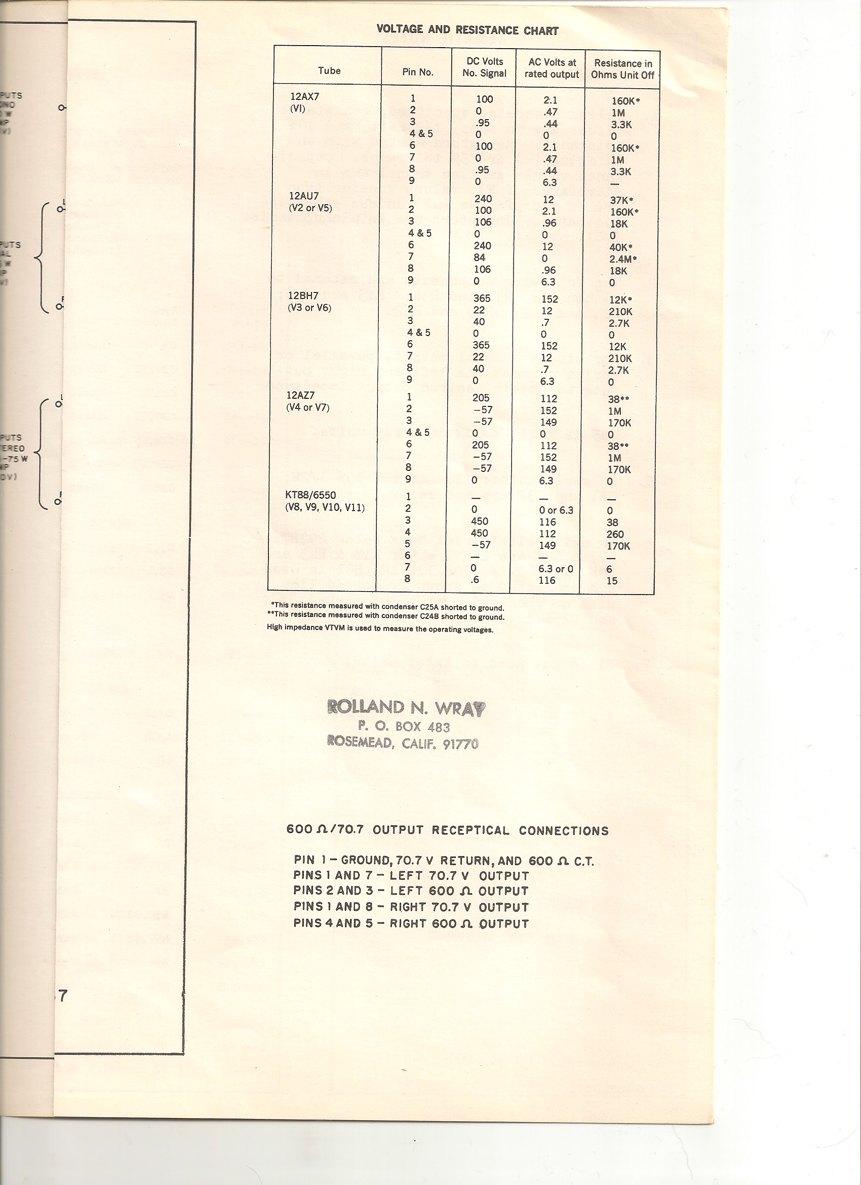

My friend is well documented with MacIntosh manuals; below you see the voltage and resistance chart as printed on the MC275 manual; look at the AC Volts at rated output.
The values on this chart confirm our measurements:
KT88 pin 5 (grid) 149V; pins 3 and 8 (plate and cathode) both 116V.
So the same voltage gain of a little over 1,5 (2x116 : 149).

First problem is you need a way of verifying the PHASES of your measurements.. If you verify the phasing of the waveforms in the windings sections you would see they could not ever add up the way you added them up...scope the waveforms with diff probes with respect to each other see the phasing.. If you truly knew the number of turns in the original transformers you would not have made the assumptions you made..
Bi-Filar windings do not SUM...they are in PARALLEL...
You feed in a 31V diff grid signal into this stage and you get a 23.4V Diff signal across the each of the paralleled windings... (.869 x .869) x 31V = 23.4V ... The only thing that SUMS is the 2 plate sections that are in SERIES, which is 11.7V + 11.7V .... The CATAHODE sections also SUM the same way as well..
Both PLATE and CATHODE Bi-Filar windings are in Parallel and in Phase and centered taped with respect the GND...
This is stage gain of approx. .75 ...
The bifilar windings are: cathode of tube 1 and plate of tube 2, then the other bifilar winding is cathode of tube 2 and plate of tube 1.
Just sum the cathode and plate AC voltages for one tube (the magnitudes), then divide by one AC grid voltage. Gain 1.5
If there is no load OR if the tube has infinite gm, the gain goes to 2.
Same as a Circlotron, which it is EQUIVALENT to.
