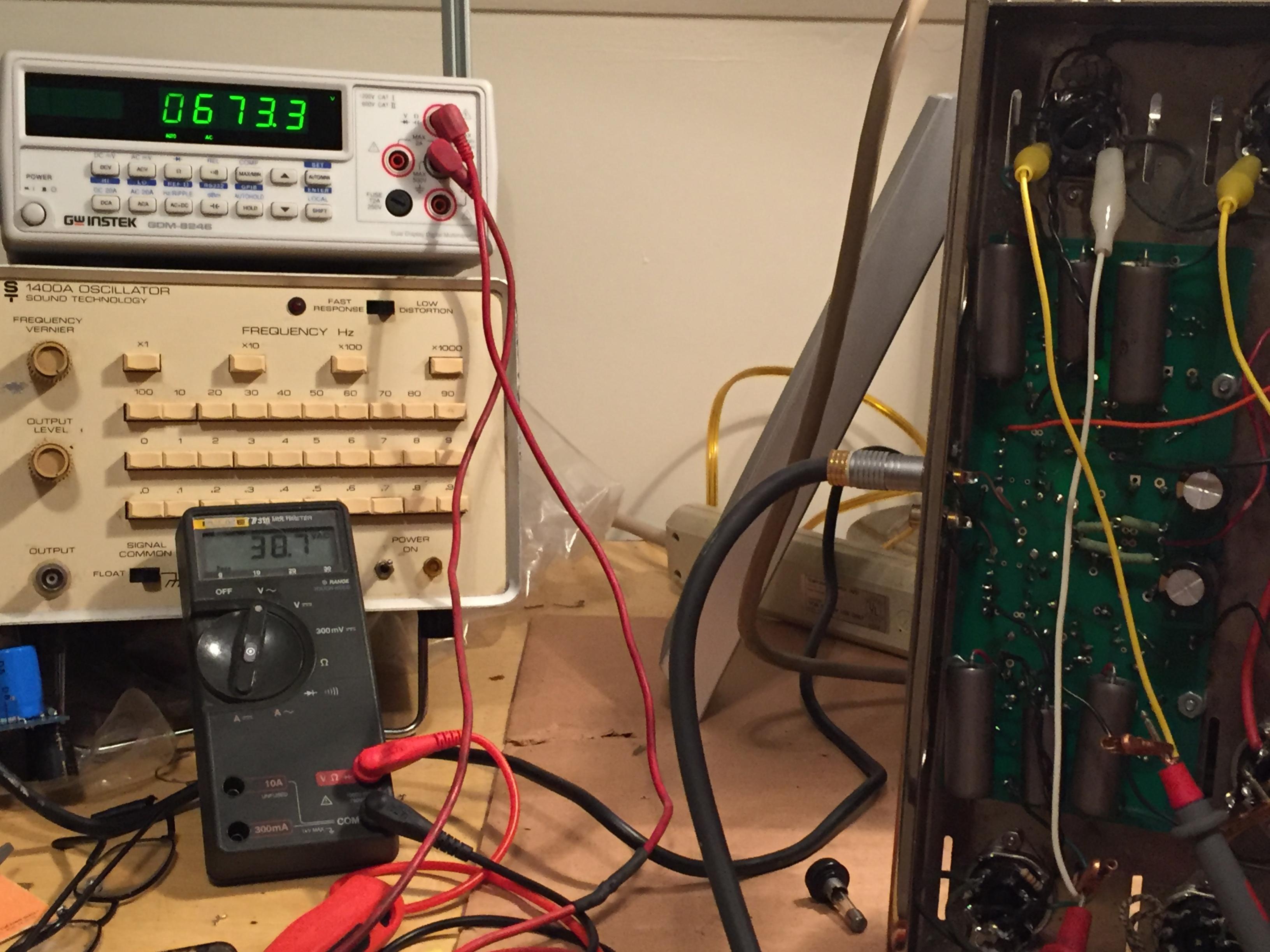

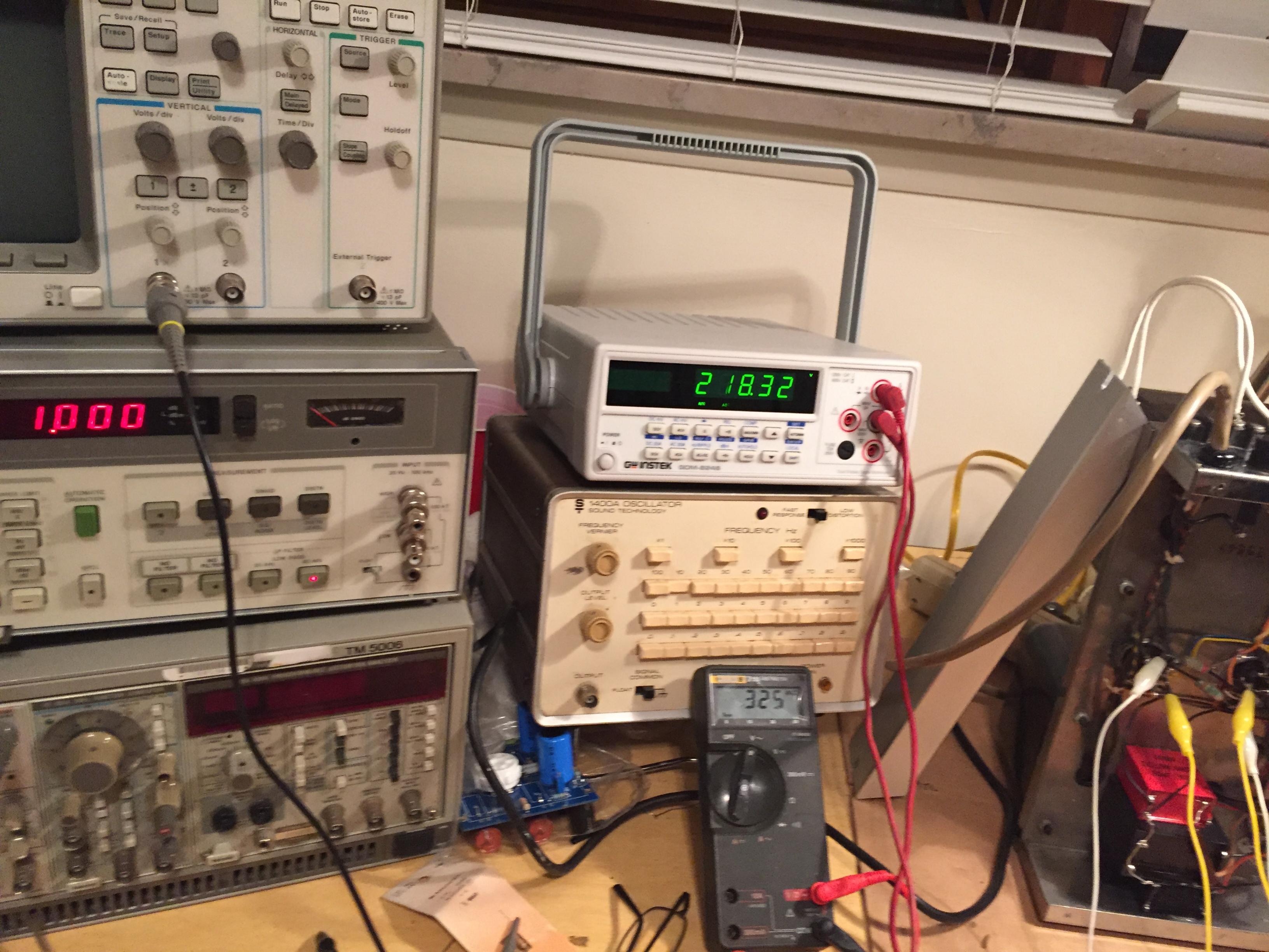

Ok I said I would do this test and I did..I talked to Doc Hoyer and he said you want to measure the total circuit of both output tubes because that's its function..The Fluke is measuring the RMS voltage in across both input grids and you can see that it is 325vRMS.There is 218.32vRMS across the plates which is being measured by the Instek and this is with a 1v signal coming in from the generator.In order for this output circuit to be a voltage amplifier,it would would have to increase the voltage at the plates vs the input grids as I will show you it does not increase.
On the Dynaco VTA70 we have 38.7vRMS going in across the grids and 673vRMS coming off at the plates with the same 1v input signal being used.In this circuit,it clearly does increase as a voltage amp should.
The last test I did was measure the output at the speaker terminals of the Mc30s without the 6L6gcs installed and it was 15.8v and when I put the output tubes back in,it went up to 18.3v but again,that is a marginal gain and it is due to the added current..All the tests were performed with the output tubes installed..I used 1v because I didn't need to drive the amp to full power for the test.

One thing however is clear: you have no clue of how these unity coupling designs work, and you apparently do wrong measurements.
Measuring voltages at tube terminals without installing them? 😀🙄
The MC275 output stage acts like a catodyne phase splitter with equal loads in the plate and cathode circuit.
Unloaded this would give a voltage gain of 2; loaded in the practical case of the amplifier the voltage gain is about 1.5 as I measured already a couple of years ago (MC275 with shorted output transformer as discussed earlier at this forum).

Actual Tube Voltage Gain = (Vplates + Vcathodes)/(Vgrids - Vcathodes) = (436.6/106.7) = 4.09
Apparent stage gain (relative to drive signals) = (Vplates + Vcathodes)/(Vgrids) = 1.34
You cannot use just the plate voltage, this is not a grounded cathode stage. Some confused gurus I think.

Please read a bit into this subject before blah-blahing the way you do now; there is enough to be found on the WWW. Try Pete Millets site for Alvin Lockhart's unity coupling design with a trifilar wound output transformer for a start because it is a simpler design wrt feedback and therefore easier to grasp, and googling the subject will give you the needed information.
As told before I had a MC275 here with a shorted output transformer; I completely dismantled this output transformer and know exactly how (badly) it was wound, the winding ratios etcetera.
Winding a new output transformer on a c-core (yes that was used by McIntosh in the good old days instead of the cheapo EI transformer which came with this "modern" MC275) gave rather better results.

First you should realize what McIntosh wanted to achieve with the MC275: to get as much low distortion power as possible out of a pair of KT88's.
One of the techniques they applied were split-loading the output tubes to lower their impedance; the low source impedance created this way is better able to drive a low primary impedance output transformer. I measured the p-p impedance to be some 2k.
By loosing voltage gain with split-loading more voltage had to be created in the input and driver stages.
Finally this high open loop gain was necessary to be able to apply overall negative feedback.
Applying these techniques they reached their goal: a high power tube amp with low distortion.
