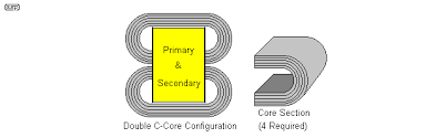

This is an Mc75 transformer and it looks like a double C core.. I have 6 mc60s and a pair of Mc240s and a single Mc275 but,I thought the Mc275 and the Mc75 had similar OPT no?

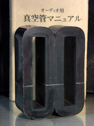

Thats a SINGLE C-CORE ...
Not a Double C-Core..
Ask next time you take photos from my website, that is the usual protocol...
The MC60 and MC75 are almost the same OT ... The MC60 OT is beefier while the MC75 is more prone is shorting....
The number of turns changed over several revisions...MC outputs were not anal about the number of turns since they had a ton of headroom already... When they updated the MC75's with better wire coatings, they couldn't fit as many turns... The general rule at MacIntosh was to max out the number of turns that could fit the core window...

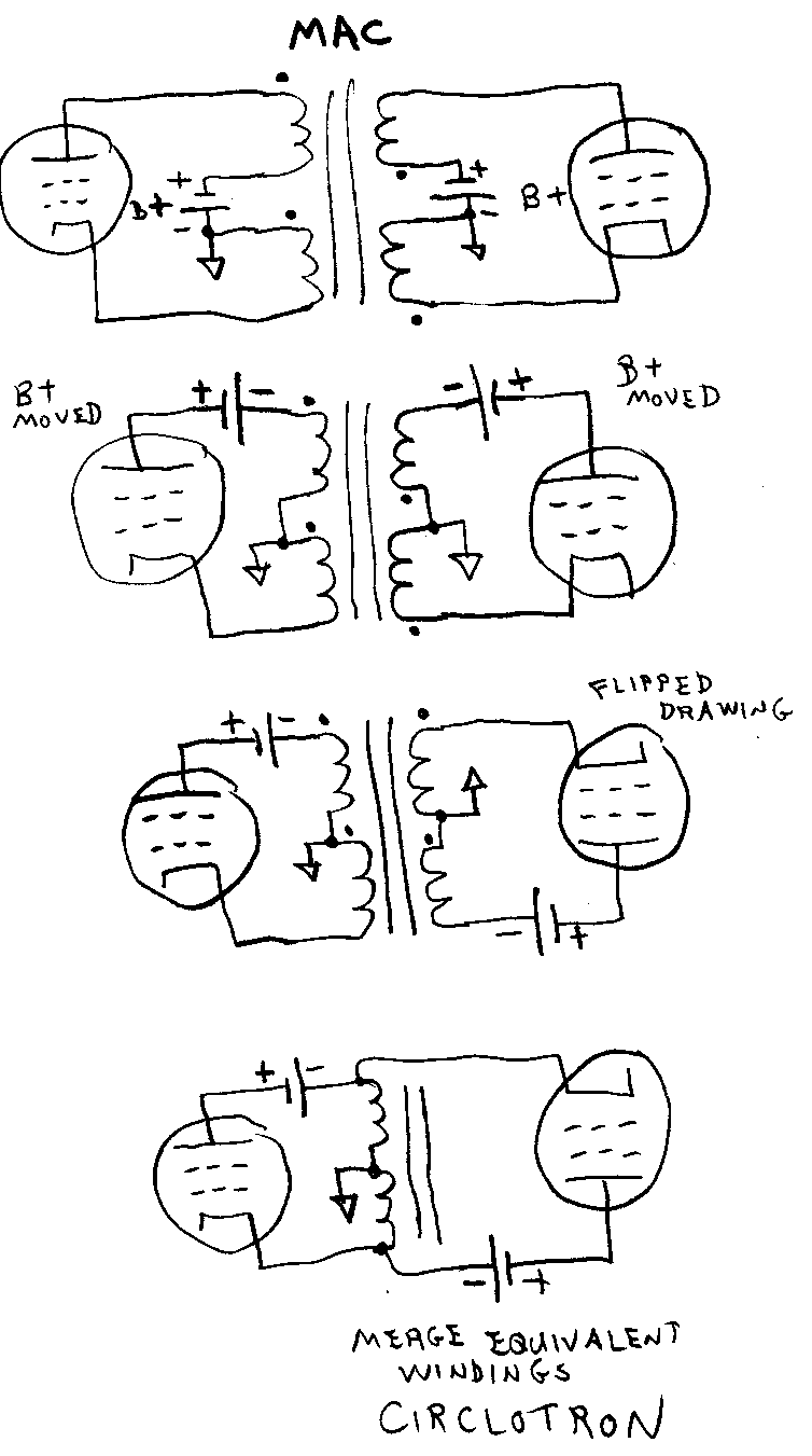

Equivalence of the Mac circuit to the Circlotron circuit:
The windings on the Mac that are bifilar and "unity coupled" are the SAME WIRE on the Circlotron. The Mac just uses two Circlotron windings on the same OT so that a single B+ source can be used.
This most likely leads (apples to apples) to a SQRT(2) performance increase over a conventional P-P CT'd OT for the Mac, and a 2x performance increase over a conventional OT for the Circlotron. (the Mac has 2x the wires taking up space on the bobbin) [this is comparing the OTs ONLY, however; common mode capacitance in the Circlotron floating power supplies can re-equalize the performance if not kept to a minimum with split power xfmr bobbins]
