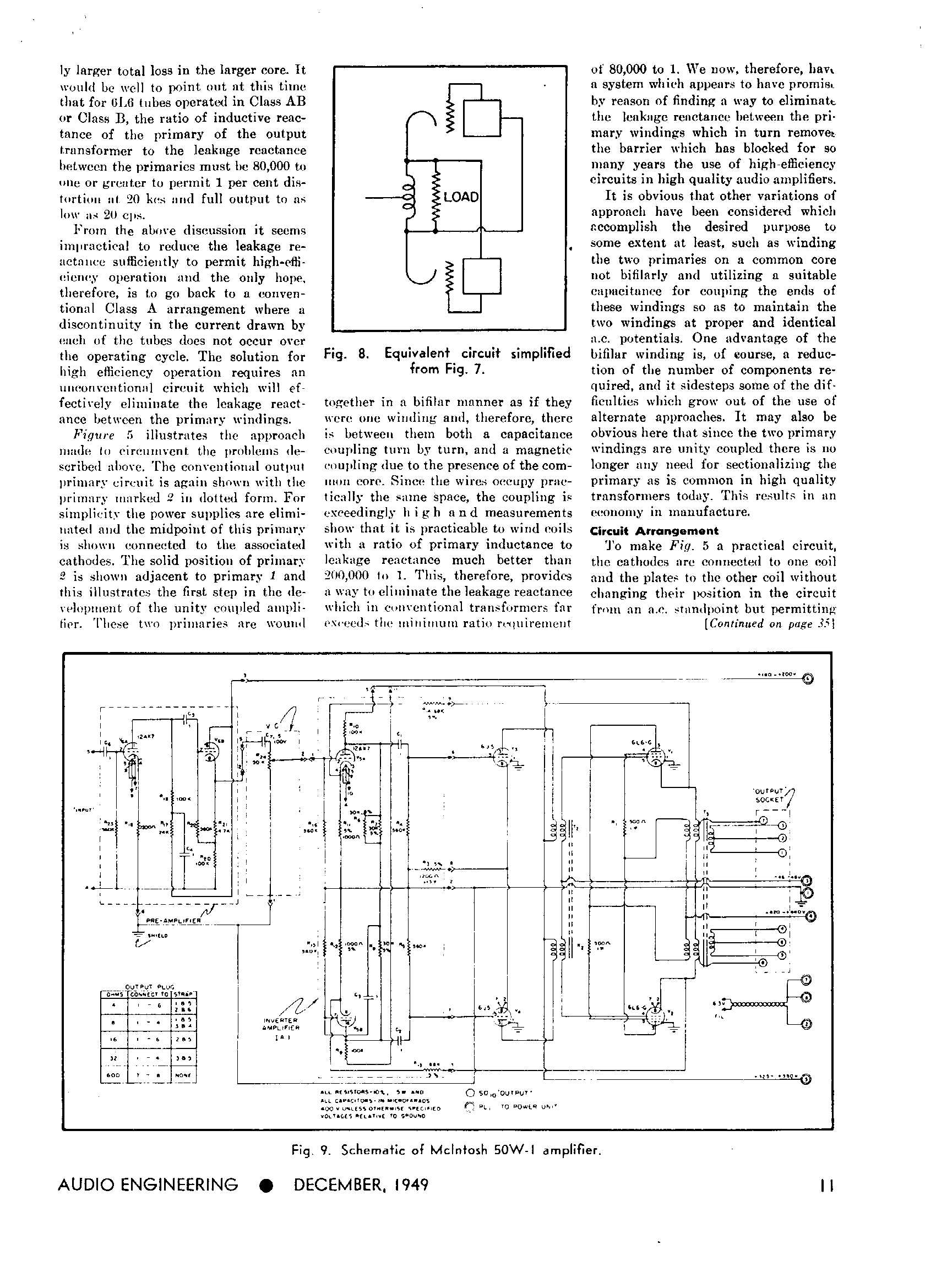

Here's the original Frank McIntosh and Gordon Gow paper; turns out it wasn't in an Audio Anthology after all.
Thanks Chris; I provided the link for that article in post #25 😀
