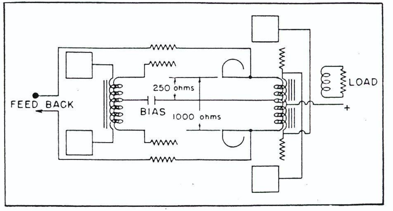

"Figure 7 also shows that some direct -coupled negative voltage feedback is used . It will be seen that since half of the load is in the cathode and half of the load is in the plate, as before mentioned , almost the entire gain in this final stage is lost by virtue of the feedback resulting from this method of loading. Additional feedback is achieved by connecting suitable resistors between the cathodes of the output tubes and the cathodes of the phase inverter stage."

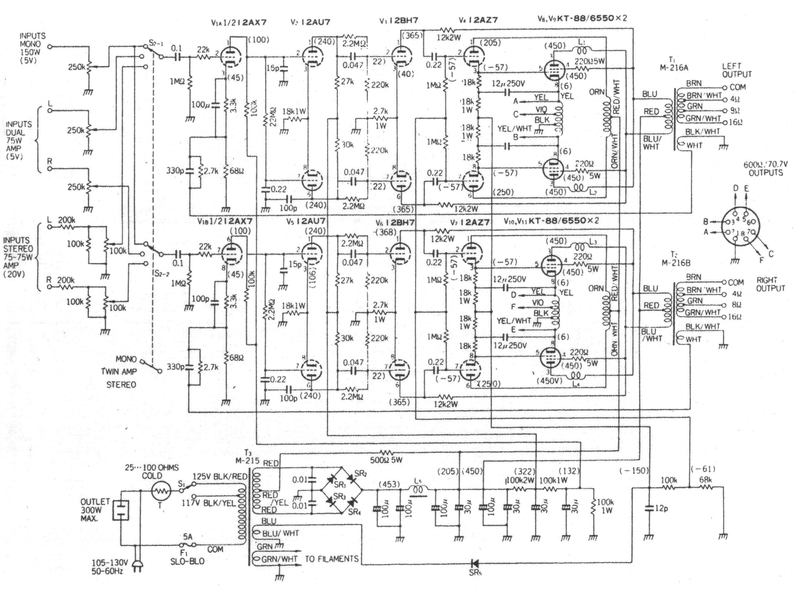

OK let's try another approach, based on RMS voltages as specified by McIntosh.
The MC275 is specified to deliver 75W into 4, 9 and 16 ohms.
Let's take the 9 ohm tap; so 26VRMS must be delivered into that load for 75W.
In a former post I gave the voltage and resistance chart which comes along with the MC275 manual. The AC Volts values at rated output is important.
For rated output power the AC voltage at both KT88 grids is specified to be 149V.
Correct me if I am wrong, but I think this is peak voltage, and the RMS voltage is (2x149/2.83) = 105VRMS.
So at rated output power each KT88 has 105VRMS at it's grid, the total for both tubes (differential) being 210VRMS. Right? If not please correct!
So for 26VRMS at the output of the amplifier we need 210VRMS at the power tubes grids.
The step down in voltage from 210 to 26 is a function of tubes gain and output transformer step down ratio.
The output transformer has two identical (and bifilar wound) primaries for the plate and cathode circuit, both with an 8 : 1 step down ratio wrt the 9 ohm tap. In the article(s) it is clearly stated that the secondary sees these primaries as a single one, with this 8 : 1 ratio.
The RMS voltage swing at the primaries of the transformer therefore must be 26 x 8 = 208VRMS; let's say some 220VRMS because of losses in the transformer.
So, 210VRMS at the grids and 220VRMS at the primaries would give us a voltage gain of the tubes of about 1.
Instead of coming up with out of context quotes from the articles I would appreciate if someone would take the effort to check my calculation so we might come to some sort of conclusion.
See the MC275 schematic for additional information.
I don't think we need a different approach, especially when the straightforward approach is so simple.
A class B UC amp has one tube working into two quarters of the primary in series for ~half of the AC cycle.
Similarly, a class B push-pull CF amp has one tube working into two quarters of the primary in series for ~half of the AC cycle.
The CF amp will take twice the input voltage to produce the same AC swing on the two quarter-primary segments.
Do you agree or disagree?

Interesting to compare is this design by Lockhart back in 1956 and based on the Frank McIntosh unity coupled design (1948):http://www.tubebooks.org/books/lockhart.pdf
Please note the composite load for the output stage is 6k for a pair of 6L6's, and that is nowhere near the 2k3 of the MC275.
