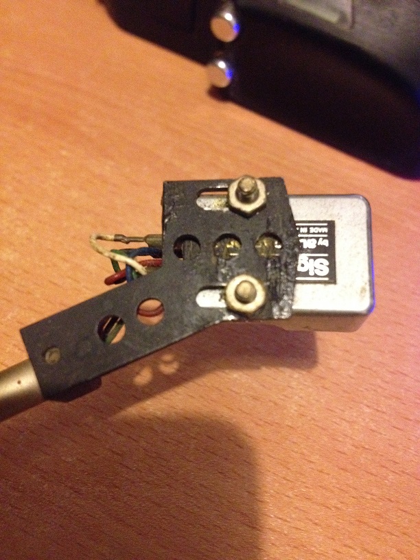

I have started to renovate carefully this Mayware, I have one broken Item which is the arm rest are there any retro fit rests that will work on the 8mm Dia tone arm. The uni-pivot grease was pretty non exsistant and had gone very gluey so I have removed this and will buy some new grease. I have found a manual on Vinyl engine, although I cannot seem to find the tone arm installation template as the one of Vinyl engine is not to scale, how are you guys finding the correct locations on the tonearm boards to install, any dimensions or diagrams would be helpful.

I checked my stash and all i have is a headshell finger lift.

Hi Dave will the headshell finger lift fit the Mayware because I am short of one of those see the attached picture. Many thanks

Yes, The one i have is from a Formula 4, a bit of shaped aluminum that fits under (looks tidier) or over (works better) the headshell and is clamped to it with the cartridge fixing bolts. Send me an email and you can have it for the cost of the post ($11 USD to the UK).
