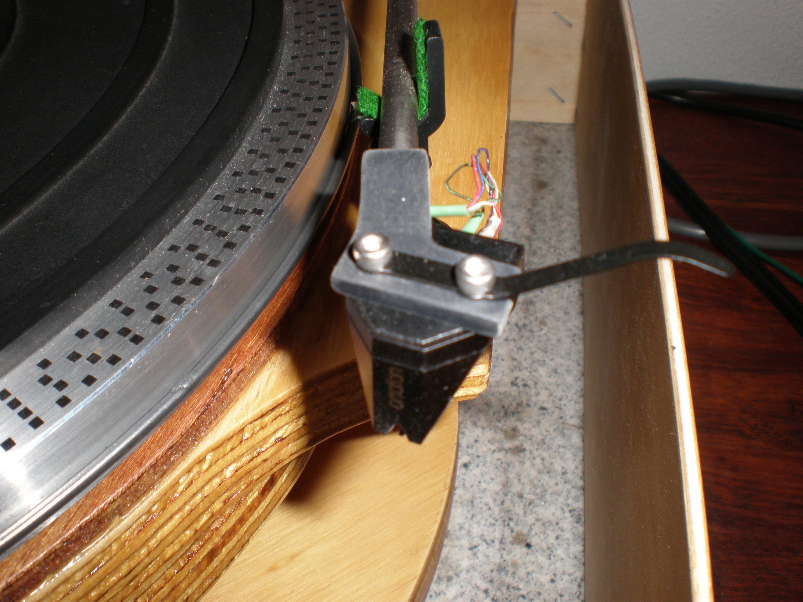

I’ve had an Mayware tonearm on a Technics SL-150 mk1 for a few weeks now.
It came with a dire Grado F1+. Not worn under the microscope but dull dull dull.
I use an AT VM740ML cartridge that can track anything. It sails through torture end-of-side tracks with ease. A few LPs I thought were knackered sound great again.
I can’t say whether it’s the stylus profile or the tonearm. Maybe both?
That same cartridge was equally successfully used on a Thorens TP16 mk2 before that—now it has an AT 150sa, not as good in my opinion.
I use a 600,000 cts silicon grease for damping.
unipivot
The wand is titanium which meant a heavier counterweight.

I believed the arm wand is aluminium, not titanium. Is that a special version? Also my bias weight looks different.
To get the azumith sort of right, I used a small bubble level.
You are correct, the original wands are aluminium. This modified one is titanium. I had to go up a size in diameter because the hole the wand slips into was ovoided, which then meant I had to turn another counterweight. I made another base plate, headshell, bucket and pulley also. The only thing difficult to make would be the stork that holds the jewel. You would then need a jeweler 🙂

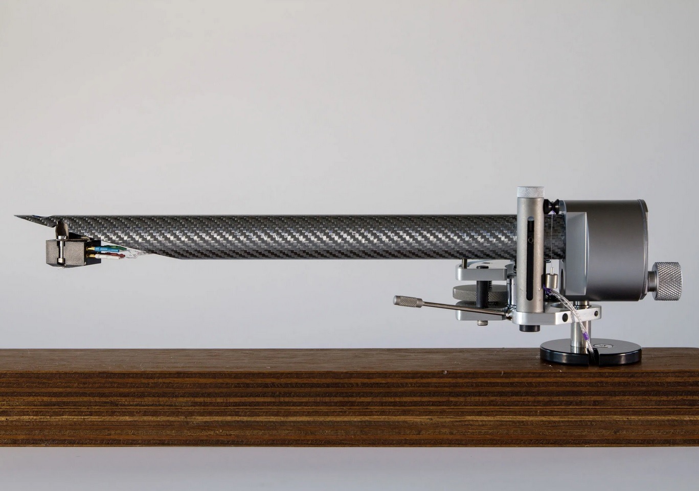

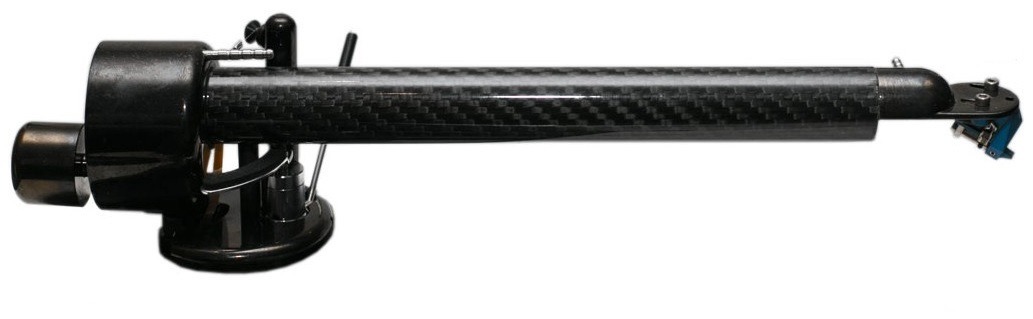

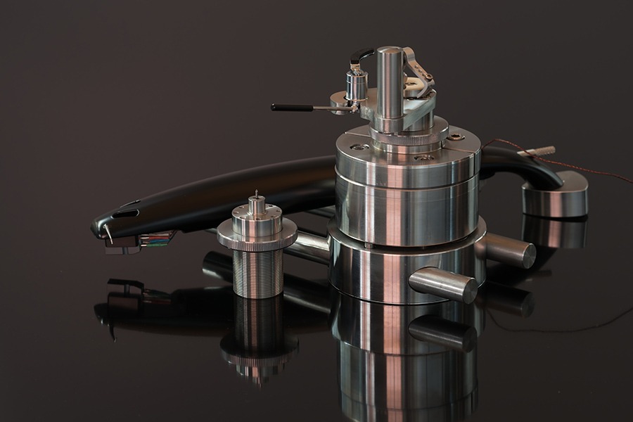

I agree with alot of what you say as, it appears, does Continuum looking at its Viper tonearm, also The Wand tonearm and The Pug tonearm, but for the moment I think I will stick to my much thinner Form IV arm, perhaps with a stiffer and heavier titanium armtube.
