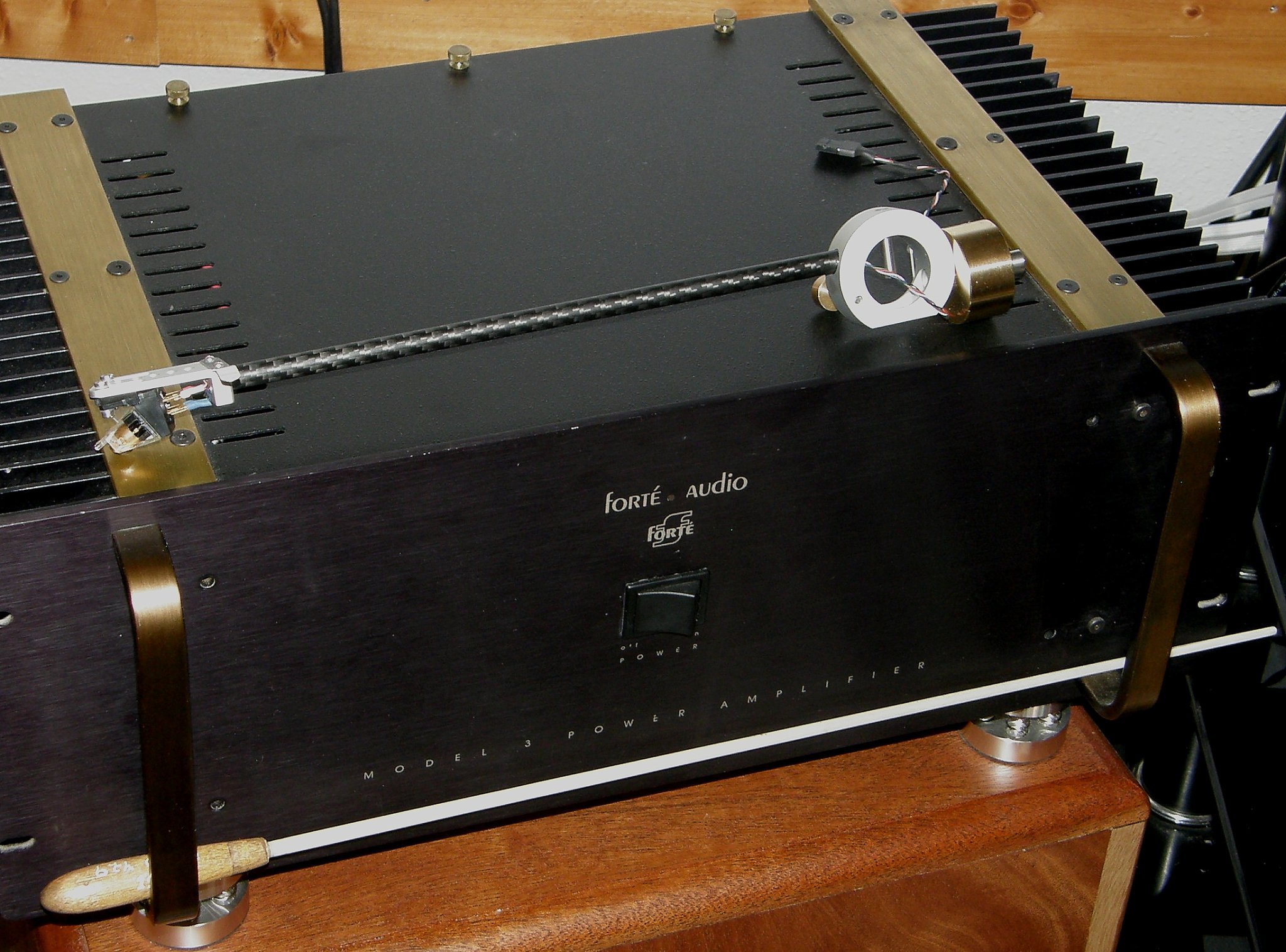

I had not realised it was possible to make an arm that satisfies technical requirements yet looks ugly. That Viper arm has been hit very hard with the ugly stick, but I'm prepared to bet it sounds good. I have done a similar thing to the Pug with that extended plate; not a good idea because it flexes and it's difficult to obtain a rigid low mass bond to the tube. Carbon fibre might look nice, but unless you use it imaginatively (Viper) it's little better than aluminium.

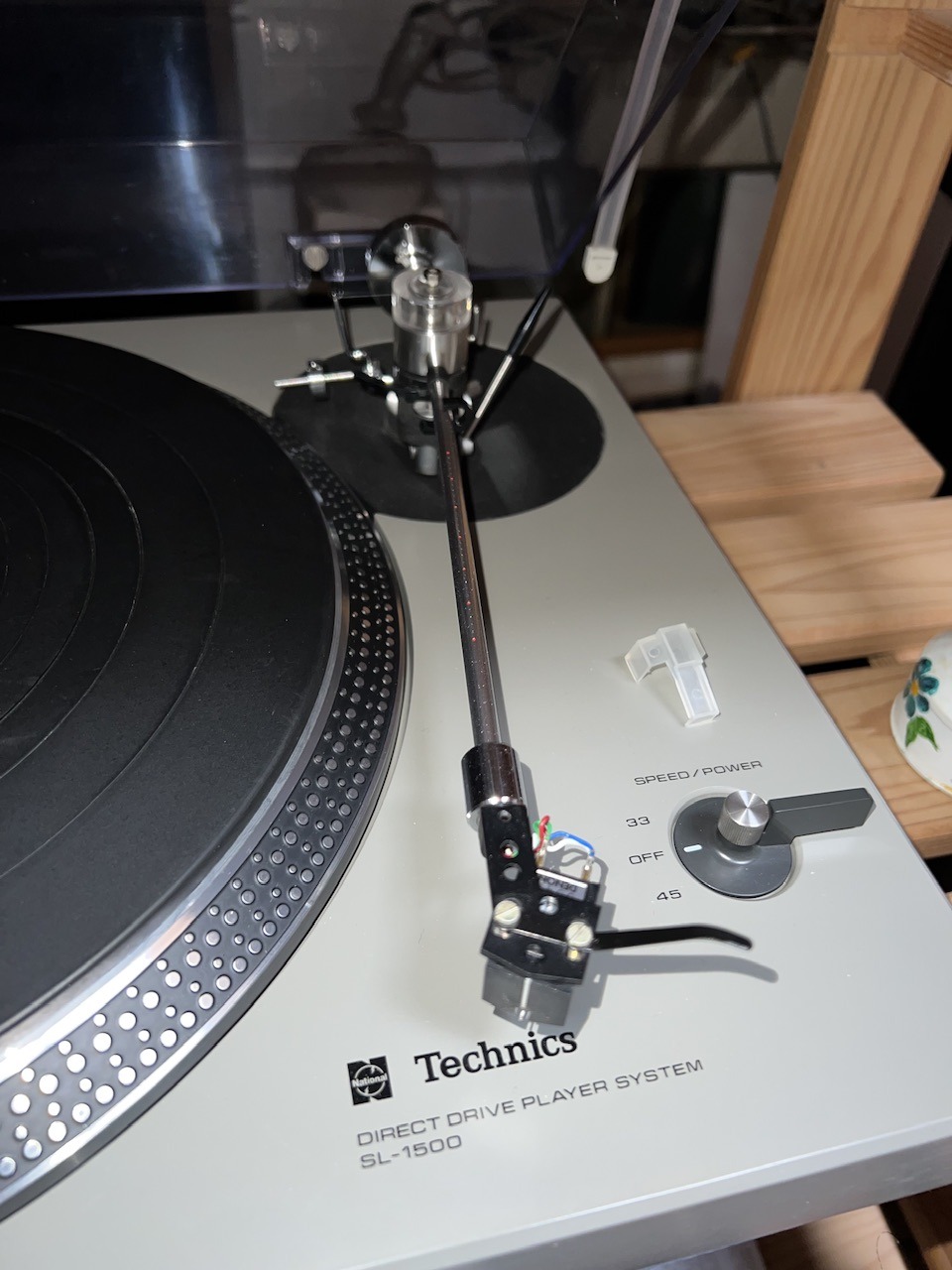

The DL103 (I know it shouldn’t work, right?) rides about anything, even end of sides. The arm is absolutely stable and bass quality is superb, against all odds – everybody told me it wouldn’t work, but it does.
No Lenco here I’m afraid, but I use 600,000 cSt on a Technics deck.
thanks for your experience, how much did you put in half a cup?No Lenco here I’m afraid, but I use 600,000 cSt on a Technics deck.
many use it on that arm, with weight forward it goes 12/13 grams of mass, the counterweight is generous, the arm is well built, the non-noble name affects. Then the resonance is an indication factor in truth the 103 also works well the mission 774 LC, medium mass. There are so many factors that affect the tonearm cartridge marriage, resonance is an indication not to blunder.The DL103 (I know it shouldn’t work, right?
Well I didn’t fill the cup, I’d say just enough. Start with a very little quantity and observe how the arm behaves. Not sure there is a rule here.
Indeed the sliding weight is right up the head shell. I also added an arm lift for convenience.
