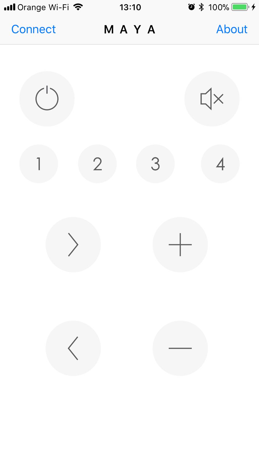

Firmware ver14 add option to turn off display after 10s, screen saver for OLED.
We had same function implemented on LCD, now is on OLED as well.
We have removed a small bug that activate relays two times instead only once, generating clicks and plops on high volume.
Now MAYA is prepared to work with a bluetooth low energy module (BLE) for Apple's iPhone.
That's all for the time been and ver15 coming soon. 🙂
Tibi
