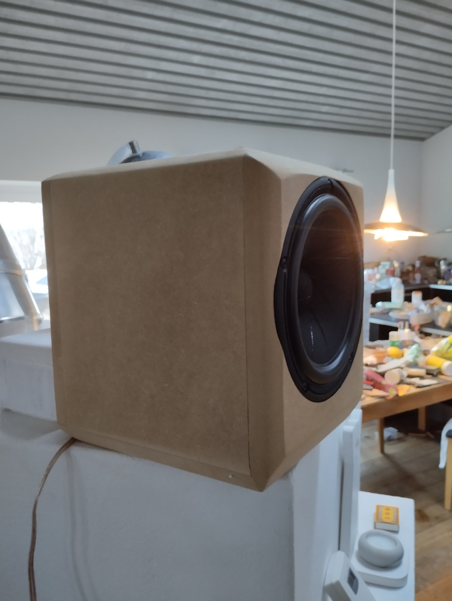

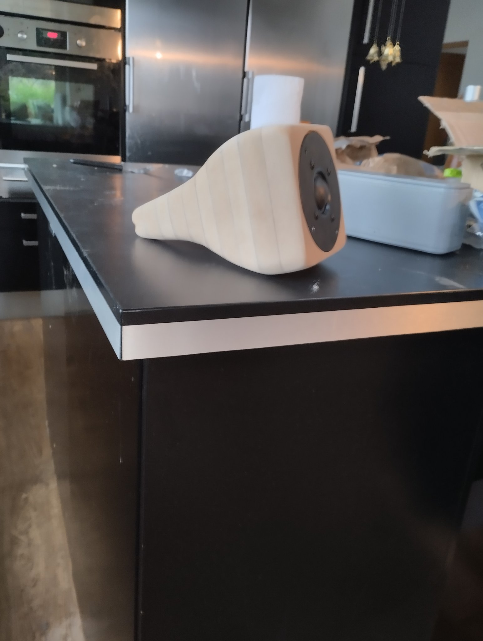

So I've made a few cabinets......And I'm always overcomplicating things, when all I should be doing is a quick simple box.

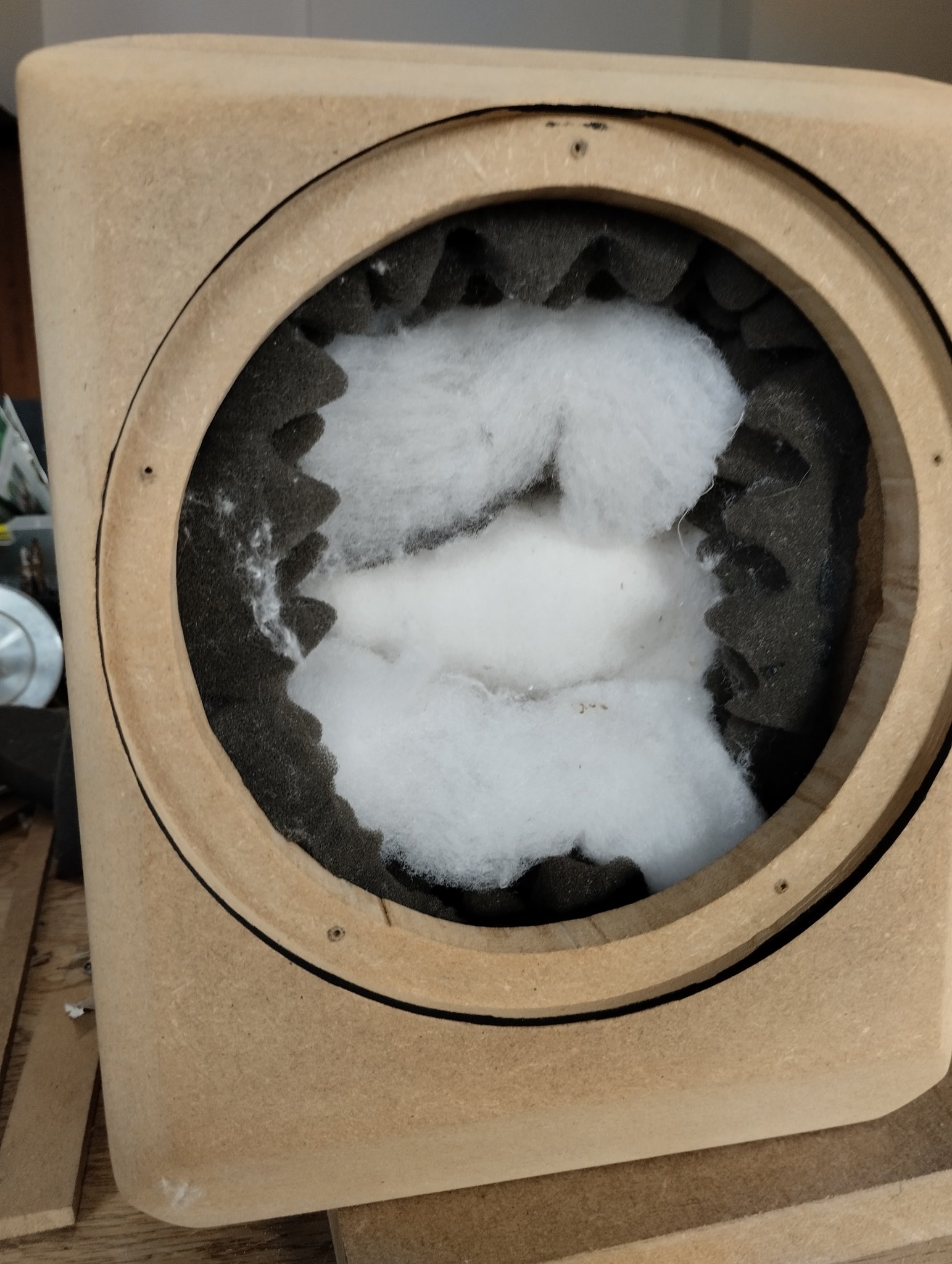

SS M18 mid box is now 6.2 liters net with quite a lot of filling. ( can fill it up with MDF to best volyme)

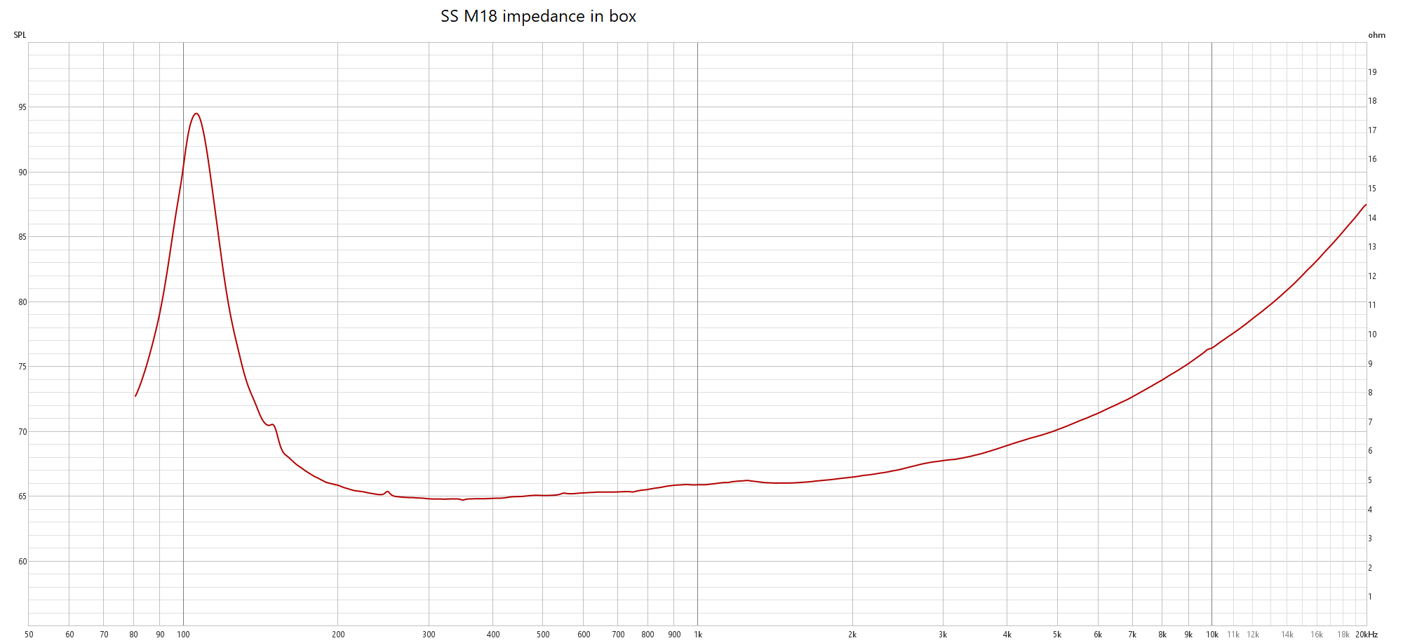

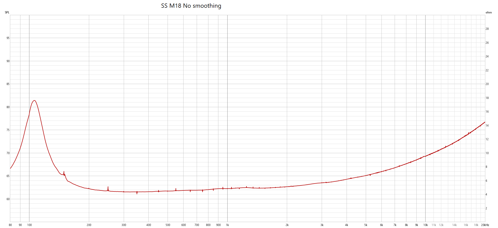

Did the first measurements and Impedace shows FS at 106 Hz? (brand new driver)
You skilled people, what does this look like?
Regards John

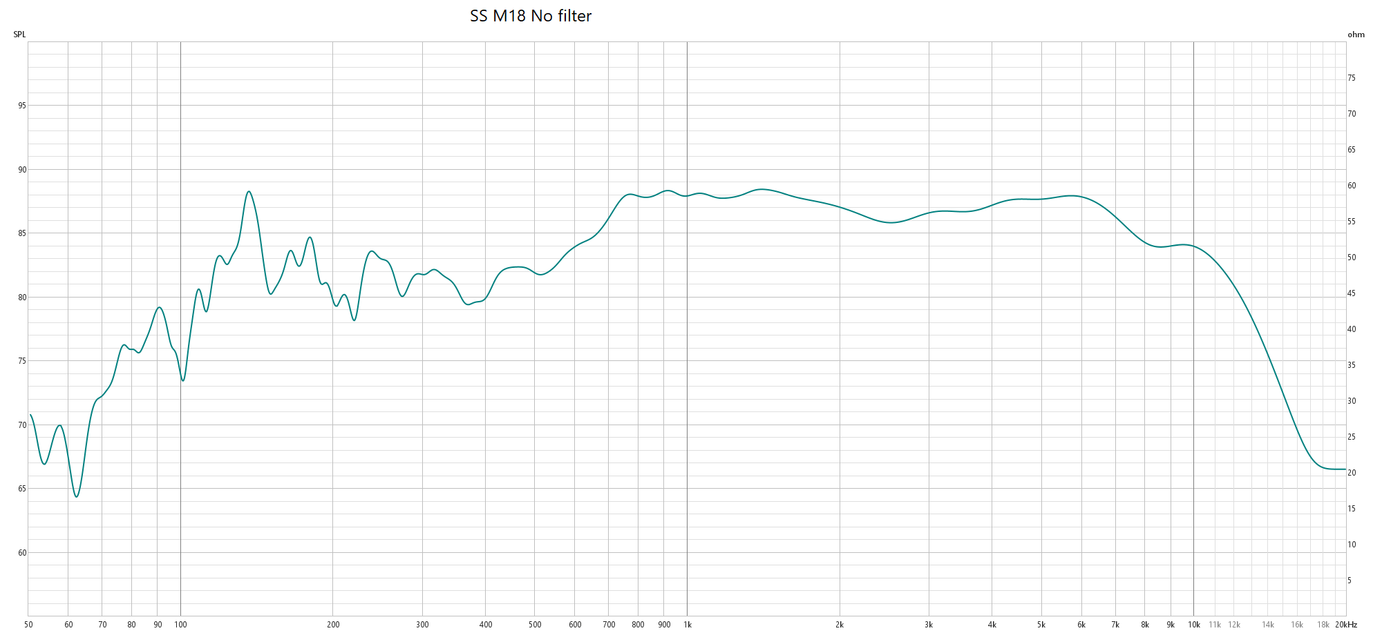

Hi Jawen,
I see a Low frequency roll off around 120Hz due to box size and stuffing. A little blip in impedance around 160 and 250Hz. Maybe more stuffing would take care of them?

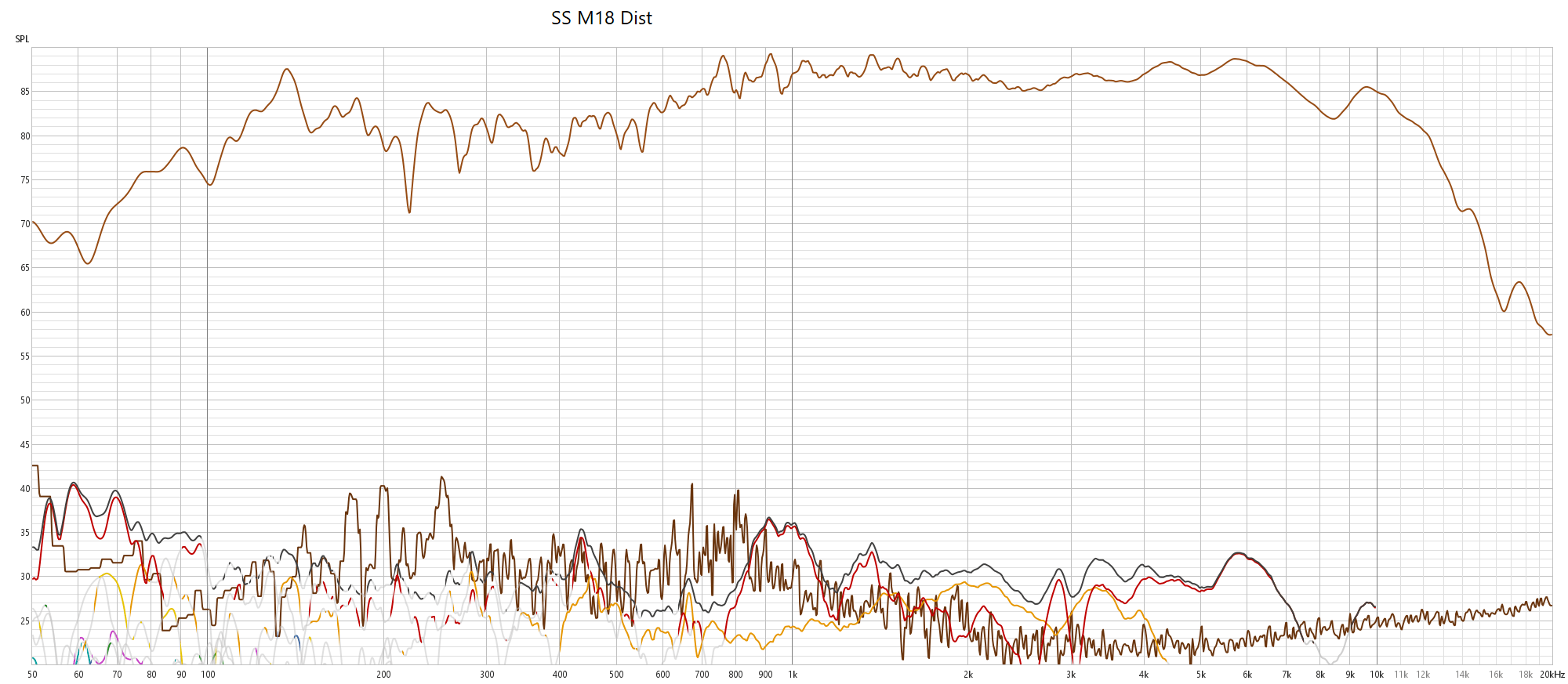

Diffraction loss of approx. 6dB spread over 400-900 Hz.
Consequently if you intended to use it from 400Hz you will have to deal with that which suggest to me that your your efficiency if you adjust for the loss will be around 82-83dB for the test input level you used.

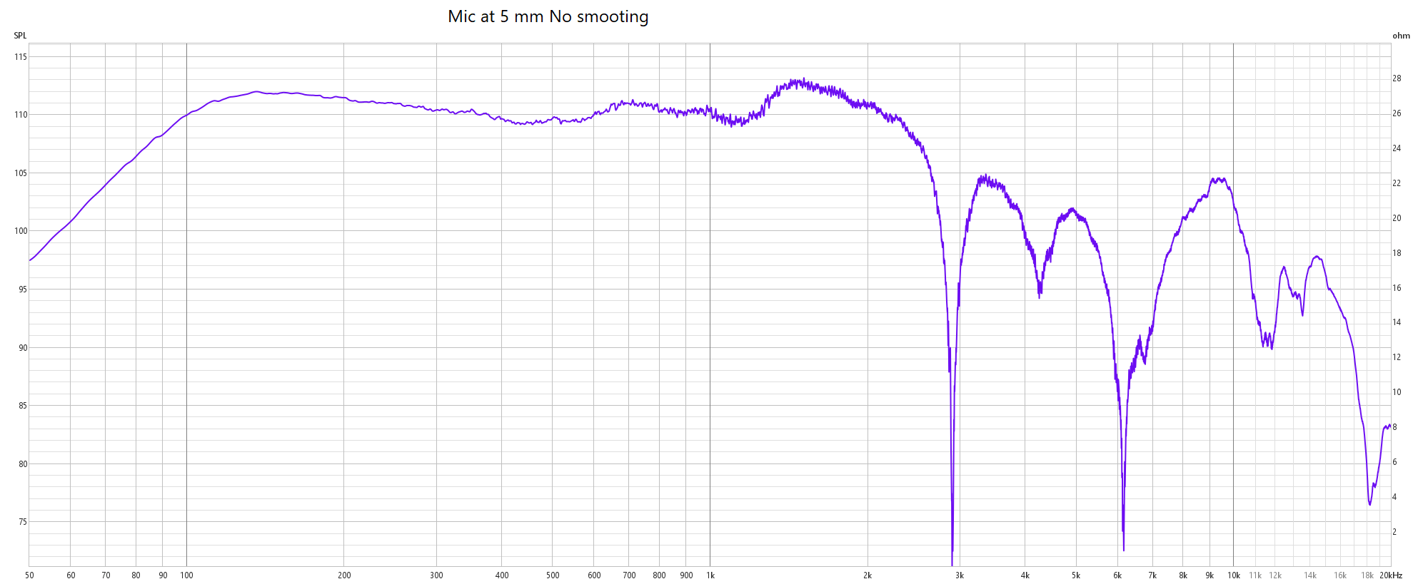

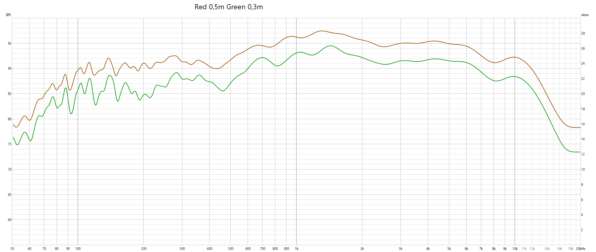

The frequency response has a lot of room influence. Try a nearfield measurement and gated 0,5m distance measurement.So I've made a few cabinets......And I'm always overcomplicating things, when all I should be doing is a quick simple box.

But the problem is the impedance measurement! There should not be dips at 150 and 250Hz! Is this really from the speaker or some humm/whatever?
I didn't pick up on the brand new driver aspect.
Maybe gently running them in for a few more hours at 80dB may loosen off the suspension and get rid of the blips you may find the Fs drops a few more Hz as well.

Yes diffraction loss is much, and mesaurement make me wonder !
I had the speaker at 1,6 m hight when i did mesaurement, and mic 1 m
I was going to use it from 150 hz 🤔

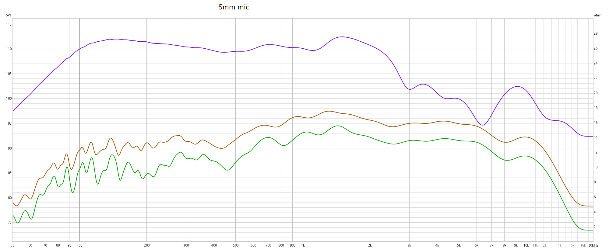

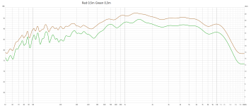

This is from 0,5 and 0,3 meters.Try a nearfield measurement
Speaker at a chair 50 cm over the floor and mic also

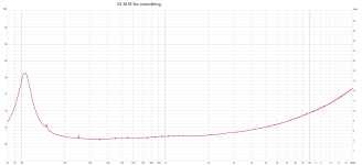

These impedance blips are not connected with cabinet internal dimensions.
This is without 1/48 smooting
Having problems with REW settings to mesaure impedance, never remember the settings between times Grrrrrr
Dont get it to work now when i try to do a new impedance mesaure
Harmonics of 50Hz mains break through via computer or computer PSU?
Although PSU switching frequency should be 100s of Khz?
Blue is mic at 5 mmHe meant near field like 5 mm.

Is there a way to test that?Harmonics of 50Hz mains break through via computer or computer PSU?
PC on only batteripower?
This looks like 50Hz hum and harmonics. Ground loop or interference - you need a tidier setup to get rid of these.This is without 1/48 smooting

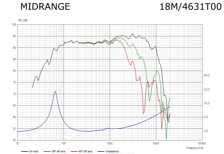

Do you also find the 900Hz peak of the datasheet?
The rest looks good.
