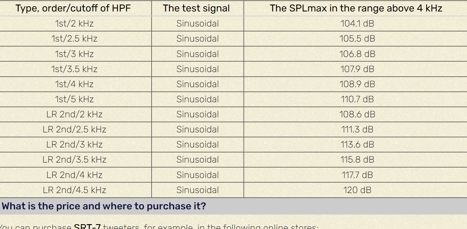

The Viawave don´t take lots of power if i don´t cross it high enough, but think the SS 93000 can go much lower.

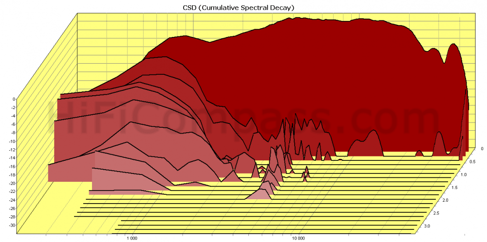

Here some data and pic´s ( also xover examples from HifiCompass for the SRT 7)

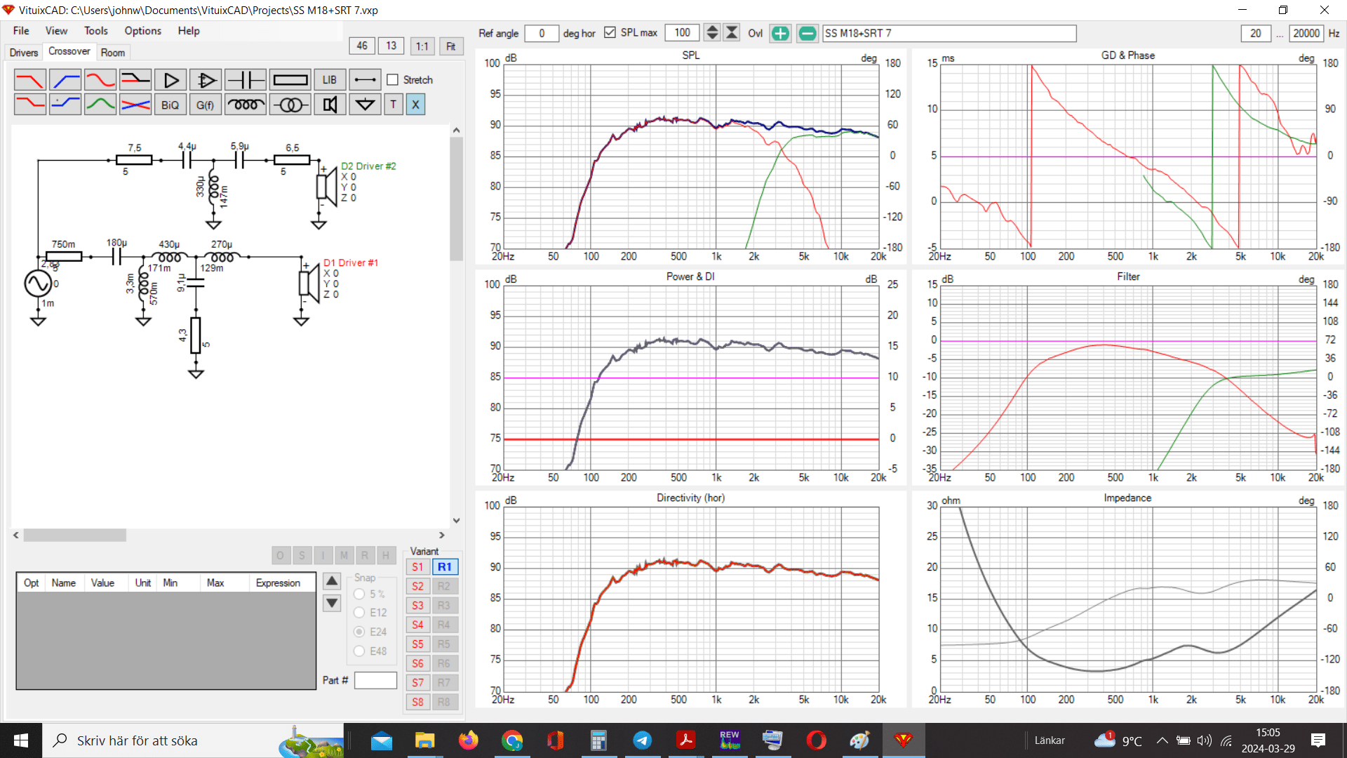

Playing a little with SS M18 and the Viawave.

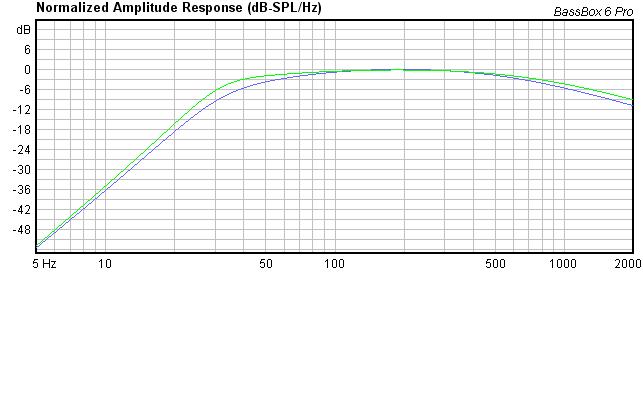

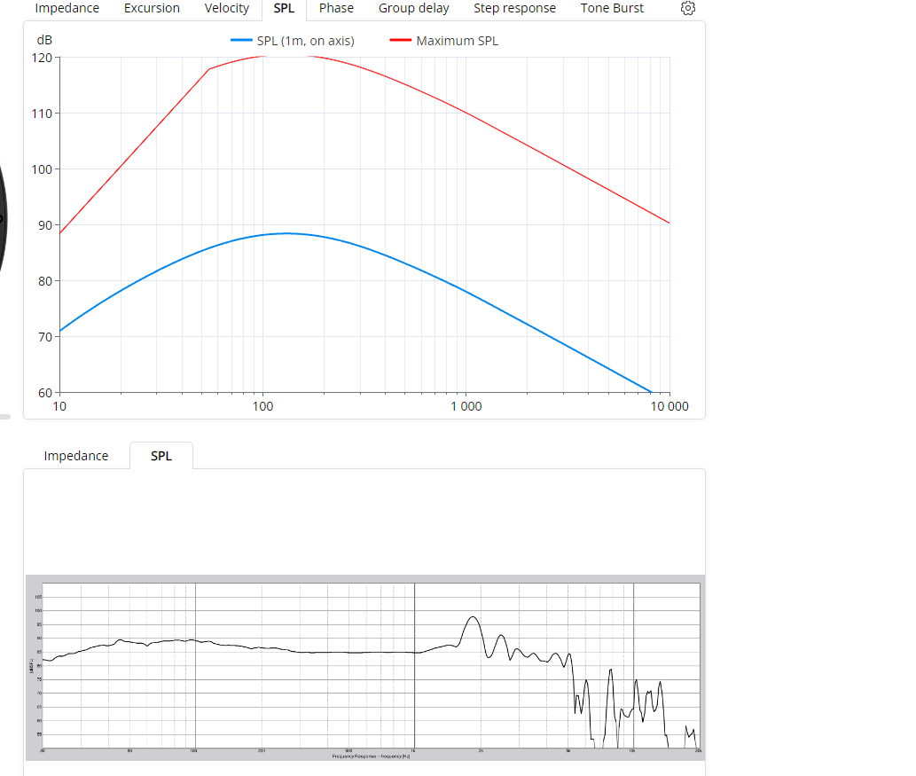

How loud can your 15" go with your amping, did you simulate?
I have a Cramco Vortex 6 amp ( 2x3kW at 4 ohm) and my Onkyo 747 receiver ( 2x 90 W 8 ohm)Depends on the cross over frequency to your bass driver. Ideally the lf driver takes over when sensitivity goes down caused by baffle step.

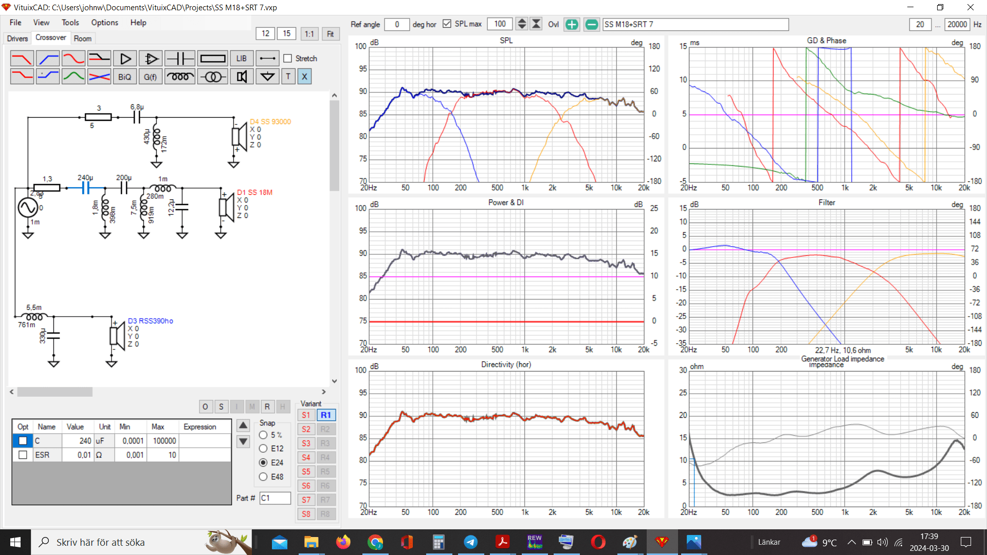

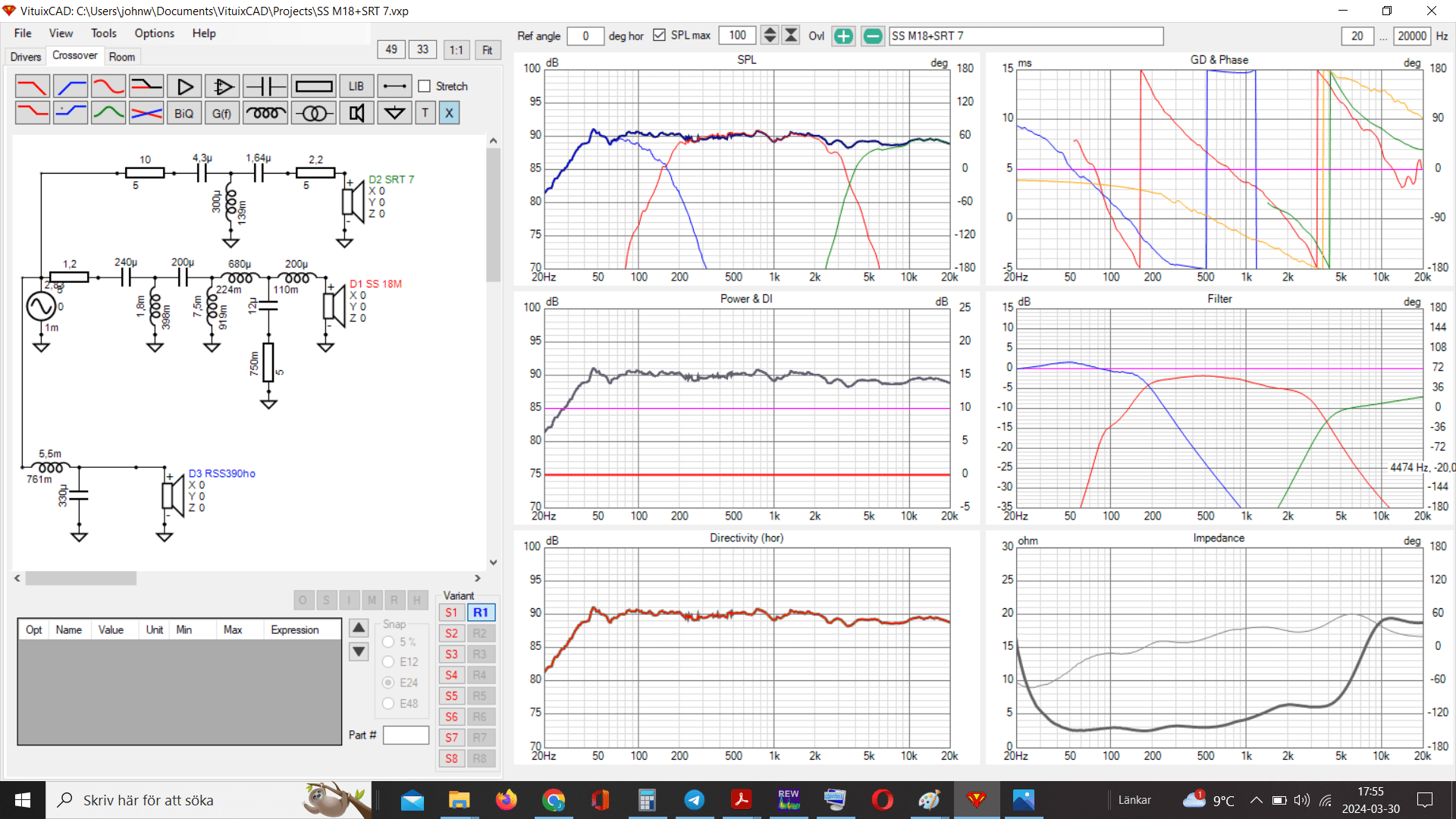

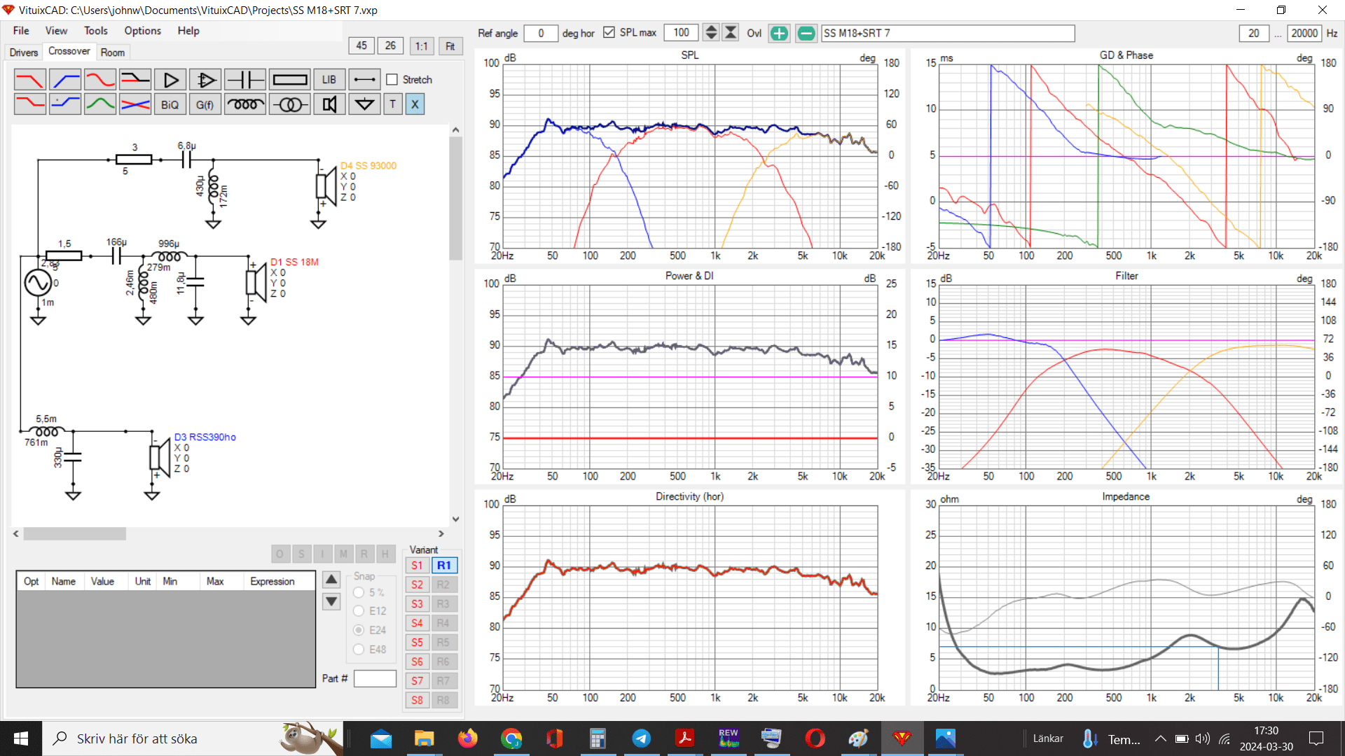

Like to cross the sidemounted woofer, so i don´t suffer from "directsound/pointsource" problem, so my tought was 150 hz.
Here is SPL for the Dayton from loudspeakerdatabase.com and specs for Cramco amp
Simulate some more in Vituixcad alsp with woofer and both with Viawave tweeter and SS 9300, LR2 and LR4
