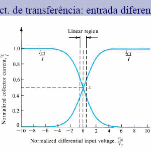

But what do they neglect? They neglect common-mode effects. This was first brought up by Pete B (PB2) in the Gilbert ("What's your reasoning...") thread several years ago. At first I ignored this, but then became more curious about it. The logical extension of Gilbert's analysis is to take an input stage consisting of typical bipolar transistor models, follow it with an ideal integrator and output stage (as Gilbert did), and look at the distortion of that.
What happens is that distortion due to common-mode effects of the input stage is an order of magnitude, at minimum, higher than that due to difference-mode effects for an amp with sufficient emitter degeneration in the front end (or FETs). The solution is to bootstrap the input stage as Scott did with the AD797. This distortion consists of two components - Early Effect and nonlinear Ccb/Cgd. Of these, the Ccb/Cgd term dominates. This is a pure PIM effect not considered in Gilbert's analysis, and is at least an order of magnitude higher than the difference-mode effect Gilbert considers.
The bottom line is that if you don't bootstrap the input stage, the whole TIM/PIM discussion becomes a complete joke because other sources of input stage distortion are dominating.

I would like to point out a few facts that many may not realize. I hope it clarifies, rather than confuses the situation further.
Both Matti's amp and my JC-3, designed within a year or so of the AES paper, have 20KHz open loop bandwidth, with about 20dB of negative feedback. More feedback would be OK, IF the 20KHz open loop response is maintained.
Both amps also use a SUMMING INPUT in order to reduce common mode distortion. Please note this.
We came to understand, early, that common mode distortion compromised typical amp designs.
Practical considerations, later forced us to make non-inverting amps and this was made tolerable by cascoding the input stages, or equivalent techniques.
