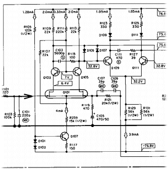

By tinitus - Wasnt he the man saying "no one needs more than 60watt"
He would not of liked what the japanese did with his design. +-75V rails, -250 watts (same topology). Pioneer 1985 (attached)
...they did add a cascoded Jfet differential (2SK129A -typical).
OS
regards
This was not 'the mother of all amps'. This was Matti's 'reference design' to illustrate design principles to have a TIM-less amp. What's the problem scaling it to 250W? Or getting the same result with another circuit?
