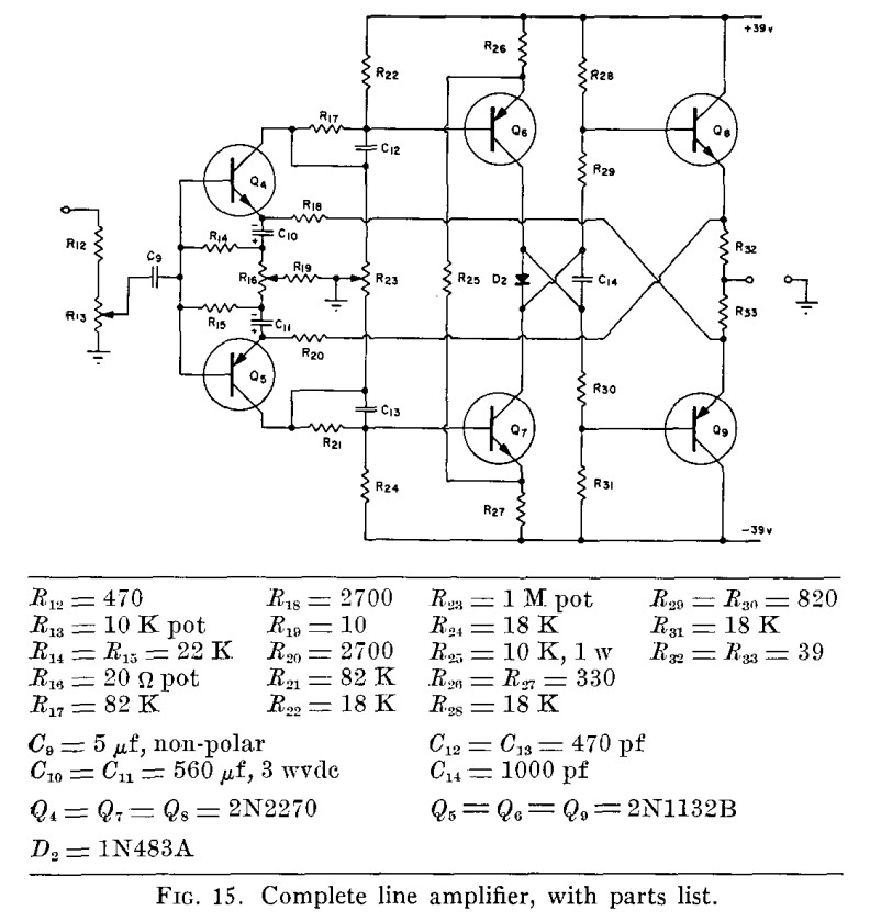

From an historic perspective, the rather unknown fact that two transistors NPN-PNP push-pull input stages were already known in 1965 shoud be mentionned :I wrote about this here for those that are interested
Feedback: A Short History
James J. Davidson JAES "Low noise transistorized tape playback amplifier" January 1965 volume 13, Number 1.

Yes, small tranies. Here is the Davidson's circuit of 1965.@forr, you mean small signal tranies? .
