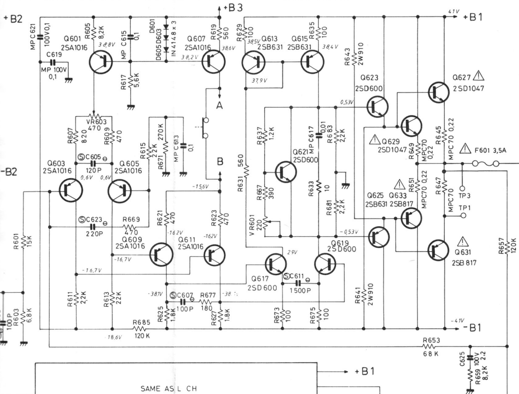

if anyone interested to try Matti Otala amplifier, it is easy to do so by buying used Rotel RA-820bx3 / RA-820bx4 / RA-840bx3 / RA-840bx4.
Where 820bx3/4 is without tone controls and 840bx3/4 is with tone controls.
Check it out Rotel circuit attached.

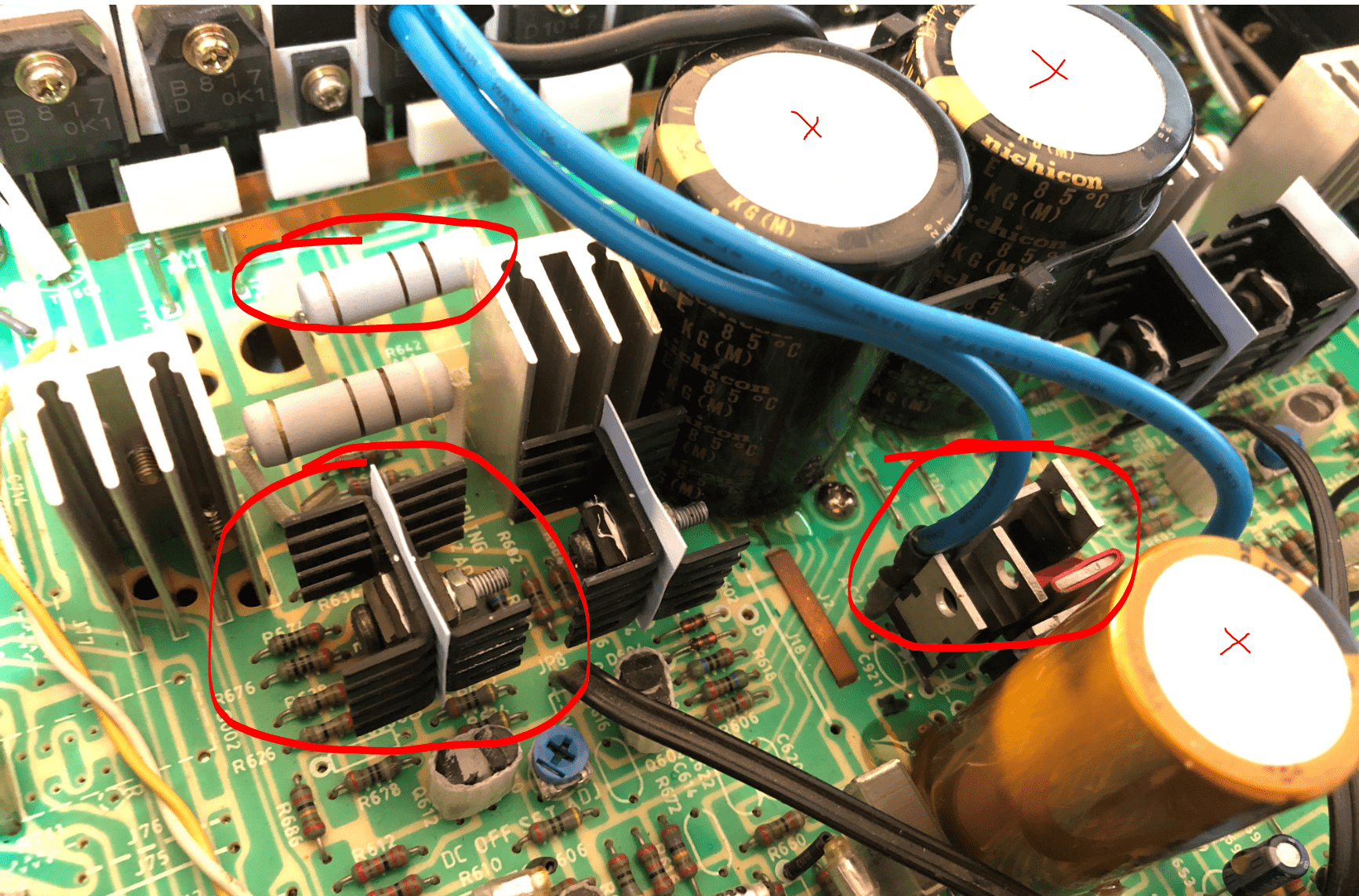

I managed to squeeze 80-90W at 6 ohms from RA820BX4... I replaced a few components. The original design was quite bad... the PCB tracks were burning; the PCB was turning into charcoal. I circled in red the components that I changed... I also installed the heatsinks where (they were really) needed.
The sound of these Rotels was always too rough, too clinical. I managed to smooth that out a fair bit... and then gave the amp to my kids to enjoy.
I did a lot of work on the PCB underside as well...
