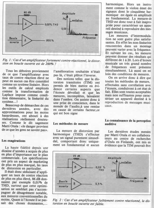

found by chance : Meeting with Matti Otala (magazine "l' Audiophile")
Who can convert the file format from attached jpg-files by OCR software to transfer the text in a translation resp. language tool (e. g. in "Google) ?

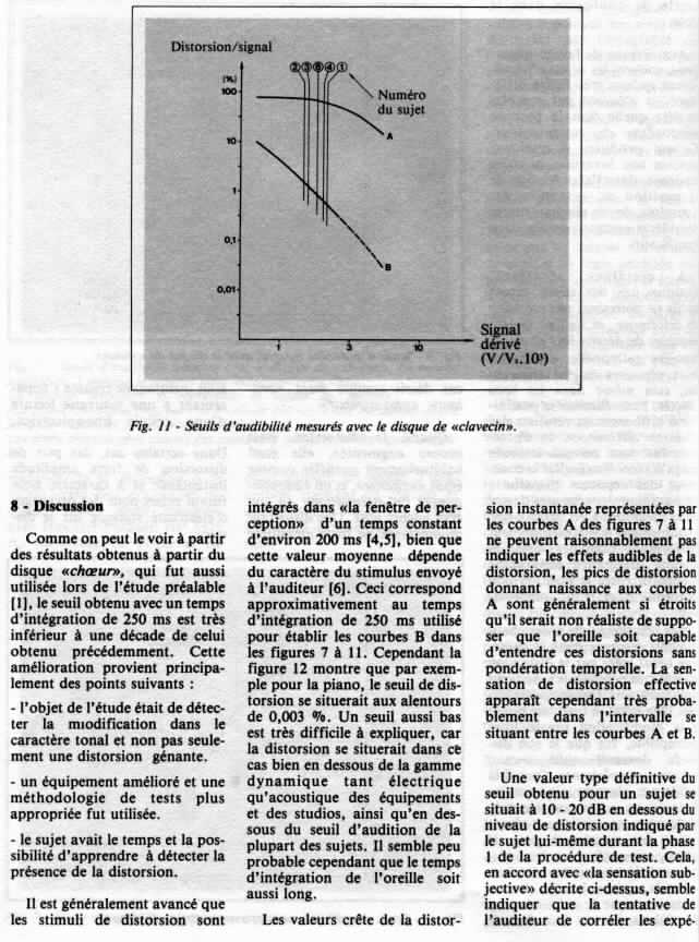

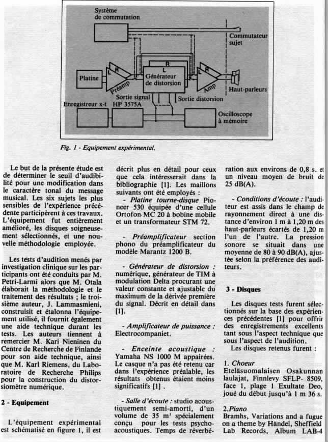

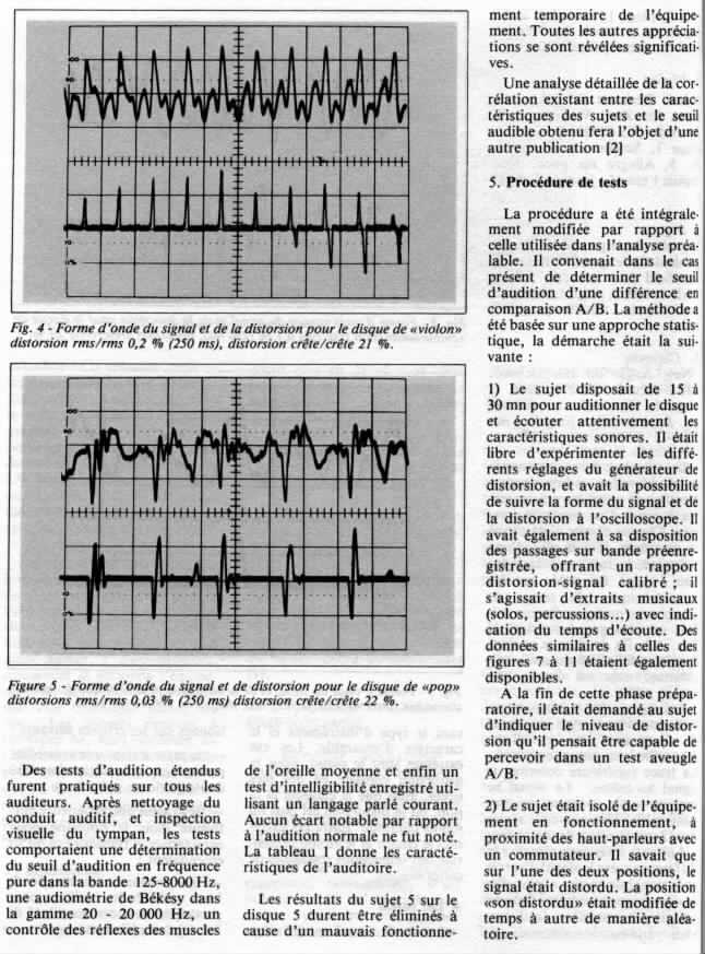

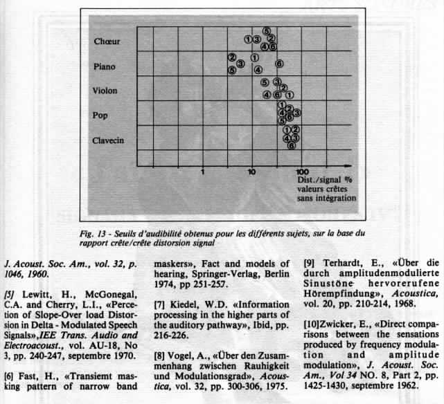

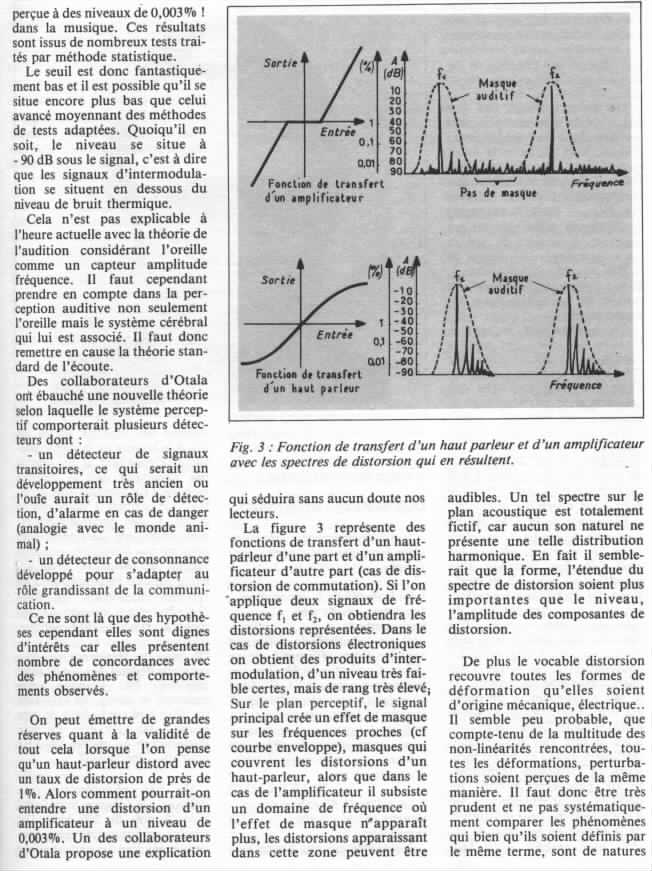

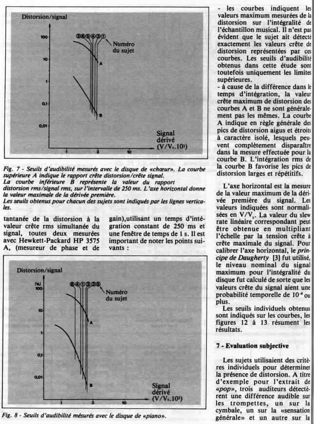

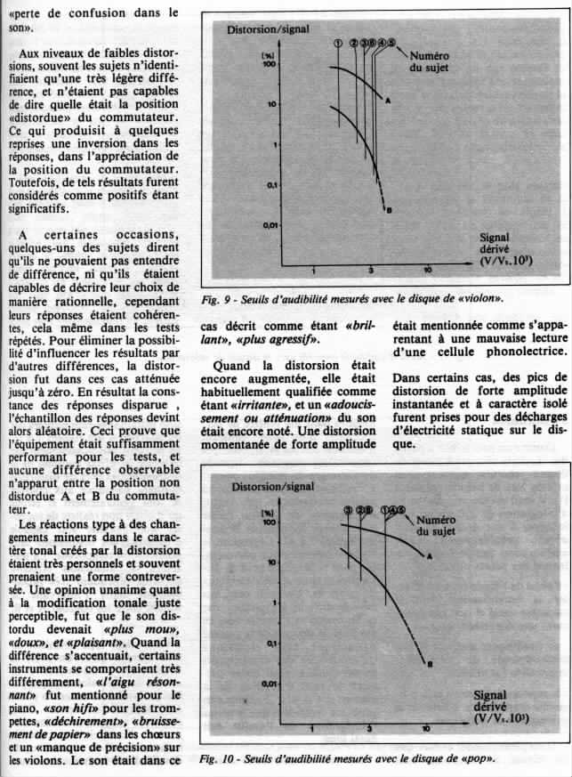

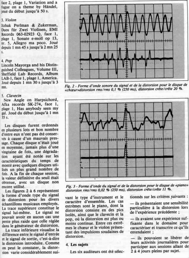

...and an interesting article concerning "Audibility of Transient Distortion" also from this magazine (maybe it is possible to convert from jpg in doc for the aim of comfortable translation in Google's language tool).
