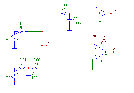

Fine, but the problem has often been addressed to uA741 like parts. That's probably not the case, and even much faster parts, generally used in audio and assessed as sufficient by many, are apparently not good enough for the purpose.
syn08 said:
How was the crossover distortion simulated using such a model is one of those deep mysteries
* NE5534 OPERATIONAL AMPLIFIER "MACROMODEL" SUBCIRCUIT
Tired, tired. Are we back to talking about how "we" proved in 1970 that 741's and 709's are not good for audio? Is this still important to talk about? And who did invent macromodels?
Surely not, but 5532, TL071 and devices slightly faster are considered good for audio by many and are used in most professional equipment in tens per unit.

syn08 said:
It would be also interesting to find out what NE5532 model was used in that simulation. The only NE5532/NE5534 spice model I have ever seen is coming from TI and is one of those stupid behavioural macromodels, completely improper for any THD, TIM, DIM and any other three letter acronym simulations. In fact, the model is only a degenerated diff pair with resistive loads, everything else are synthetic voltage controlled voltage/current sources feeding the output and the common mode, and a 50ohm resistor to simulate the OL output impedance.
Wow!! Did I ever make a mistake! I was not paying enough attention. When I wrote my post I was assuming that the pics were of a measurement, not of a simulation.
For something like this, I would be reluctant to put a lot of faith in the simulation.
Bob
