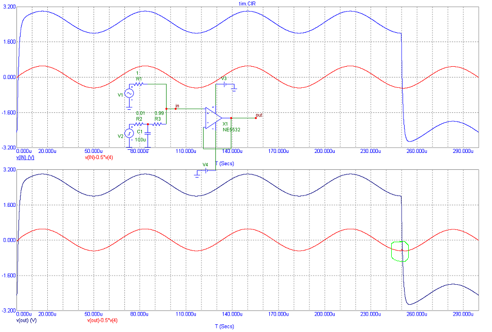

PMA said:Obviously, the TIM is still an issue :
Hi PMA,
Neat picture. Looks like some crossover distortion on that 5532 op amp.
What value of DIM does it measure by Otala's method using a spectrum analyzer?
Similarly, what value of THD-20 does it measure when looking at harmonics out to 200 kHz?
Thanks,
Bob

Bob Cordell said:Neat picture. Looks like some crossover distortion on that 5532 op amp.
It would be also interesting to find out what NE5532 model was used in that simulation. The only NE5532/NE5534 spice model I have ever seen is coming from TI and is one of those stupid behavioural macromodels, completely improper for any THD, TIM, DIM and any other three letter acronym simulations. In fact, the model is only a degenerated diff pair with resistive loads, everything else are synthetic voltage controlled voltage/current sources feeding the output and the common mode, and a 50ohm resistor to simulate the OL output impedance.
How was the crossover distortion simulated using such a model is one of those deep mysteries

jcx said:
SACD requires a high order analog filter at 50KHz
Yes it does. But it is not any brickwall. Usually 3rd order. If you measured analog output of SACD players, you would find waves up to 100kHz with quite high amplitude, that's the nature of the DSD noise.
Regarding my 5532 tim image, someone might like kindly check the method, if it corresponds to that used by Otala and Curl. I mean a possible mix of linear and non-linear distortion (input BW limited square is subtracted from the wave that passed thru the opamp....)
PMA said:Regarding my 5532 tim image, someone might like kindly check the method, if it corresponds to that used by Otala and Curl. I mean a possible mix of linear and non-linear distortion (input BW limited square is subtracted from the wave that passed thru the opamp....)
Someone did and is telling me that the author simulated the response of a degenerated (329ohm) long tail pair (133uA ideal current source), modeled with Spice default npn devices, with resistive loads (723.3ohm), output loaded with a 7.7pF cap.
What has this to do with the real NE5532 opamp, crossover distortions, etc... only the author knows. In someone's else opinion, the author just delivered an example of the limited slew rate impact, available since the 60's in any analog design textbook. Which is exactly what Bob and others told here and elsewhere ad nauseam: this kind of effects have nothing to do with negative feedback and open loop bandwidth.
