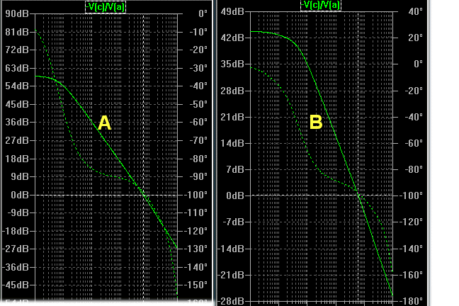

What an interesting thread !
I have a similar setup as the otala (as far as trimmable control over loop gain) with a much lower current voltage amp (3.5ma).
What I have found objectively is no change in overall slew or phase margin at UG. What does change is the phase in the audio band and the OLG (naturally), as well as the sonic character of the amp. (attached pix). I do not have to A/B the changes in loop gain (can adjust OLG AS I listen in real time). Going from 40db to 70+db can be heard easily. I always wondered what the 68k/220pf VAS shunts were in the symasym and how they affect the overall sonics of the amp. I haven't as yet experimented with the caps except in simulation but just the basic "crippling" is an eye opener.
"A" in pix is where I am subjectively evaluating now ,"B" is the maximum "cripple" I have attempted.
OS
by andy C. - Indeed! And slew rate has nothing to do with open-loop bandwidth, only the input stage bias current and compensation capacitor. It's possible to make radical changes in open-loop bandwidth without changing the slew rate at all, by crippling the VAS with a resistive load.
OS
OS

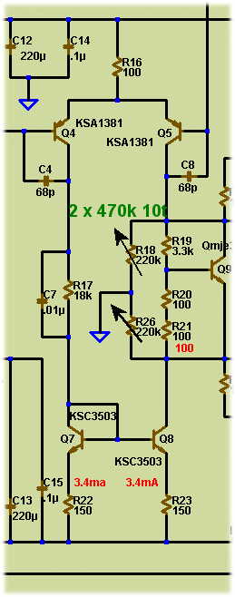

Hi OS
How do you do this in real time?
Trimpot?
Cheers
by stinius - How do you do this in real time? Trimpot?
2 - 470k 10- turn trimmers.
circuit pix attached.
Best soundstage , least (no )long term listening fatigue at 220k (60db).
OS

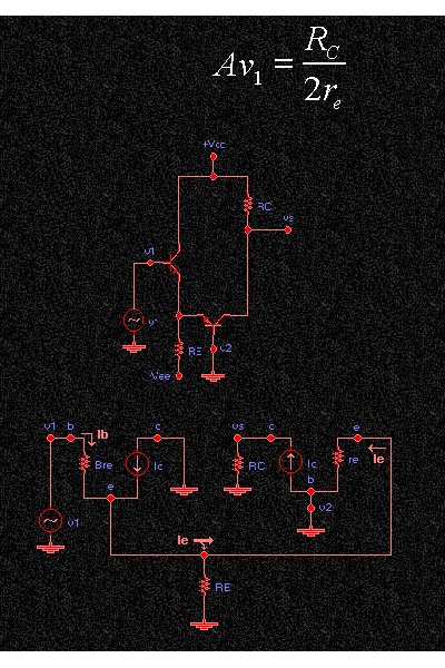

Hi Bob
In my project amp (What is simple), I have a TDH in open-loop of ~0,6%-20KHz and ~0,1%-1KHZ with 50Wrms, and Slew Rate de 90 V/us.
-obviously with the negative feedback reduces the distortion....
I would like to know if with this distortion in open loop, if I would low distortion TIM, AIM and PIM?
In your project "Mosfet Error Correction" by my calculation, you have 0,1%-20Khz in open-loop which is very good...
I would like to know your opinion
Even if you do not use negative feedback, is recommend you use differential pair, it has less distortion (Attached) Attachment: diff.pdf

Wavebourn said:
Do you have something similar, but about cascodes? 😎
The circuit that I was referring to the previous post, would be to use only one common-emitter, that saturates easily, it starts sending strong second-harmonic distortion, is used in valve amplifiers that do not use negative feedback.
You are correct, with a cascode increases the region of amplification, but remember! using a differential pair without negative feedback, You will have a cascode configuration (Attached).
Thank you! I've asked for Dimitry. 😉
